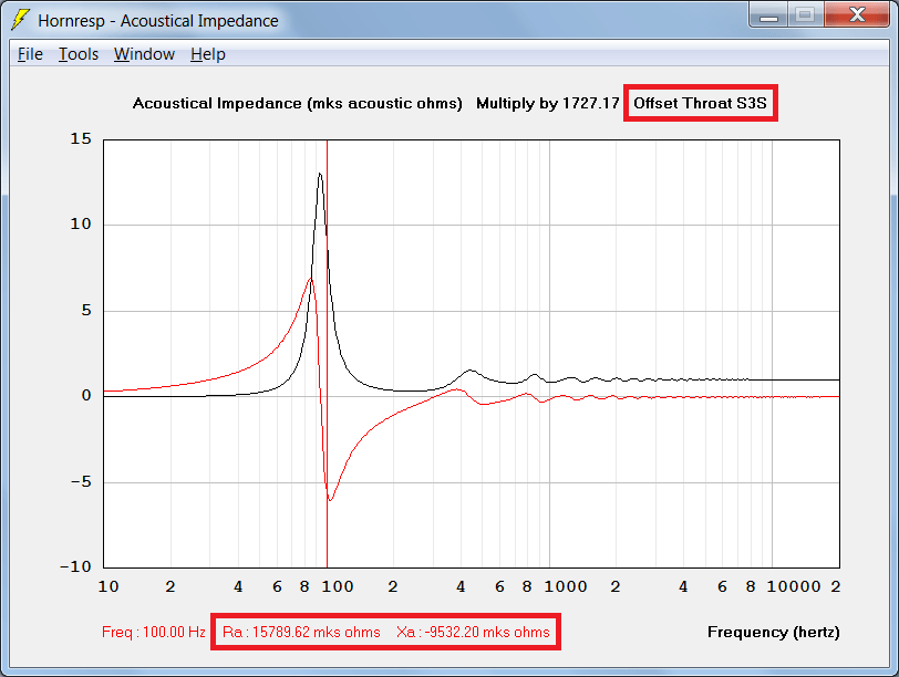

Sampled acoustical impedance values are now given in mks ohms rather than cgs ohms, and the point at which the impedance is calculated is now more clearly indicated in the chart header. Attachment 1 refers.

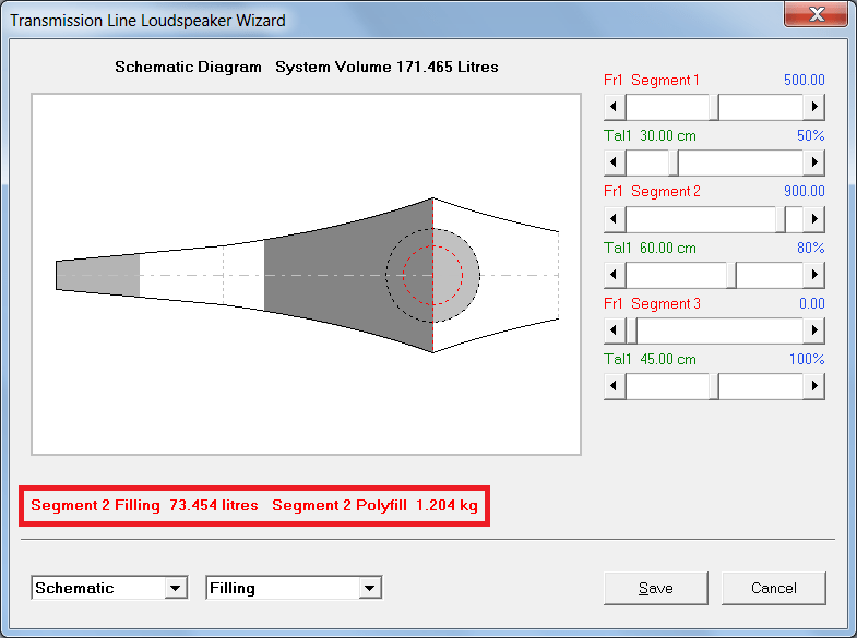

Absorbent filling material volumes for the total system and individual segments are now shown in the loudspeaker wizard. Double-clicking the Filling label switches between total volume and segment volume values. Attachment 2 refers.

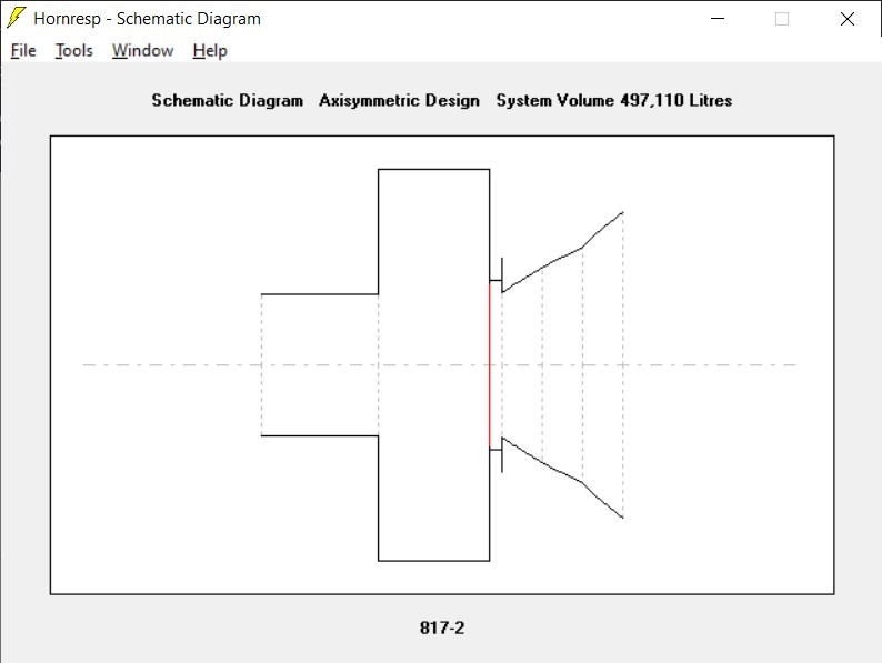

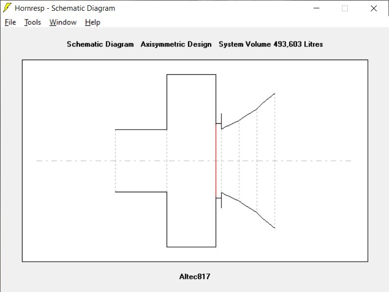

The original A800 VoTT and its later 815, 817 variants have a 55 Hz flare frequency, exponential flare factor, but since they have a parallel pair of walls it's technically a parabolic flare factor, hence HR's breaking it down into slant board expansions for a most technically correct sim, so kudos to DMB for this acoustically relatively minute attention to detail. 👍 😎
That said, if for a HIFI/HT app, there's some audible advantage to using the 825, 828 flared horn design (along with some extra bracing, damping), which can be simmed with its 'close enough' exponential curvature to compare, though of course more woodworking intensive.
I think there must be an error in the dimensions of the pavilion, because it is not straight in reality, it opens more and more!
I don't know the source of the Hornresp design shown, but the Altec horn should be modelled as a single exponential flare segment, rather than being approximated by multiple parabolic segments.
Just to clarify, the flare would be parabolic if the top and bottom were flat parallel panels and the sides were angled flat panels, so that the cross-sectional area expanded linearly. The Altec horn has flat angled top and bottom panels with the side panels being curved to make the overall area expansion rate exponential.

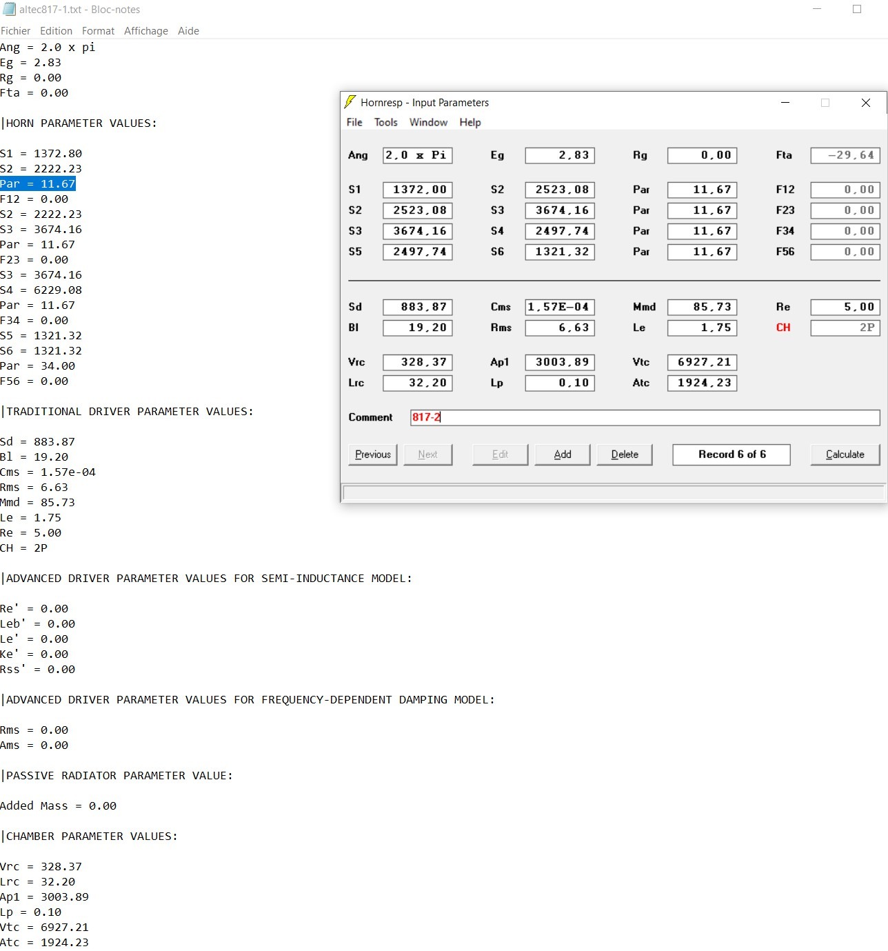

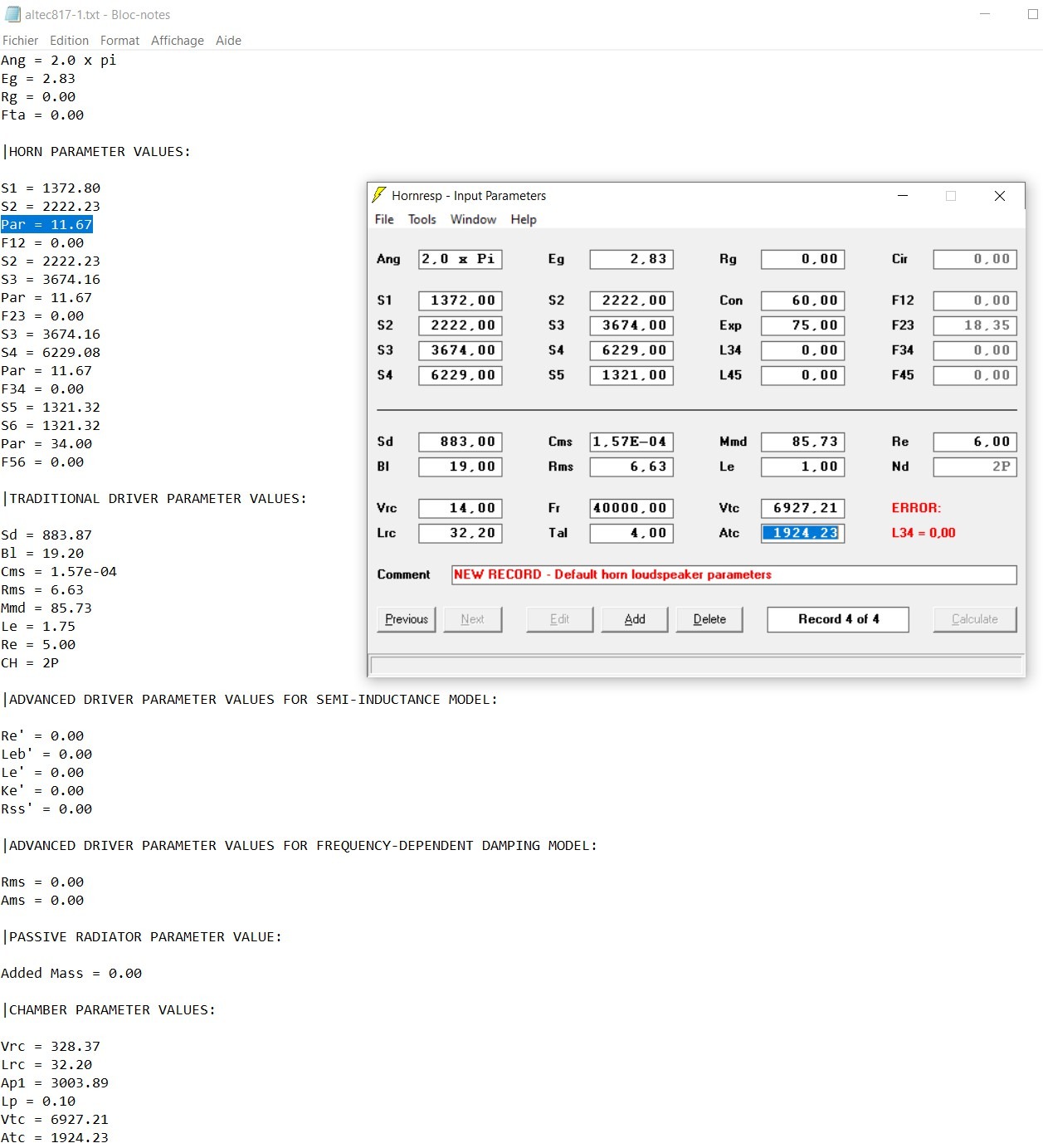

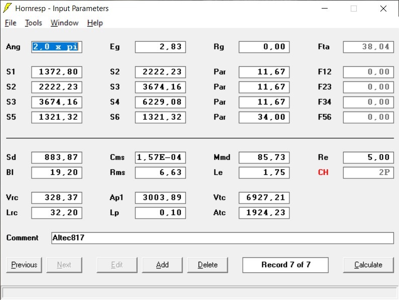

I downloaded the 817-2.zip file, and I was inspired by a .txt file that I copied into "hornresp".
But it gives me an error!
Can you guide me?
Thanks,
This file is meant to be imported from File -> Import -> Hornresp Record. That will save you a lot of typing, get all the info into the right places, and avoid errors like the one you saw.
I put the txt file in Hornresp's "import" folder, and it looks more correct!
Is this also your opinion?

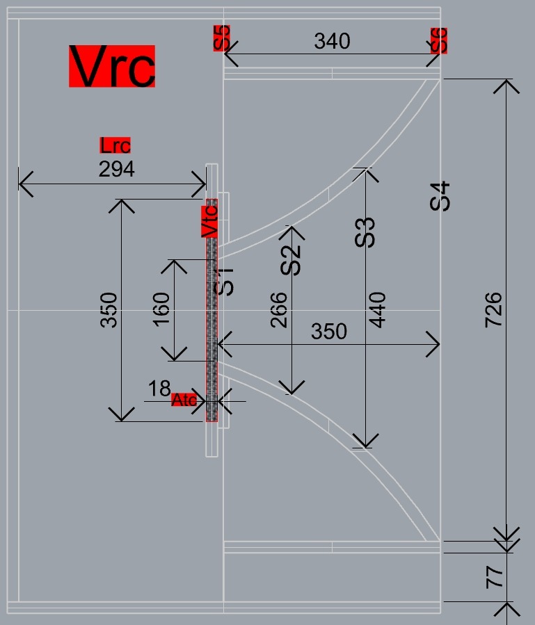

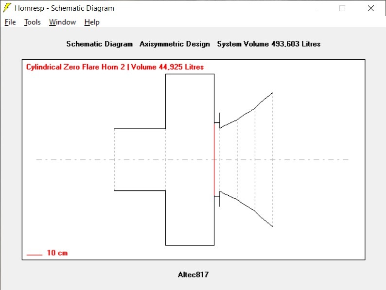

I would have thought that it was enough in the software, to enter the starting surface (the throat), then the exit (the mouth), and indicating the length of the pavilion, for this to work well. But apparently, we have to do it piece by piece?
Can someone explain to me what S5 and S6 correspond to since the numbers are identical?
It's a shame that on the image of the "shematic diagram", we don't find the labels S1, S2, etc., it would be more understandable to understand the correspondence.
Last question, is the bass-reflex represented by the volume of the left part on the image below?
And in "input parameters" we find it where, it is to be able to modify its agreement "Fb"?
