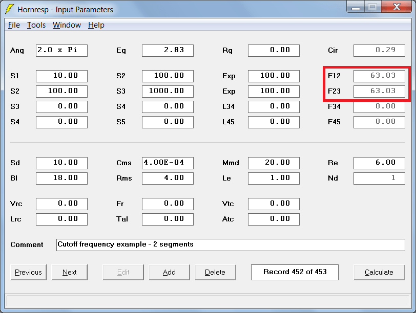

If L12 is constant then the value of F12 will simply depend upon the ratio of S2 / S1. If the ratio doesn't change then neither will the cutoff frequency.

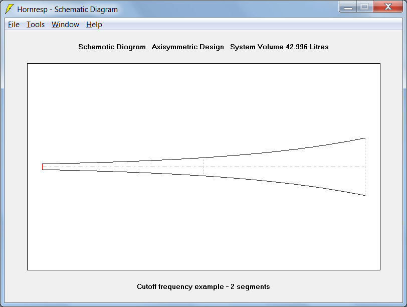

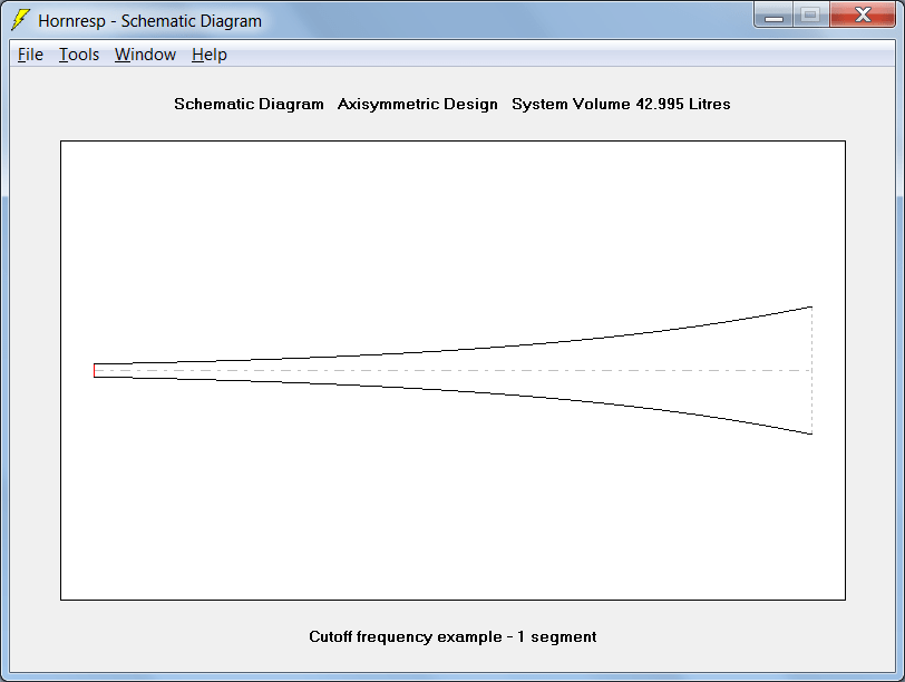

Assume that a single large horn has the dimensions S1 = 100, S2 = 1000 and L12 = 100, so that ratio of S2 / S1 equals 1000 / 100 or 10:1.
Now assume that the same-sized horn has 10 cells, making the dimensions of each cell S1 = 10, S2 = 100 and L12 = 100, so that ratio of S2 / S1 equals 100 / 10 or 10:1, the same as for the single large horn.
The ratio of S2 / S1 hasn't changed, so the cutoff frequency of each individual cell is the same as that for the large horn.
This can be clearly seen in Attachment 1 where segment 1 has the dimensions of a single cell and segment 2 has the dimensions of the large horn. The cutoff frequencies of both segments are the same. Attachment 2 shows the schematic for the two-segment horn, which as expected is identical to the one for a single-segment horn having S1 = 10, S2 =1000 and L12 = 200, as shown in Attachment 3.
(The 0.001 litres difference in volume between the one-segment and two-segment horns is simply due to the rounding of the individual segment volumes in the two-segment horn).

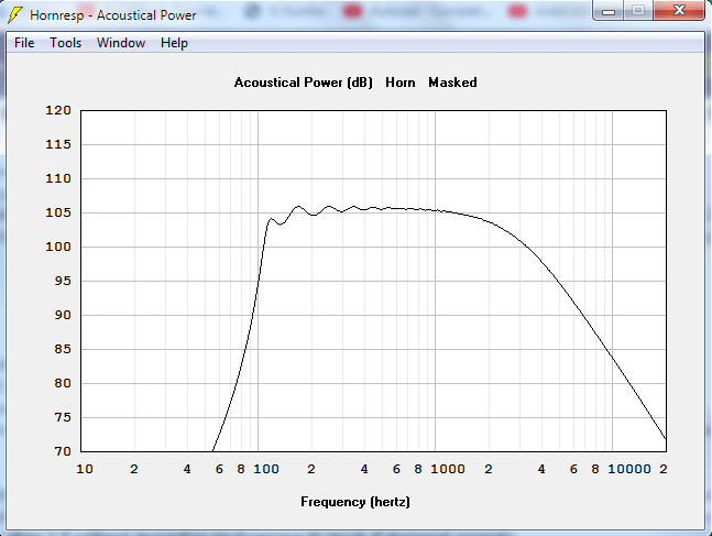

The power response of the multicell horn system is effectively the same as that for the equivalent single large horn. The power response of a single cell in isolation will of course be quite different, because of its much smaller physical dimensions.

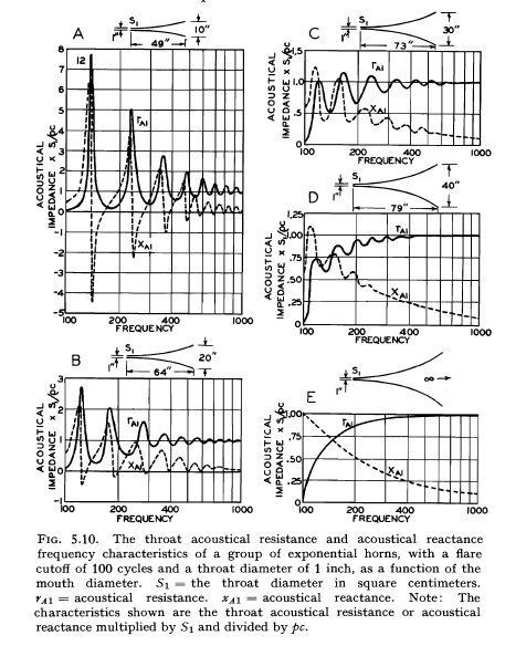

But the lowest frequency a horn can (efficiently) reproduce in practice is set by both the flare rate, the length of the horn, and the size of the mouth. The size of the mouth (in terms of wavelengths) determines if the wave propagating through the horn will be able to radiate efficiently, or be partially or nearly fully reflected. In this case, the size of the mouth should be the effective size, i.e. the total area of all the cells radiating, and the acoustic mirror images from nearby walls etc. The length of the horn (in terms of wavelengths) determines if the horn is long enough to do it's job as an impedance transformer, or if it's so short that it will behave merely as a discontinuity and added air mass. Then you have the interaction with the driver, which is yet another factor.
When you look at the equations David gave, you can see there is no comparison between the mouth size (S2) and the cutoff frequency, or between the length of the horn and the cutoff frequency.
If by cosh horn you mean a Hypex horn with T < 1, the equivalence still applies. The cutoff frequency is still calculated based on the S2/S1 ratio, it is just that the T factor enters the mix.
Perhaps the F12 value is not related to the actual lower frequency which can be reproduced by a given horn ?
F12 is a theoretical value based on the performance of an infinite horn.
For a given S1 and F12, the throat acoustical impedance will vary depending upon the value of L12 and hence S2, in the manner shown below.

EDIT - The important thing, as stated earlier, is that the power response of a multicell horn will be effectively the same as that of an equivalent-sized single large horn, regardless of the F12 value.

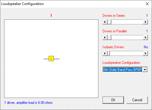

I've been Looking for 2h how to simulate a BP6 enclosure and i still can't find the solution. The BP6 isn't shown in the speaker type choices (where it should be written in Red) and the other solutions i've read don't work for me (i literally copy everything and it gives me errors cause the S3 is at 0, and i can't change anything).
Is there something i missed (i've used it only to sim TH and MLTL enclosures, i'm still new at it)?
I'm sorry to have to ask this topic for this question and sorry for my maybe poor english.
Thanks a lot if you can help me.

The augmented passive radiator (APR) alignment shown in the Vance Dickason Loudspeaker Design Cookbook cannot currently be simulated in Hornresp, and for all sorts of reasons, it's not going to happen. I suspect that it could even be a challenge to model the system in AKABAK due to the requirement for two mechanically-connected passive radiators.
