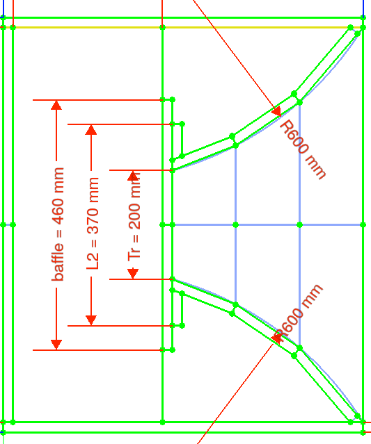

Is there any plan to add a new type of flare for hornresp? like two parallels walls and curves surface?
Considering fixed S1 and S2 (2*S1), there would be infinite curved surfaces with different radius, don't know how hornresp could define the radius once changing the amount of input boxes will never happen. Maybe a semi-exponencial? two parallel walls and two exponencial walls, could it be reasonable?
As you can see in the attachment, for the Altec816 I emulated the curved surface with three parabolic segments, but there are some cases that having a curved flare would be good mainly saving segments.
Marcelo

Hi Marcelo,
After reading your post I experimented with a test example to see what shape the equivalent axisymmetric horn segment would take, given the following inputs:
Throat width = 30 cm
Throat height = 11.28 cm
Mouth width = 30 cm
Mouth height = 252.31 cm
Axial length = 120 cm
Radius of curvature = 125 cm
The blue trace in the attachment shows the axisymmetric profile of the "constant radius" segment specified above. The red trace shows the axisymmetric profile of an exponential segment having the same throat area, mouth area and axial length as the test segment.
While the profiles are certainly different, for simulation purposes the exponential flare is probably a reasonable approximation given that the segment is assumed to be axisymmetric anyway.
Finite element analysis techniques would need to be used to accurately model the blue profile, which unlike parabolic, conical and exponential flares, cannot be described by a relatively simple equation.
Based on past experience FEA would slow calculation times considerably, making it impractical to use multiple segments and "real-time" tools like the Loudspeaker Wizard.

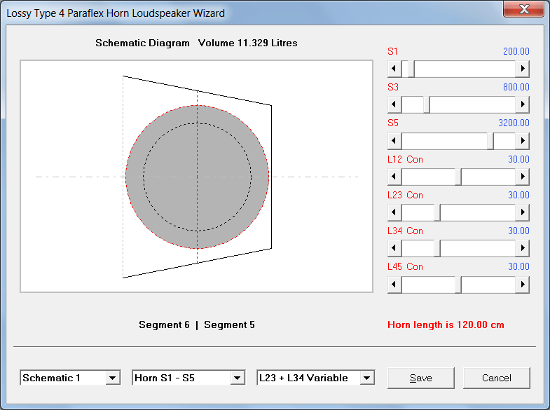

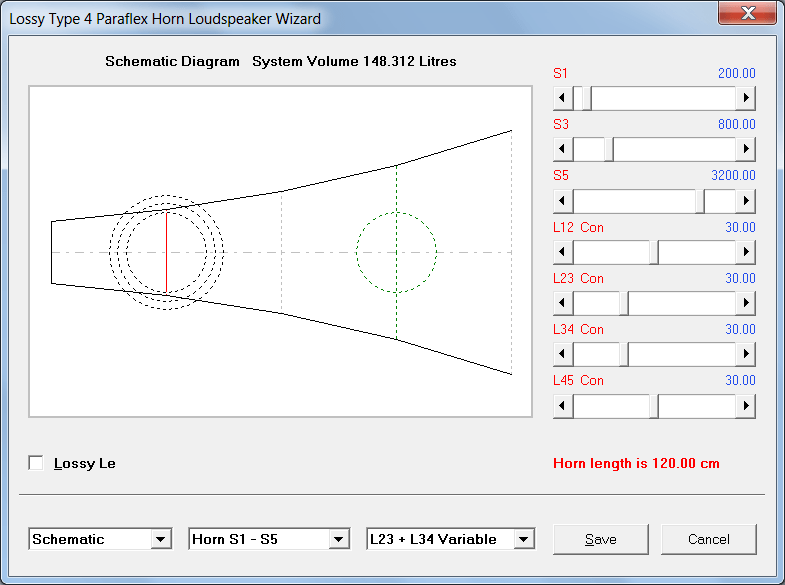

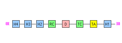

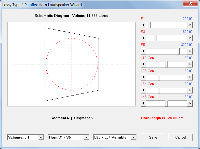

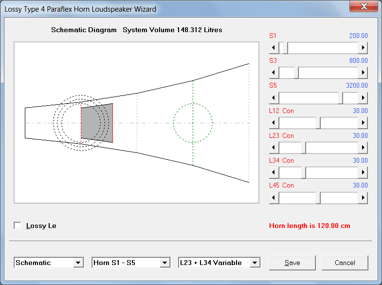

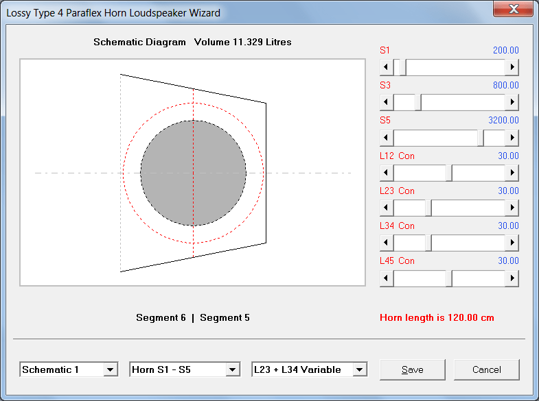

Hornresp Update 5440-221023
Hi Everyone,
CHANGE
The PH4 Schematic Diagram on the main form and the Schematic and Schematic 1 diagrams in the PH4 Loudspeaker Wizard were not showing Segment 7 correctly. This has now been fixed.
Attachments 1 and 2 show the old incorrect diagrams. Attachments 3 and 4 show the new corrected diagrams (with absorbent filling material in segment 7).
Kind regards,
David

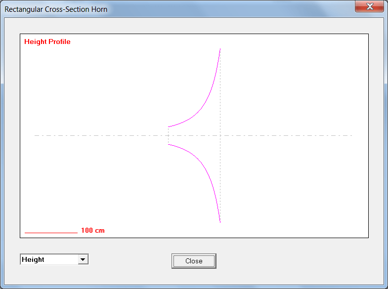

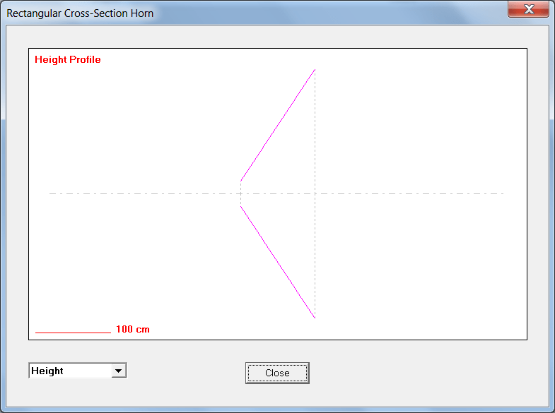

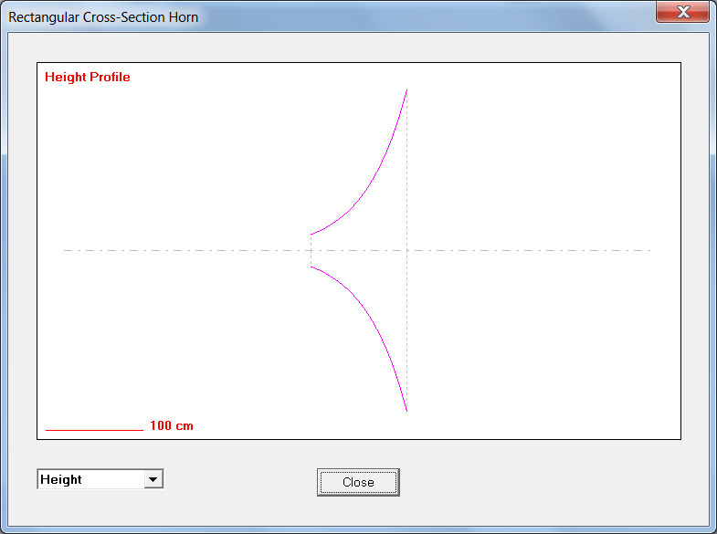

from all this profile the only one that consider two parallel walls is the parabolic, so all the others expands the 4 walls or are kind of circular, is this right?
Any rectangular cross-section horn can have two parallel sides, it's just that with a parabolic flare horn the other two non-parallel sides will be straight panels because the overall area expansion rate of a parabolic horn is linear. For all other horn types, if two sides are parallel then the other two non-parallel sides will be curved rather than straight, to maintain the required area expansion rate of the horn in question.
In the rectangular cross-section test examples shown attached, S1 = 1000 cm2, S2 = 10000 cm2, L12 = 100 cm and width (distance between parallel sides) = 30 cm.
Attachment 1 shows the height profile of a parabolic flare horn (note the straight sides).
Attachment 2 shows the height profile of a conical flare horn.
Attachment 3 shows the height profile of an exponential flare horn.
Attachment 4 shows the height profile of a Bessel horn with m = -2 (Gabriel's horn).

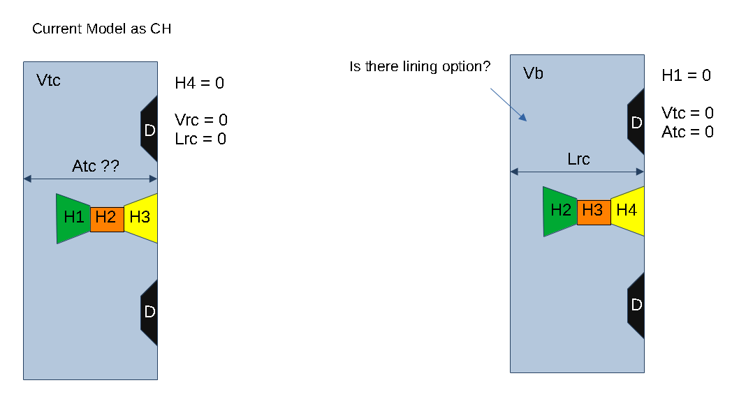

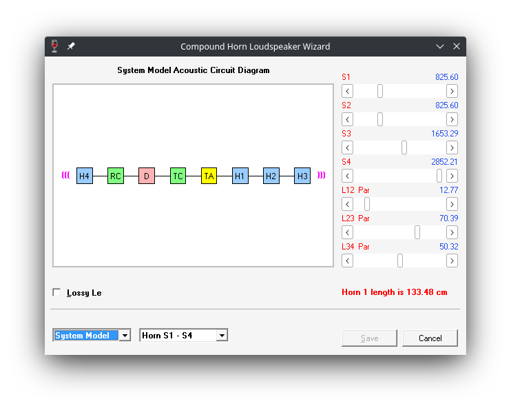

Regarding the Compound Horn as represented in the attachment #1 with the system model.
There is a loudspeaker design that I'm thinking to model in opposite direction (see attachment #1 you can think about the super scooper too), so it means that the Throat Chamber will work as Rear Chamber, but it rise a concern because the way you define both inputs are different, besides they can have the same volume (Vrc = Vtc) the second variable are different, for the rear chamber you define the length Lrc while for the throat you define the area Atc, from past simulations I saw that Lrc brings an important influence in the frequency response so I may loose accuracy if I use one to emulate the other. In case it's not recommended to follow this path. Would it be possible to create a new Compound Horn (CH2) in order to allow just one segment (H1) in the front side connected to the throat chamber/port and move the others 2 segments (H2 and H3) to the rear chamber connected to the H4 segment? see the attachment #2 and 3 Or even 4 segments in the rear chamber in this case it could be a new type of single driver like Nb1.

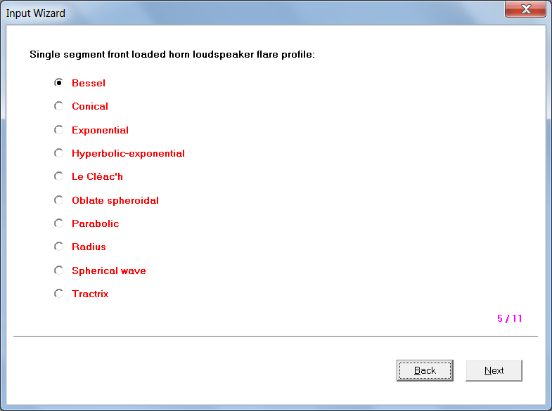

In a Compound Horn (CH) I was not able to double click in the throat adapter (Ap1 + Lp) and replace it with Acoustical Lining (Far + Tal) is this a bug from Linux or in fact this option isn't available for CH?
Atc rather than Ltc is used as one of the two throat chamber parameters just to make things a little easier, because often Atc is specified simply as being equal to Sd, or n x Sd for multiple drivers.
Ltc is still used in the simulation model itself though, and is calculated as Vtc / Atc.
The Fr + Tal acoustical lining model is only suitable for use with closed rear chambers. The throat chamber resonances can however be hidden using the "resonances masked" option.
Notes:
1. The maximum value of Vtc can be 999999.9 or almost 1000 litres.
2. No internal end correction is included when the port tube is specified using horn segments.
3. The design could alternatively be configured as shown in the attachments, with the "resonances not masked" option results being identical. If required, absorbent filling material could also be added to the segment 1 "chamber".
