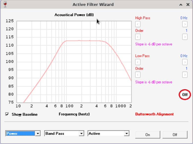

Hello,
Unfortunately, I can no longer use the "Filter Wizard" under Wine/linux in the actual versions of Hornresp.
The sliders are no longer displayed (see picture) in other tools (e.g. Loudspeaker Wizard) the sliders work.
So far I have managed to use an old version (53.20) - but now the data format seems to have changed and it is no longer possible to switch between the versions.
I know that Wine is not supported - maybe someone has a tip. Hornresp ran so well under Wine and I can't/won't use Windows (even in a virtual machine).
many grettings, Michael

Hi Michael,
An On / Off switch was added to the active filter wizard in Version 54.10. Try double-clicking on the black 'Off' label shown circled in red on the attached screenprint. This will enable the sliders. Could you please let me know if this fixes the problem.
Kind regards,
David
