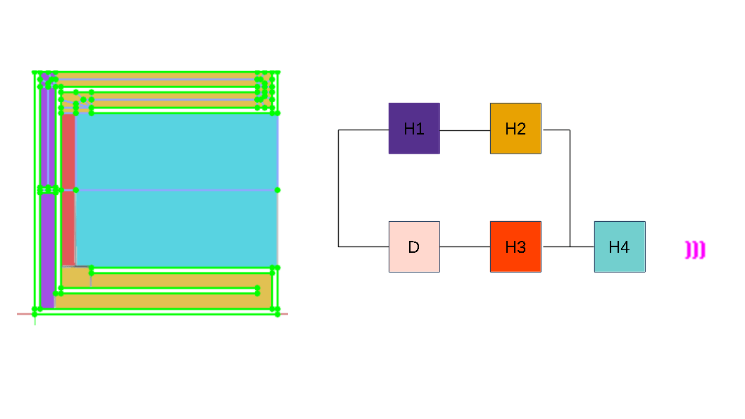

Hello David,
The Hornresp input defined by Martinsson for his ROAR project looks little strange for what concern H3 element. See attachment #1 In his website there are mode data available. The real enclosure don't have the expansions between S3 and S4, so volume defined for H3 don't looks real. Maybe it's the best he found using TH model.
Do you think that the system model in the attachment #2 might be viable? maybe it can improve ROAR simulation. In addition, he is not getting benefit from H1, it's a very small volume at hornresp but in the real enclosure is a small brace, so no volume at all, probably because L12 can't be 0.
H3 will not share S3 with H2 and L34 will be small compared to the S4/S5 area. S4, S5 and S6 can assume the same area value.

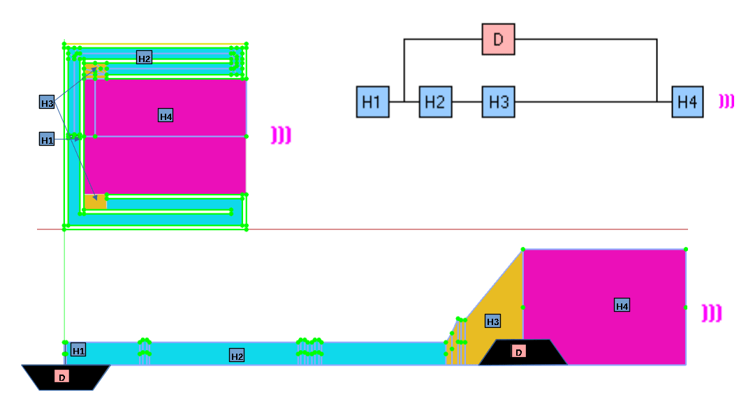

The closest you could probably get would be using the PH1 model, but I don't see that as being particularly accurate in this case.

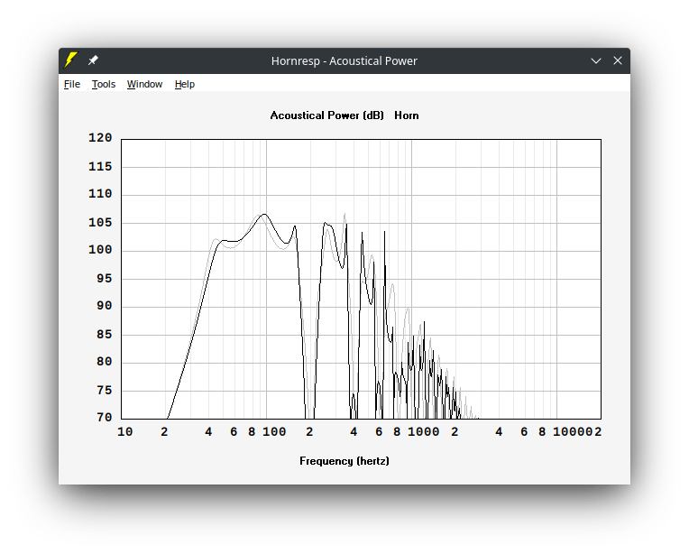

See attached the simulation comparison between the TH1 (gray) vs PH1 (black).
Volume difference is very high:
TH = 347,3 L
PH1 = 311.4 L
Looks like the difference is small for the Acoustical Power and maybe PH1 give better prediction if users change enclosure dimensions, if TH1 was forced to FIT the real measurements and if it's not linear, it will increase the error according to the changes.
If @martinsson see this post, he cold compare both with the measurement to see if PH1 is closer. Probably backing in the time, PH1 might not be released yet.

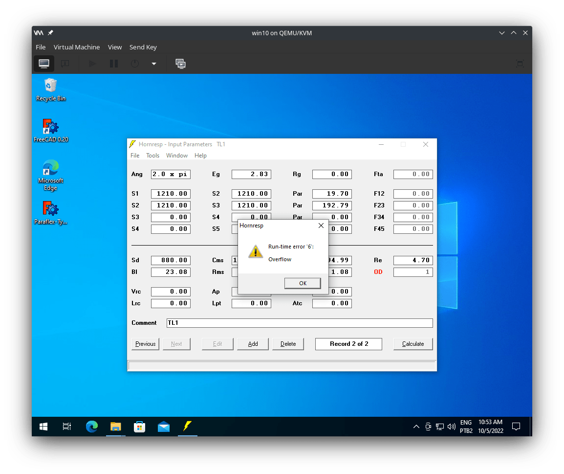

Hello David,
I'm facing Hornresp error Run-time error '6': Overflow while trying to open Loundspeaker wizard from the input screen.
The simulation runs correctly and I can open and close data without issue. It happen on linux and also on windows 10 VM as you can see from the attached picture.
Attached you can also find two inputdada to replicate it.

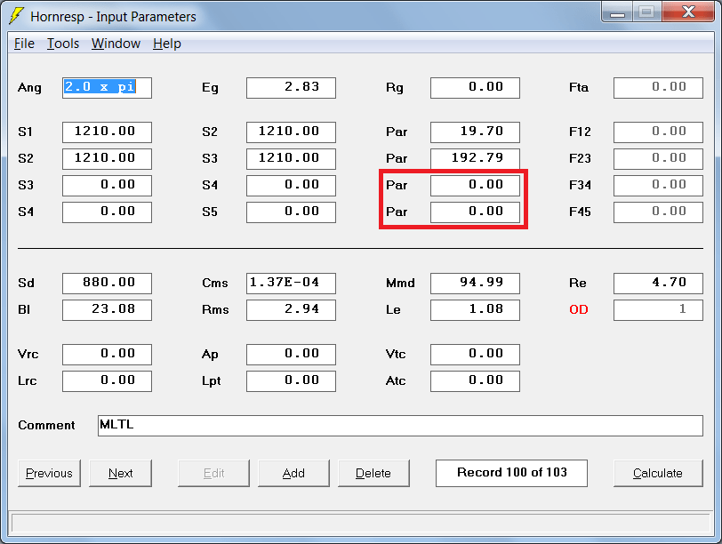

Somehow you managed to get L34 and L45 to have Par flares with zero lengths. That is supposed to be impossible :).
To fix the problem, in Edit mode simply click on the L34 input box, then on the L45 input box, and then on the L34 input box again. This should clear both of the unwanted Par flare labels.

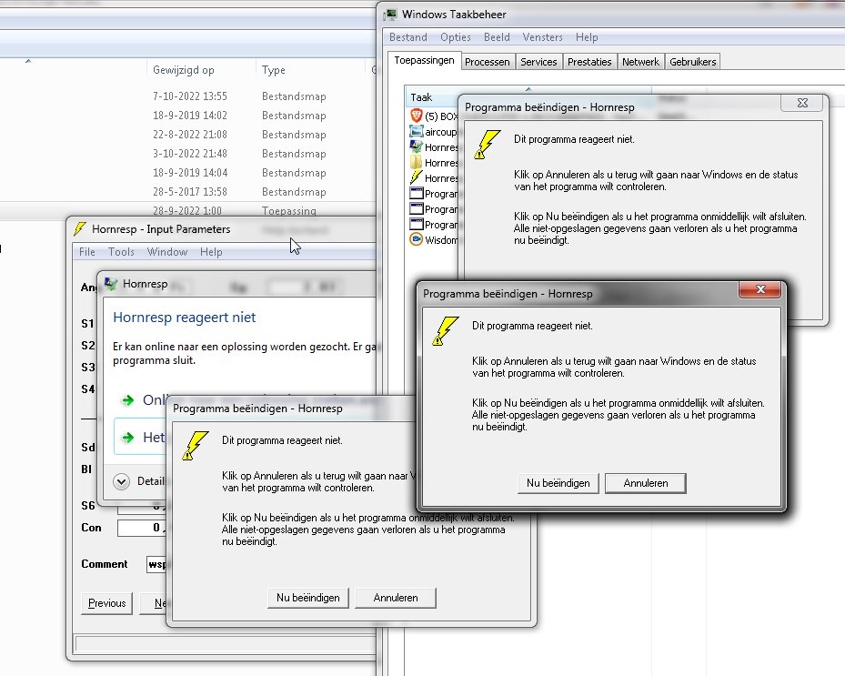

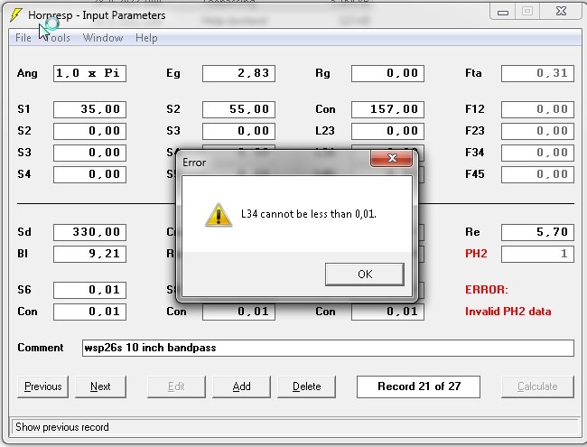

A little bug? It was nmot possible anymore to close horresp program, did need control alt del,
and even then it did not close fast. I did try to set L34 higher valeu but did not accept and I did
try to close program, it did refuse.

I did try to set L34 higher valeu but did not accept and I did try to close program, it did refuse.
Hi Kees,
Thanks for the feedback, I was aware of the problem but was hoping that it would not become an issue :).
As the complexity of Hornresp increases it is becoming more and more difficult to foresee all the possible actions that a user might take. I will try to change things in the next update so that the problem can no longer arise. In the meantime, the way around the specific example you have provided would be to highlight the L34 input box, key in C100 and press Enter. You will then find that you can close the program or move to another record.
