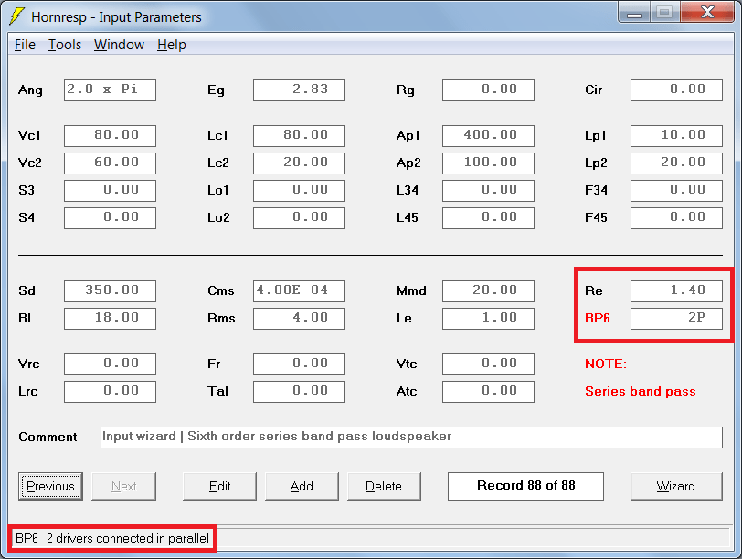

So two dual voice coil subwoofers wired to Paralel-Series resulting 0.7ohm load on amplifier. How can I simulate this in hornresp?
If the two voice-coils are connected in series then set Re = 0.7 + 0.7 = 1.4 ohms and specify BP6 = 2P for two drivers in parallel.
Alternatively, if the two voice-coils are connected in parallel then set Re = 0.35 ohms and specify BP6 = 2S for two drivers in series.
Okay I get it, but what about wattage simulation? If I want to simulate 5000w per subwoofer (10000w total for two) and if final load is 0.7ohm, what should I type in this form?

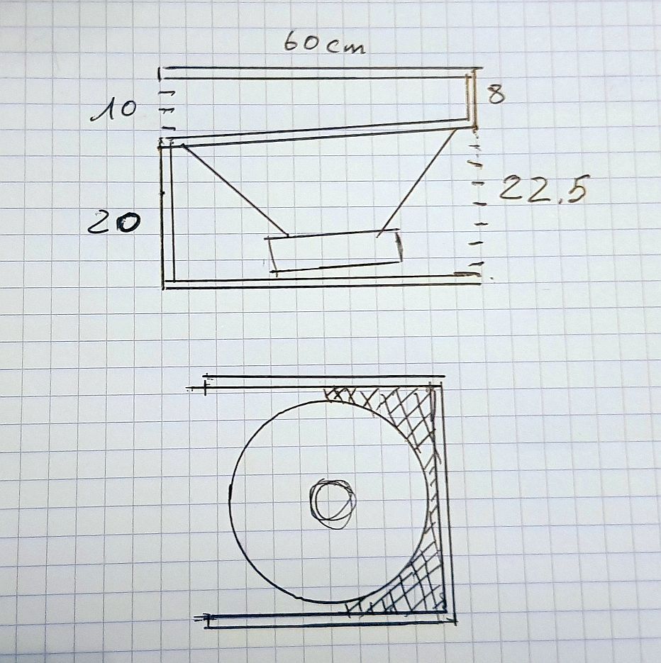

The driver offset is zero. Because of the nature of the enclosure layout is difficult to specify Lc1 and Lc2 as exact accurate lengths. Thankfully it doesn't matter too much - try changing the Lc1 and Lc2 values to see how the response alters. If you click on the Lc1 and Lc2 sliders, the red line that appears on the system model acoustic circuit diagram shows what the simulation model is assuming are the lengths.
I found this image in one hornresp manual.. If this is right then in my case lc2 would be 135cm and lc1 79cm right?
The load seen by the amplifier, and the power that the amplifier needs to deliver to the load.
That is:
Power in watts = 10000
Load impedance in ohms = 0.7
If the impedance of each driver reduces to exactly 1.4 ohms at some very low frequency (it would have to be close to f = 0), then the input power to each driver at that frequency will be 5000 W, and the total power delivered by the amplifier will be 10000 W.
In practice, the impedance is unlikely to get down to to 0.7 ohms so that the actual maximum input powers will be somewhat less that the figures shown above.
No image included.
The System Model shows that:
Lc1 is the acoustic path length from one side of the driver diaphragm, through Chamber 1 to the input of the port tube that vents externally.
Lc2 is the acoustic path length from the other side of the driver diaphragm, through Chamber 2 to the input of the port tube connecting Chamber 2 to Chamber 1.
Based on the diagram and dimensions given:
Lc1 is likely to be somewhere near 135 cm
Lc2 is likely to be somewhere near 79 cm
Try using these values initially, and then adjust them to see how sensitive the results are to any changes.
