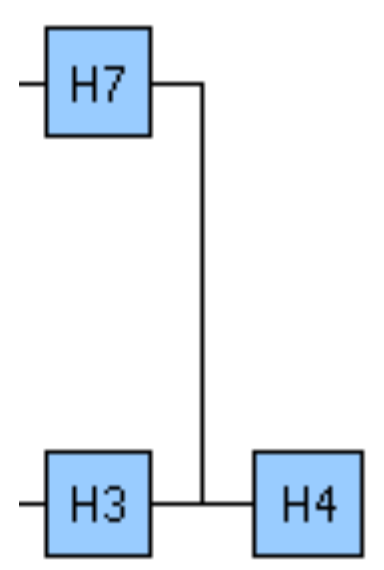

If I don't disturb you too much, I think understanding hornresp is enough, from math or programming standing point, you defined 3 volumes: H7, H3 and H4, all with respectively throat and mouth, how did you made the connection? there is a high chance that if the math works, probably the volumes in the real world might work too.
One more questions.

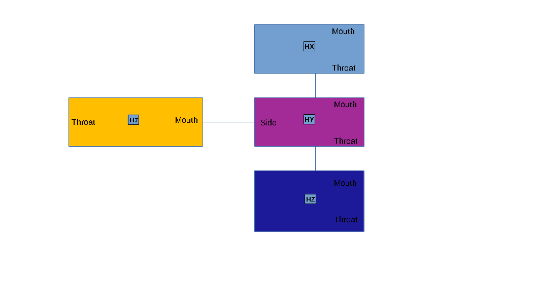

Considering the knowledge you have, would it be possible to define a side connection in hornresp as you can see in the attachment #2?
I will not even try to ask you new feature, i'm glad you hekp me a lot and probably the right way now is to find how people are using the current model available, asking Brian Steele help would be an option once he has spreadsheet for paraflex type. In a while I'm restless because I can't figure out how to make the current connection in the real world.
link H7 mouth to H4 troat
link H7 mouth to H3 mouth
link H3 mouth to H3 troat
I think it's only possible if all are POINTS, being a volume it's not maybe it's not feasible. Two objects cannot occupy the same space simultaneously.

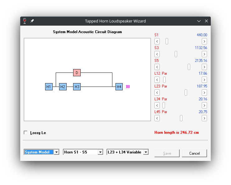

Just a complement, for my sanity (LoL) I checked the system model for Taped Horn, see attachment, because that model is very well know and I build a Loudspeaker using that model witch result is very close to the simulation. That model also consider a connection (node) of tree volumes, in this case the driver and it's placed in between at S2 between H1 and H2, a kind of side feeding like I did for the paraflex, but in paraflex I tough that the area of the H7 would work in a similar way so I placed H7 at S4 between H3 and H4.
The simulation model assumes that the three connecting lines are acoustic paths and calculates the volume velocities through them and the pressure at the common connection point. In effect, exactly the same as calculating the currents and voltage in an electrical circuit.
The 1P (one-parameter) horn theory used in Hornresp means that horn segments are in effect two-port devices, and that it is not possible to have a third port in the side of a segment. The only way that an offset can be applied is to have it at the interface between two adjoining segments, as is currently done.
H3, H4 and H7 are lumped element segments and have volumes - but yes, in effect they are connected together at a single point.

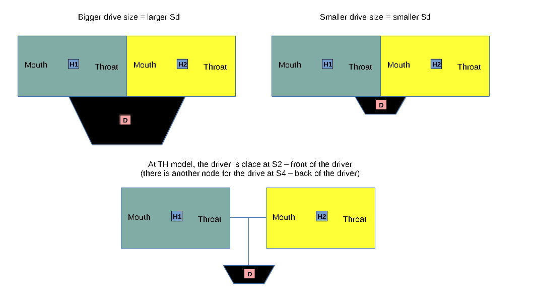

Sharing above sentences cleared a lot for me, thank you again. and also based on that and as I pointed in the post #13,045, also the driver feeds in a 3-node connection, and if you change driver cone size, the input parameter for the volume H1, H2, etc, will not be affected, see attachment. So, I think the approach I had for paraflex is the same and don't know why you said in the post #13,034.
The connection of H7 to H3 and H4 as shown in your physical design is not the same as that assumed by the system model. You have the mouth of H7 feeding into the sides of H3 and H4, not into their mouth and throat ends respectively.
H7 mouth (S9) placed between H3 and H4 (S4) in a PH1 model correlates to driver D (Sd) placed between H1 and H2 (S2), don't?
Looks like the driver is feeding the sides of H1 and H2.
Sorry for the confusion - I was in a bit of a hurry at the time and would perhaps have worded things differently if I had a little longer to think about it 🙂.
From a theoretical point of view your design is indeed consistent with the PH1 system model, but from a practical perspective L23, L34 and L45 are relatively short compared to the diameters of Sd and S9 and I suspect that this may reduce the accuracy of the predictions compared to measured results. The only way to know for sure would be to build the system and see.

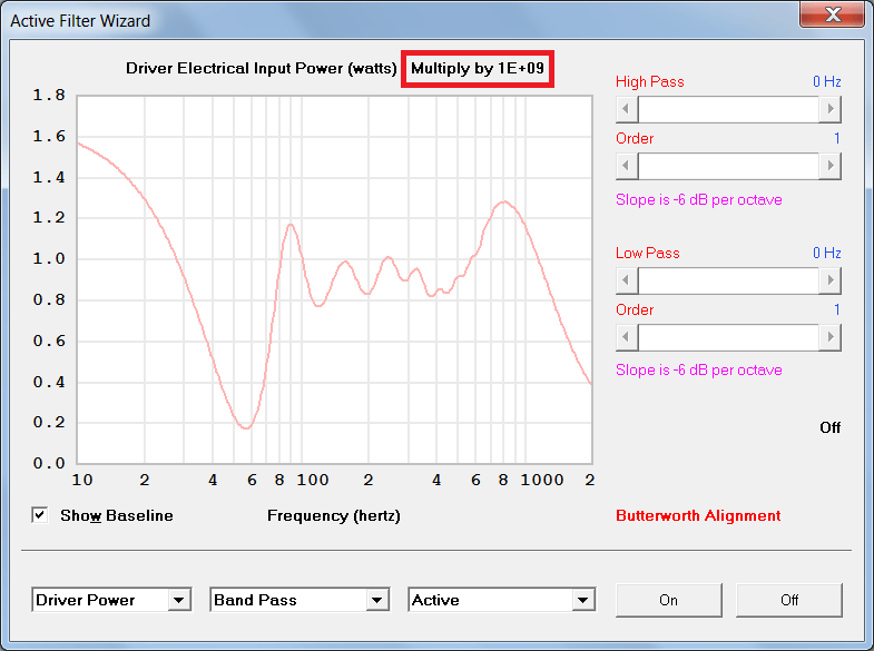

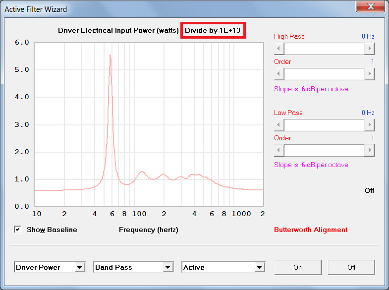

The Driver Electrical Input Power chart in the Filter Wizard is no longer limited to a maximum value of 800 watts. Post #13,038 refers.
