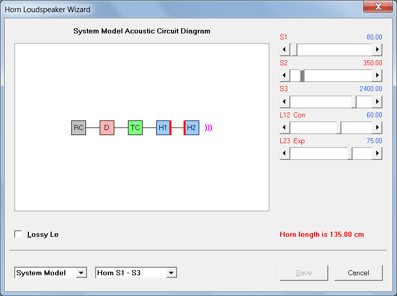

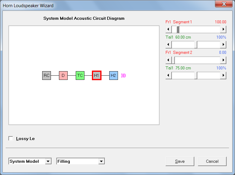

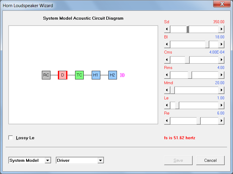

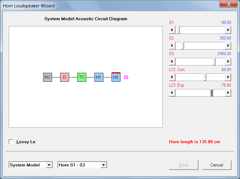

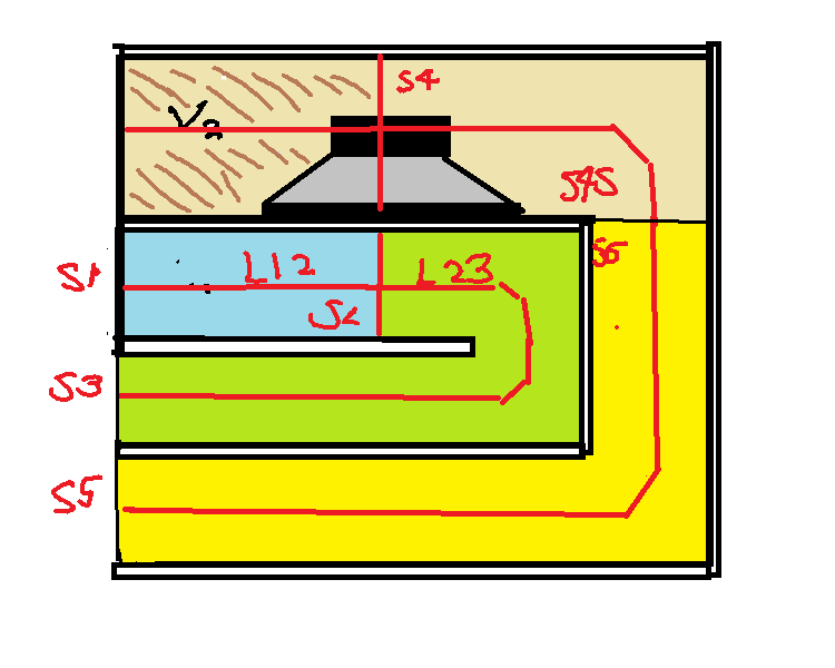

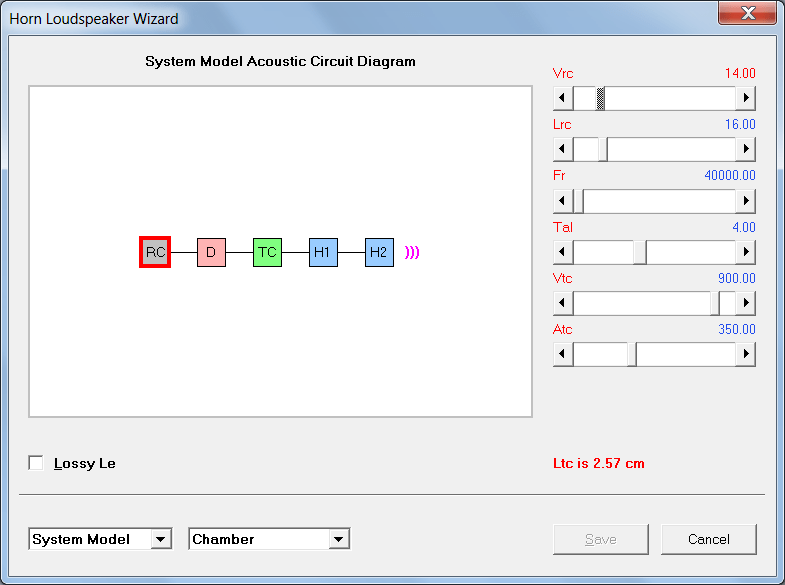

Hi David,The system model can be viewed in the Loudspeaker Wizard, which is where you will probably want to be anyway when designing a paraflex horn
Thanks to reminds me, I wasn't able to find it, looks like the time you update the hornresp is faster the the time we needs to memorize and learn all features.

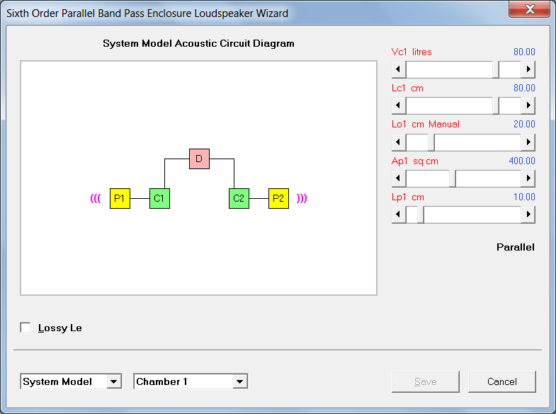

One more questions, Do the lines in the System model represent how each segment connects? if yes, so the lines defines where they start and where they finish witch also defines the orientation of the segment, I mean cross sectional areas are in the "line sides" of blocks H.
have a good day.
Yes.
The system model can be thought of as the acoustical equivalent to an electrical circuit diagram. In the system model, current becomes volume velocity and voltage becomes pressure.
Yes again.
Note that when a loudspeaker wizard slider has the focus, the location of the associated parameter is shown on the system model.
Using the default record as an example, when the S2 slider has the focus the planes of the horn segment 1 mouth cross-sectional area and the horn segment 2 throat cross-sectional area are highlighted in red, as shown in Attachment 1.
Similarly, length L23 is shown highlighted in Attachment 2, volume Vrc is shown highlighted in Attachment 3, front and rear diaphragm areas Sd are shown highlighted in Attachment 4 and horn segment 1 filling material Fr1 is shown highlighted in Attachment 5.

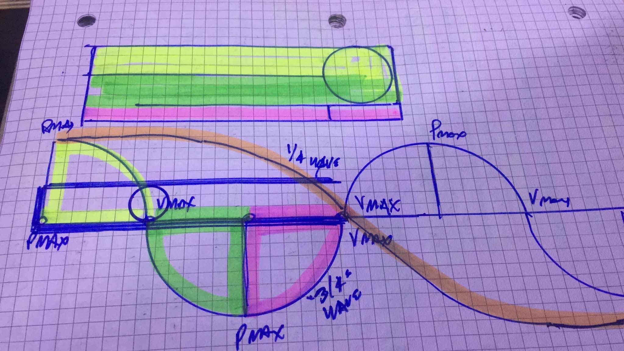

This isn’t rocket science once you do it the right way and give horn response a fair opportunity to show you something
In fact, you quickly figure out how it’s all the same exact thing youre just approaching it from the other side or upstream of the same side akready (2 x lamda/4)
Either you’re lining it up appropriately as one entire system or you’re screwing it all , up it’s up to you

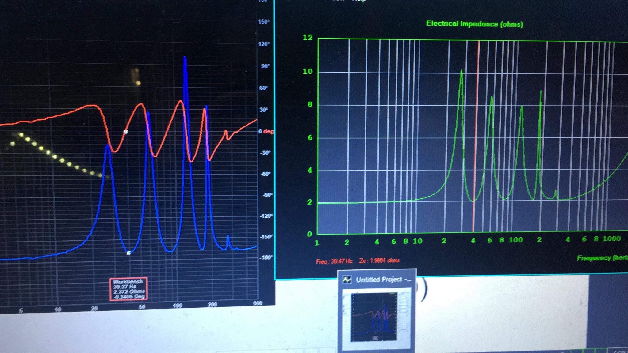

This doesn’t fit however it is faze aligned or whatever you wanna call that lack of discontinuity between both sides which poisons every single Paraflex model as ‘advertised’ and has since been damped out by stuffing the equivalent of an entire carnival prize guts into the angle bracing😝 Poor little stuffed animals get no respect, I just steal one of the wife’s pillows🤫What would be the best way, if there was a way at all, to simulate something like this in Hornresp?
Basically I'm trying for something like a Paraflex, but with a larger rear chamber and smaller front chamber.
So 864 = sqrt(3) * 864? Interesting...864 x2 minus 864 is sq rt of 3 • 864

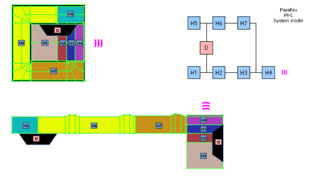

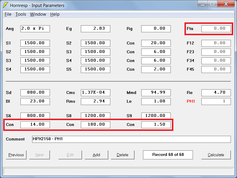

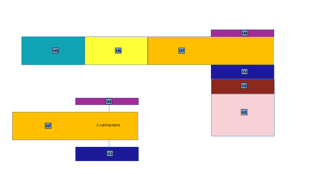

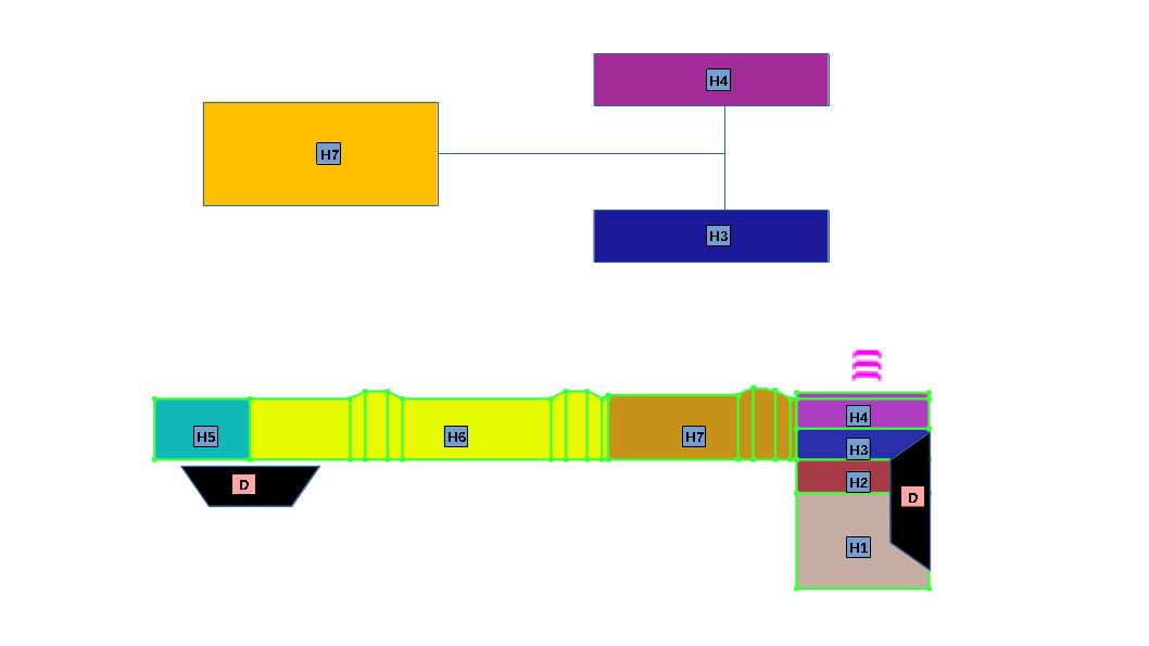

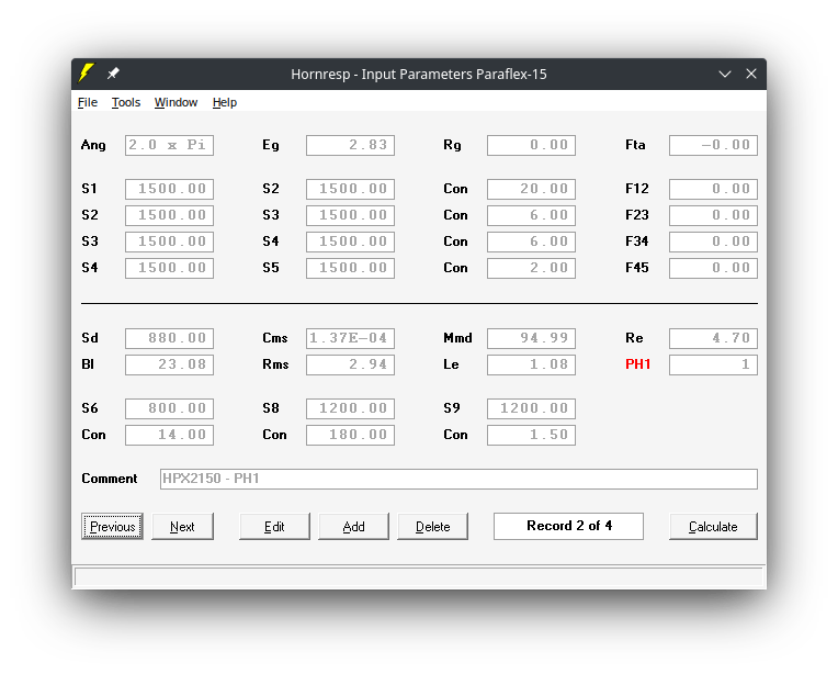

Hello David,
Brain Steele make a very good job as you programming the spreadsheets, but unfortunately It didn't work well with Libre Office nor Only Office and due to this I wasn't able to use them to check how they fit each type of Loundspeaker design to Hornresp model types. in addition. I prefer to used CAD system with parametric sketch, so I can check real enclosure 3D model very fast and I have more freedom to change the model, for this purpose FreeCAD has showing a very good tool, while in the past I was using Solidwork but it needs licence, so I drop it for economic reason.
Questions:
Do you mind to confirm that my understanding of system model is right while applying the Hornresp Paraflex PH1 to the Paraflex design type C? see attachment.
S7 can't be defined in the input screen, there is no box for it, it will assume S6 value, right?
S9 defines how big is the area that couples to H3 & H4, and it not correlates with S4 because they are perpendicular (90º) in the 3D space, is this right?
Questions:

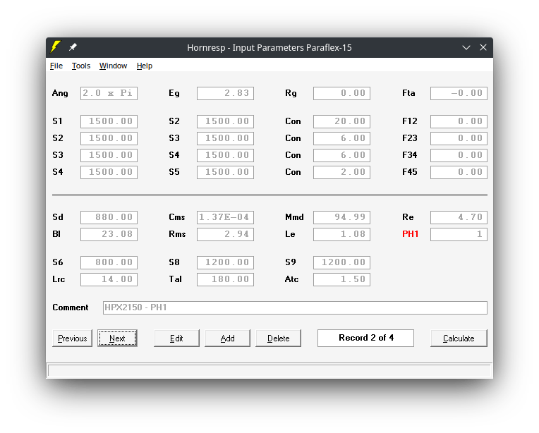

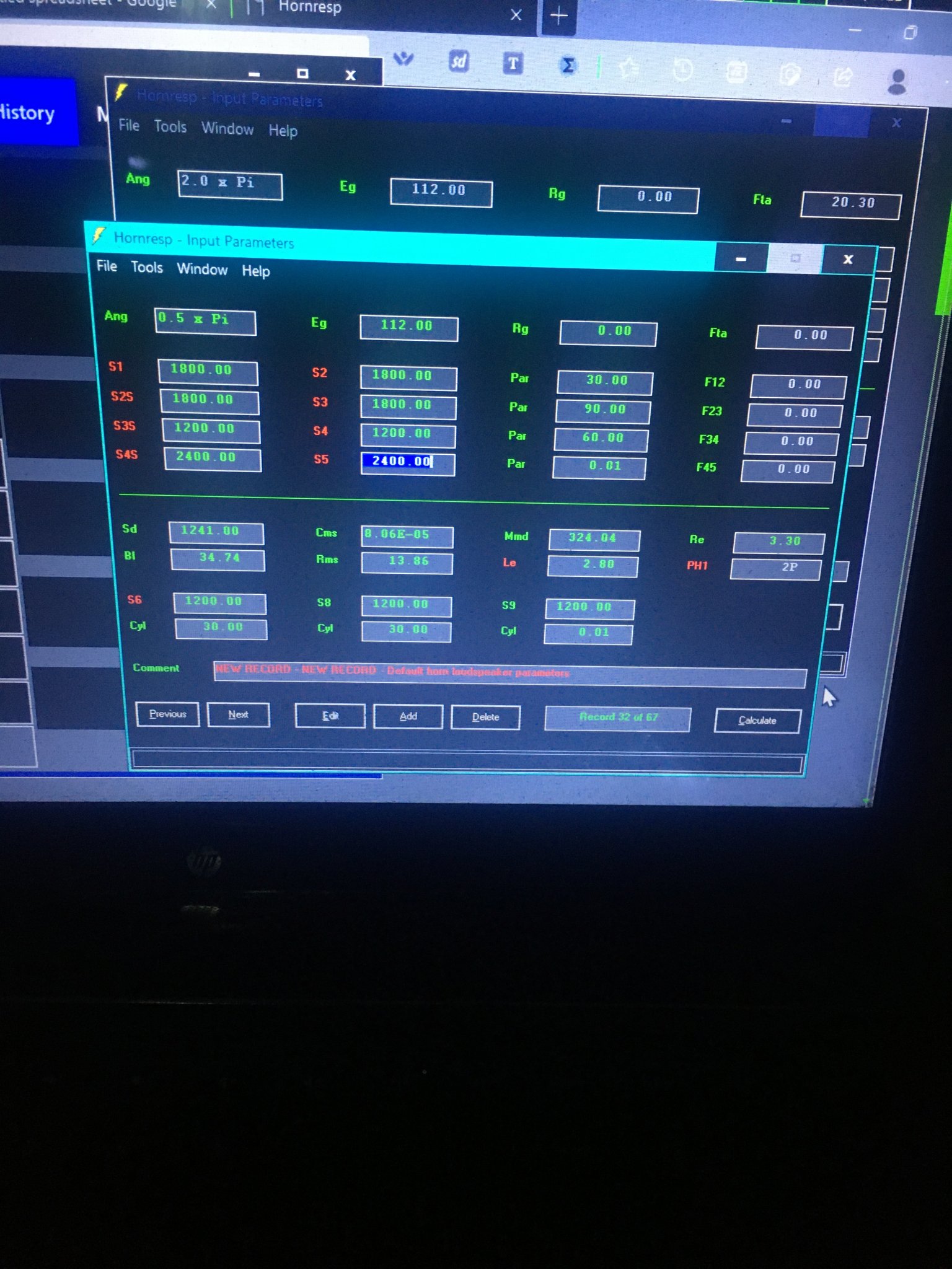

David, one more thing,
I think there is a BUG with with hornresp using PH1, don't know if affect other types.
Besides I save the input screen in a specific way (see attachment #1) if I close hornresp and open it again, it change below parameters (see attachment #2) resulting in a complet different simulation results and needing the user to change back the unwanted changes.
Below S6 it change from Con to Lrc
Below S8 it change from Con to Tal
Below S9 it change from Con to Atc
It happen all the time, easy to reproduce, and I'm using the latest version 54.30

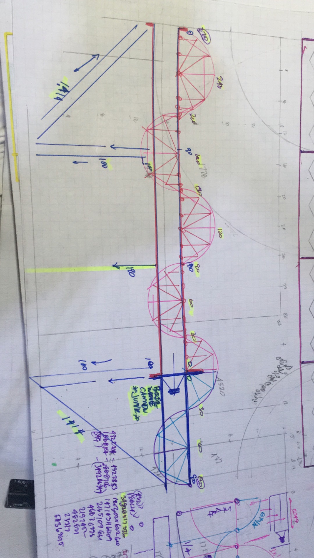

all of that needs to be squared as in (A squared plus B squared equals C squared) hence the reference to the pythago theorem reference but unfortunately I left that detail out when showing the example as you found, (thank you!)So 864 = sqrt(3) * 864? Interesting...
and C is the same as you would find in e equals MC squared?
e/pi is0.865
Sine and cosine of 30° are both 0.8660254 and 17320508..(60)
86.4 Hz is 1 m 172.8 is 1/2 of meter
1 m long pendulum at the equator swings exactly 30° and one second that is 05236 or 104.72 off of 90
Now look at the driver entry for 300 or 150 cm transmission line which would then cancel the cancellation already at 172.8 Hz or 86.4 Respectively
104.72/300
52.36/150
12 on 6.9375
24 on 13.875
48 on 27.75
96 on 55.5
192 on 111
384 on 222
768 on 444
1536 on 888
3072 on 1776

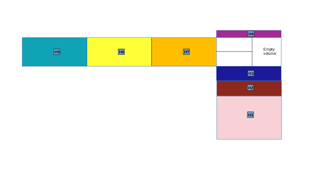

The connection of H7 to H3 and H4 as shown in your physical design is not the same as that assumed by the system model. You have the mouth of H7 feeding into the sides of H3 and H4, not into their mouth and throat ends respectively.
If S8 is set to Manual the value of S7 will be consistent with the expansion profile defined by S6, S8 and L67 + L78.
If S8 is set to Auto the values of S7 and S8 will be consistent with the expansion profile defined by S6, S9 and L67 + L78 + L89.
Correct.
S9 defines the mouth area of H7, whereas with unstepped segments S4 defines the mouth area of H3 and the throat area of H4.
It works just fine for me in a Windows environment. What happens if you export the record and then import it? Do you have the same problem? The other interesting thing is that your screenprints show -0.00 for Fta when all segments are cylindrical. Fta should be 0.00, without the negative sign.
Hello David, is there any clue how to proper represent it?
Considering that the system model indicates tree connections at the same time, I can't think other way to do it in a real case. See the attachment #1 for more clear understand what I was thinking, so I took the middle line of H7 mouth and connect this middle line in between H3 (mouth) and H4 (throat) because they are also connecting each other, so it became a side connection wich is wrong, but we can't let an empty volume like in the attachment #2 besides it would be more aligned with the system model, and if I extend H7 (attachment #3) and put it in between H3 and H4 as attachment #3, it would generate only 2 connections but not 3.
Regarding the bug, maybe it's because the record was created in a old version of hornresp? I exported and imported as you suggested and it didn't change, I going to create a new record using the new version and not using old one and see if it fix it.
Me neither. Perhaps it could be worth checking with the experts on the Paraflex Facebook group to see how they go about it?
https://www.facebook.com/groups/bassaz/
My knowledge of paraflex loudspeaker design is effectively non-existent. I was asked to provide the four system models now included in Hornresp, but how they are best applied I must leave to the user 🙂.
The fact that the record was created using an earlier version of Hornresp should not cause the problem you are seeing, but it would certainly be worth checking just to make sure. I assume that you are probably not using Windows as your operating system, which is the more likely reason.
Could you please let me know if it makes any difference.
