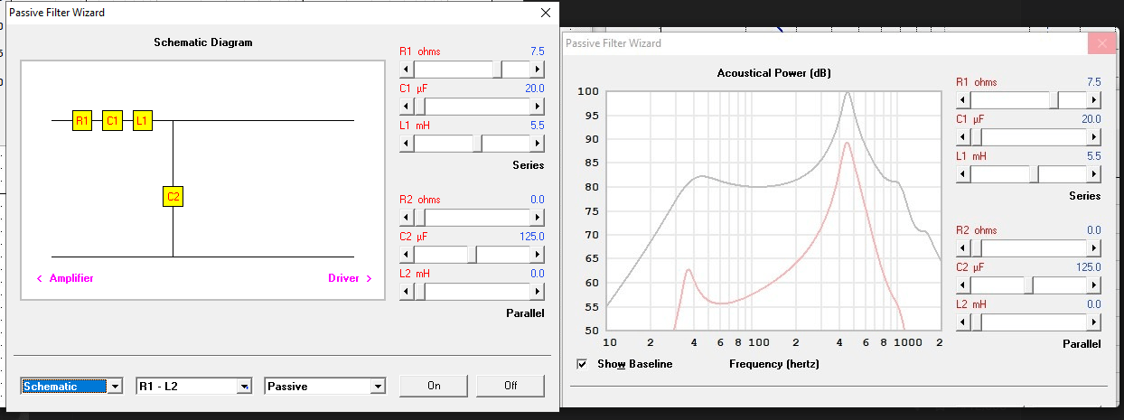

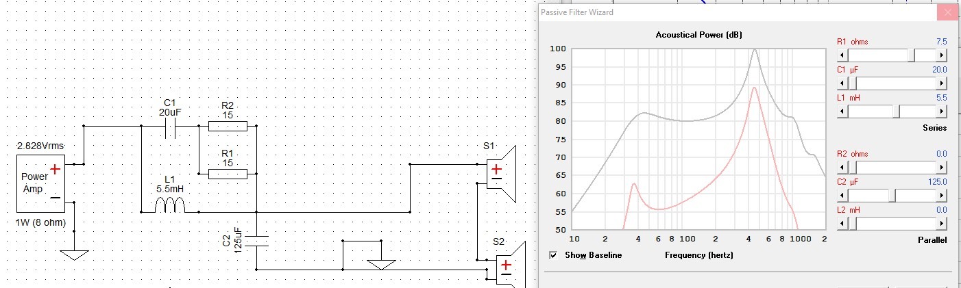

Does anyone use hornresp to simulate low pass filters? I've trying to duplicate the schematic on the left but things don't look right. Maybe I am entering in things wrong in Hornresp?
I suppose the "serial" values will all be calculated as series in a row. so you have a resulting impedance of L1+C1+R1 (as shown on hornresp-screen) attenuating the speaker. therefore the bass response is so low.
try only including value for L1 to and gradually increase R1 value to check the result.
I don't think you can simulate your entire crossover network in hornresp.

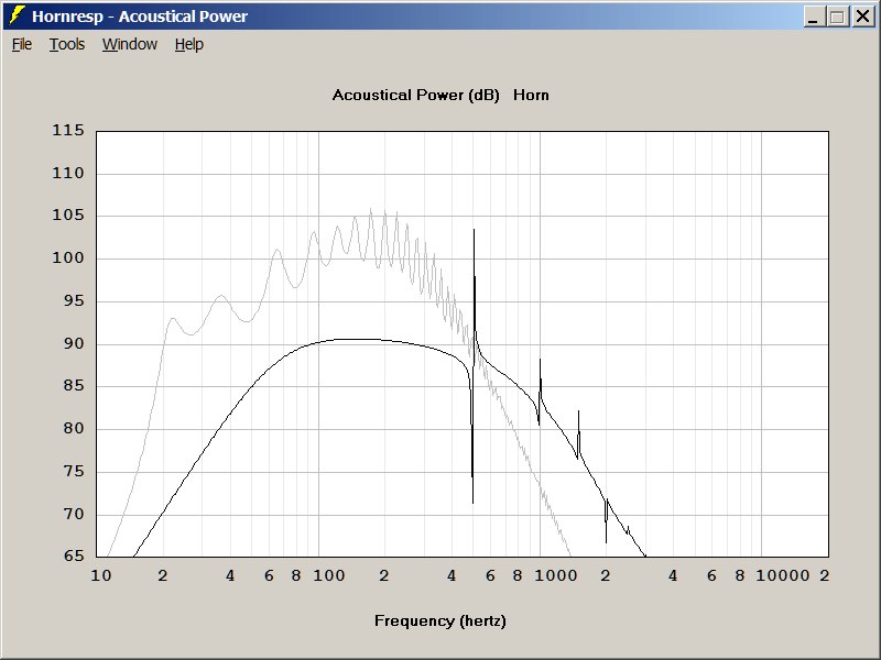

Hello everyone! Does anyone know how I put 2 graphs on hornresp to compare them (just like the picture)? thanks!
You cannot display two graphs like this as far as I can think through. You can export the data from the two graphs and use REW to view them at the same time. You have to export them as an FRD file and REW will be able to import them in that format.
Only on my phone at the moment so can't check exact locations but there is definitely an option to Capture Current trace then once you've called up you other record Display Captured to show them both together. Can't remember if it's in a right click contextual menu or one of the main ones though. A quick search of the helpfile for the terms I've capitalised will sort you out in no time though 😉
Thanks! :up: I really, really need to read the HELP File after every update! Search 'capture' for a bunch of options!
Oh are you guys teaching me something new? That Master McBean is a busy man.
So below is the fruits of my searches. Two different enclosures. A very looooong front loaded horn and a sealed subwoofer for a client of mine. Ctrl C on file one. Next up open the second file and calculate. to compare hit tools, Compare captured and you can see the two files. I didn't know that you could do this randomly. I do it consecutively regularly. File after file in order. Reading that manual always teaches me something new. Sorry for the misleading comment above.
