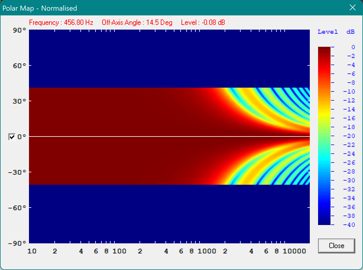

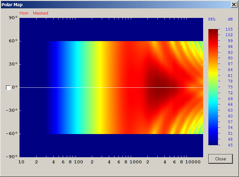

Hi all,
is there a way to adjust the db scale in the polar map view? Instead of running all the way down to -40db, I'd like to limit the bottom end to -25db...Is this already possible or something you could easily implement in the future?
Hi all,
If you mean this screen the answer is no. There is no way that I know of the alter the range.
Rather, I just want the from red to blue to represent from 0db to -30db, not 0db to -60db as displayed above.
If you click the check box marked 0° on the left-hand side to normalise the polar map to the axial response, then the magnitude scale changes to relative values, which seems to be what you want anyway? -30 dB is then pretty clearly marked:Rather, I just want the from red to blue to represent from 0db to -30db, not 0db to -60db as displayed above.
This is also the equivalent of equalising the on-axis response to be flat. Since that shows what can be fixed electrically with EQ or filtering, any issues such as side lobes are acoustic problems that can only be fixed with physical changes to the geometry. Therefore, it is generally more useful when comparing the directivity response of different horns or speakers.
I was trying to match the color scale of vituixcad...unfortunately it is not exactly possible but VituixCad allowed me to adjust scale to match near the -40 of hornresp but the colors were still not in sync.....of course this just an inconvenience

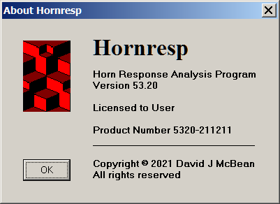

Bugreport: Since a long time, at least when simulating transmissionlines, Hornresp in Loudspeaker Wizard doesn't remember the filling settings correctly and segment change to "auto", after save/exit hornresp/start hornresp.

I am home today and I will try to see if I have the same situation. What version of Hornresp are you using?Hi all,
I created a simple simulation in Hornresp the latest version:Hi all,
The file was made, the stuffing was changed to roughly 4-600 grams and then the file was saved. I went back into Hornresp, opened up another file and then closed it. Returned to the transmission line file and re-opened it. The numbers are exactly the same.
Thanks for testing. I'm also on the latest Version, running honresp with "wine" on linux.
Within a session everything is fine, but if i close hornresp and reopen and navigate to that simulation(maybe it is failing as i have 50+ horns sumlations),
Tal1 is not the same anymore. Fr1 seems to be ok.
