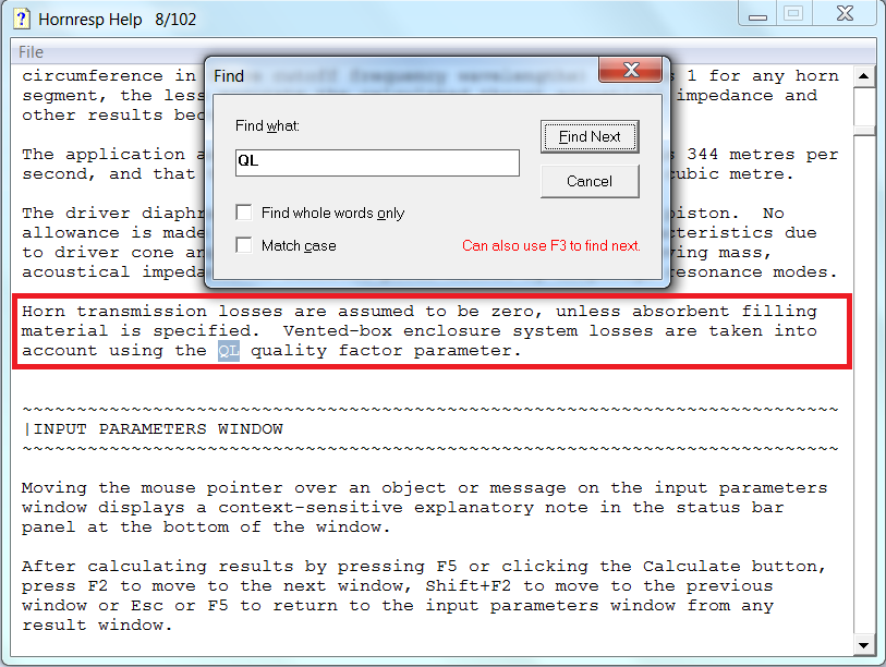

As far as I can tell, in HR I can only adjust QL in vented enclosures, it that correct? Or do I just not know where to find it? If it can be adjusted, are there rules of thumb for QL in types of enclosures other than vented boxes?
All Hornresp assumptions and features are documented in the Help file. Search for what you are looking for using the File > Find tool.

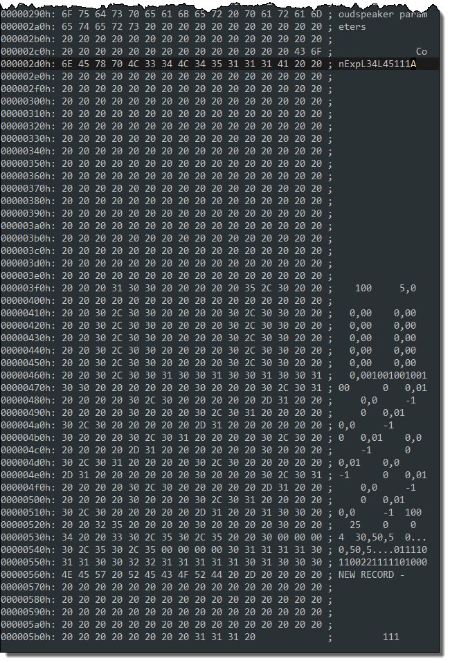

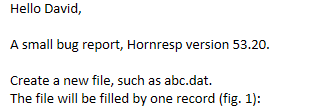

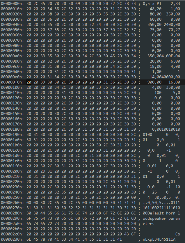

Hello David,
A small bug report, Hornresp version 53.20 :
Create a new file, such as abc.dat. The file will be filled by one record (fig. 1):
Open input wizard (F7) and then close it by a click on the upper right X.
Then you get this prompt:
Hornresp
Run-time error '94':
Invalid use of Null
OK
… and Hornresp vanishes.
The close apparently added a second but incomplete record (fig. 2):
You don't have to open a new file, any valid .dat file will be affected. This record will also cause a runtime error whenever you "scroll" forward towards the end of the file.
Trimming that record away works fine (record length = 734), but you need a (good) editor to do that. I was using UltraEdit.
I dare suggest to build in a little logic to auto-remove such bad records, by detecting the top block of spaces. There may be users around having such records in their files. (just a black thought of mine )
Hope this info helps,
Andre

Hi Andre,
Many thanks for reporting this bug, and for providing such comprehensive information. I have found the problem - it will be fixed in the next update. Trying to auto-remove bad records could be a bit tricky - it is probably safer to leave things as they are, particularly as record corruption is not normally an issue.

David,All Hornresp assumptions and features are documented in the Help file. Search for what you are looking for using the File > Find tool.
Thanks, I did not realize that function existed. Found the answer easily.
Eric
