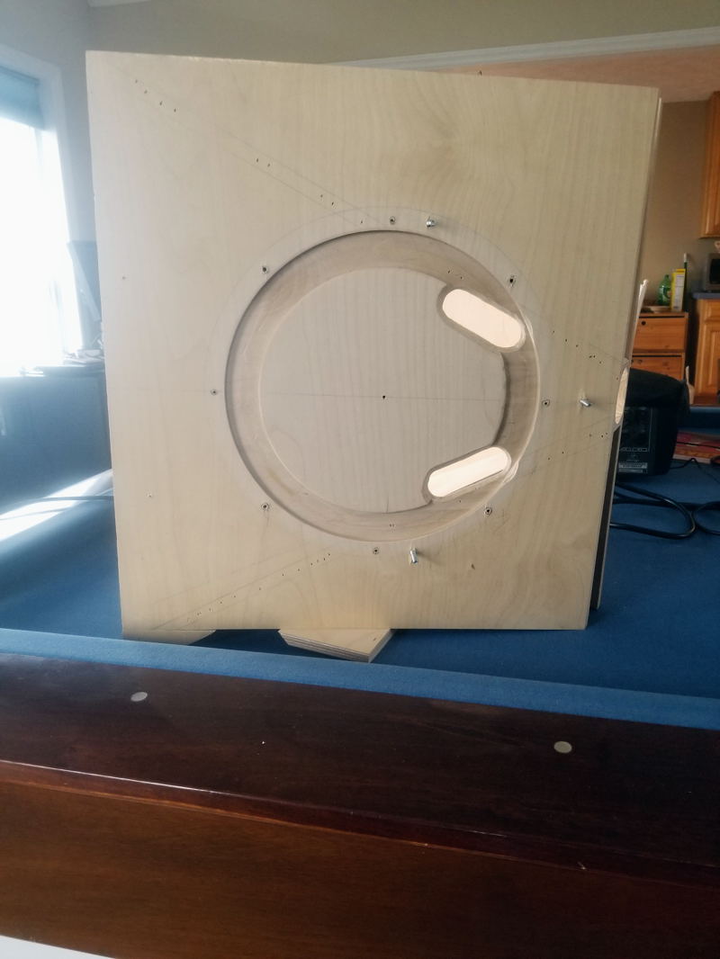

Pict below is one from beginning synergy tries...
I'm starting another synergy attempt...hopefully pretty mobile with a detachable secondary tractrix flare (ala k-402)

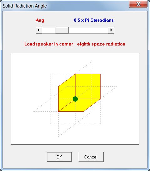

How is space being modeled? Is it possible to see the boundaries of the selected space in relation to the speaker/horn in schematic view? Perhaps you could sketch a few common scenarios to show the positioning in a 3D drawing to clear up whether the speaker/ horn is in front of the boundary, or does the boundary start at the mouth.
Extreme case: what if I want to knock out a hole in one wall near each bottom corner and put the horns in the adjacent room, with the mouth flush with the walls and floor? Now those horns are radiating into 1/8th space, but the boundary of the 1/8th space starts at the mouth, as the horns themselves are not in the room.
Thank GM, the exercise I'm working on is just a test jig, to help better learn how limited bandwidth drivers might behave jammed onto the walls of synergy horns.

How is space being modeled? to clear up whether the speaker/ horn is in front of the boundary, or does the boundary start at the mouth.
Strictly speaking, the boundary starts at the mouth, however for an actual practical horn loudspeaker, provided that the dimensions of the radiator and distance from the walls are small compared to the wavelength, the loading conditions will not be unduly compromised. This is why the classic Klipschorn bass corner horn design works so well.
The Hornresp simulation model assumes a point source, as shown in the attachment.
