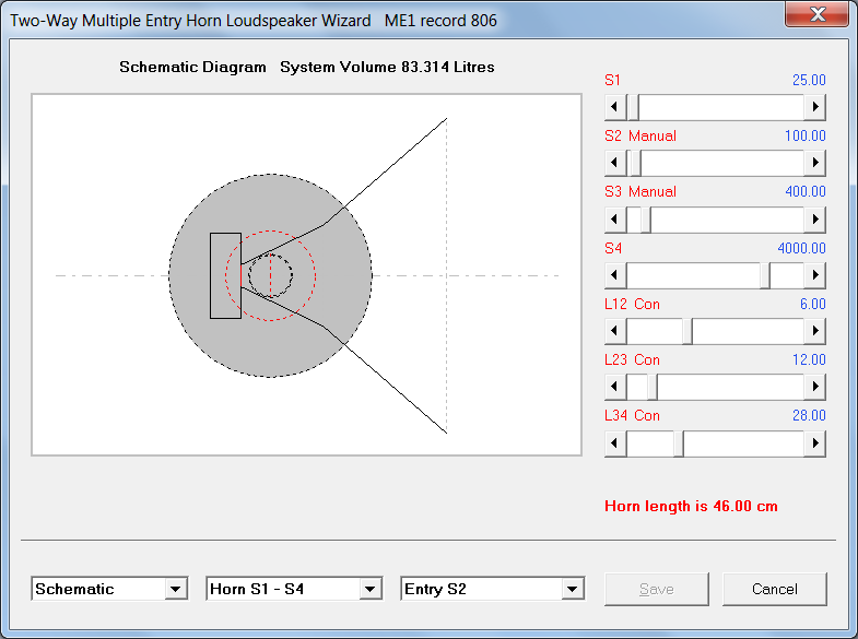

1. I'm not seeing the loudspeaker wizard for single segment exponential horn. Am I missing something or is that the way it is? If it is the latter, can we cheat by adding a 0.01 length second segment? This does allow the loudspeaker wizard to show.
That's the way it is.
Yes you can.

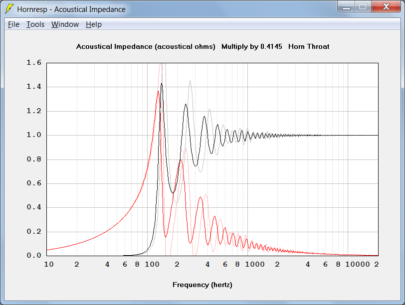

2. In the loudspeaker wizard, could we please get acoustic impedance as one of the results windows?
How would the acoustical impedance information be used in the design optimisation process, when already there are power response, electrical impedance, diaphragm displacement, phase response and group delay results to call upon?

Isn't the acoustical impedance indicative of how well (or not) the horn is coupling to the space outside the horn, or to adjacent stages in the case of a multi-segment horn? Reflections from the mouth will cause ripples in the acoustical impedance seen at the throat.How would the acoustical impedance information be used in the design optimisation process, when already there are power response, electrical impedance, diaphragm displacement, phase response and group delay results to call upon?
Quote from Introduction to Horn Theory - Bjørn KolbrekYou see that the value of mouth impedance will dictate the value of the throat impedance. As explained previously, there will usually be reflections at the mouth, and depending on the phase and magnitude of the reflected wave, it may increase or decrease the throat impedance. A horn with strong reflections will have large variations in throat impedance.
Yes, but the ripples in the throat acoustical impedance affect all the other results as well.

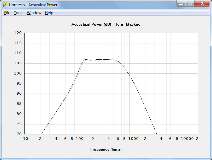

The throat impedance is of interest theoretically but is of limited use practically. Essentially all you need to know in the case of an exponential horn for example, is that for a given throat area S1 and flare cutoff frequency F12, the longer the horn, the lower will be the magnitude of the ripples, as shown in the Attachment 1 comparison. The light traces show the impedance for a 100Hz horn of length 90cm and the dark traces show the impedance for the same horn lengthened to 100cm. Obviously the longer horn has smaller ripples, but the chart doesn't really help much in predicting the relative performances of the two systems. Attachment 2 compares the power responses of the two horns, which is a more useful indicator of how they are likely to perform in practice.
From the example given it can be seen that the throat acoustical resistance can vary over wide limits without introducing large variations in the power output.
The acoustical impedance chart was included in the main results because the throat acoustical impedance characteristics of the various flare profiles used in horn loudspeakers can be of interest academically, but it was not considered necessary to also have the chart in the loudspeaker wizard.
IMHO the targeted end result is the same, but how one goes about achieving it is going to be different for different people. I like to think that if you can minimise the ripples in the acoustic impedance, you're going to get a better performing horn. Your approach works for horn designs that cover a relatively small frequency range, but try pushing the bandwidth further and you'll see the relationship between acoustic impedance ripple and overall response more clearly. That's my opinion, at least. I'm new to all this, so the likelihood of my being wrong is fairly high.

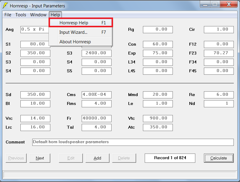

Hi zgtsang,
The Hornresp.hlp file is opened using the Help menu, or by pressing the F1 function key, as shown in Attachment 1.
Once opened it can be printed, or exported as a text file, as shown in Attachment 2.

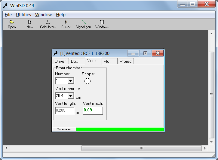

I am helping a friend simulating a large BR box using RCF L18P400. WinISD and Hornresp simulate quite differently. I let WinISD optimize a -3dB bass shelf. Box is 283 liter. Port is 327 square cm, 36.4 cm long.
Using a WinISD I get a tuning frequency of 28 Hz, SPL 119 dB with xmax at 38 Hz. Signal is 400 W.
Using Hornresp I get 123 dB SPL with a tuning frequency of 24 Hz. Xmax at 34 Hz. Signal i s 200W.
How can this difference be explained?

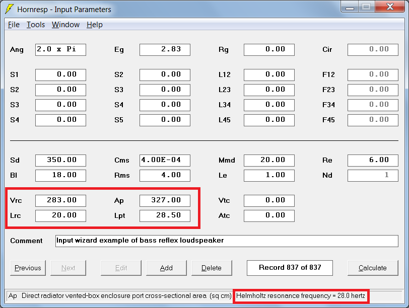

Not sure what version of WinISD you are using, but my old copy tells me that for a box volume of 283 litres, a tuning frequency of 28 Hz and a port area of 327 square cm, the vent length should be 28.5 cm, not 36.4 cm.
In Hornresp, for Ang = 2 x Pi, Vrc = 283, Ap = 327 and Lpt = 28.5, the Helmholtz resonance frequency is 28.0 Hz - exactly the same as for WinISD.
