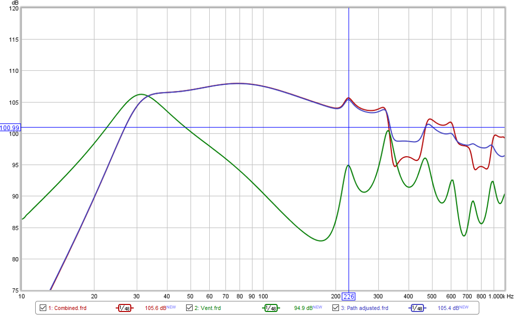

Not sure about 400Hz since the vent likely won’t have much output,
Attached is the predicted output from the vent of an MLTL that I designed using Hornresp (build here: The Subwoofer DIY Page v1.1 - Projects : The Boom Unit), There's a peak just above 300 Hz that's only 6dB below the vent's peak output, and about 1dB down from the driver's response at that frequency. From 226 Hz up, Hornresp is predicting that the vent output is going to have a noticeable impact on the overall response of the MLTL, with a big null centered around 400 Hz.
but if you are making measurements near the enclosure where distances (mic-to-vent) and (mic-to-woofer) have significant differences you will see differences in summation as you move around the enclosure. But, at low frequencies you will find that the power response is a better match for what you would measure in an outside ground-plane test at a typical listening distance of a couple meters.
Actually I expect the impact at 400 Hz to be more noticeable as the length of the "arc" that the nulling effect will be noticeable will widen. But one could argue that 400 Hz isn't really that "low" 🙂

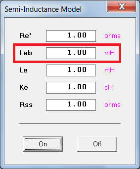

If "semi-inductance" is enabled, adjusting the driver's Le in the Loudspeaker Wizard makes no difference to the response curve.
That's because the semi-inductance model replaces Le and Re.
I typically do that at times to see what impact the inclusion of a series inductor might have on the system's response.
Increase the value of Leb to include a series inductor. This can only be done on the main input window though - not in the wizard.

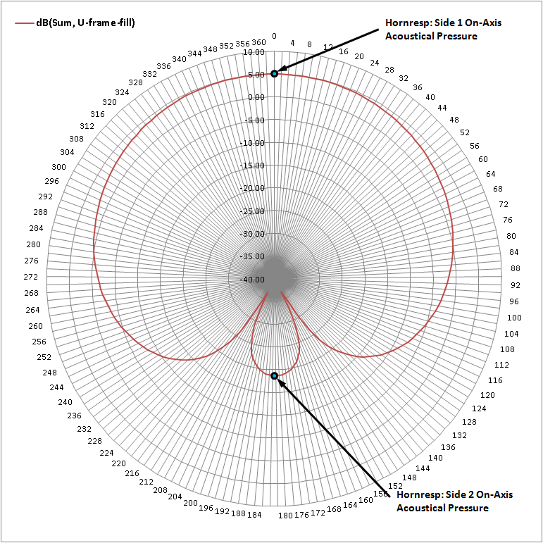

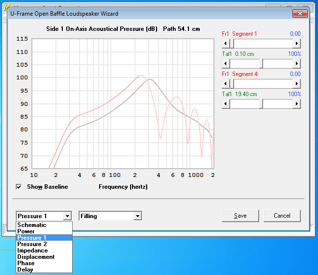

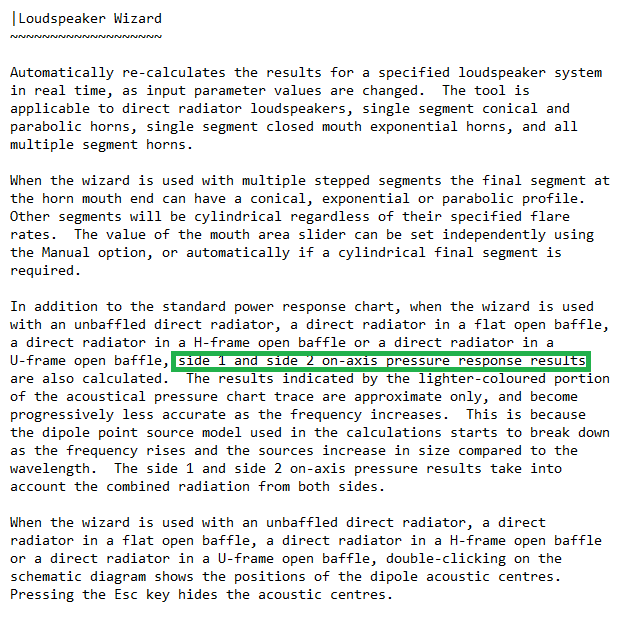

Aaah, OK. You are wanting to quantify potential impact of out-of-band noise from the port. This is certainly high enough in frequency where the complications of directivity and diffraction from source(size/shape) and enclosure(size/shape) have a significant impact on the validity of the simple “separated point source” model. In general you would want to introduce a minimal amount of damping material lining the walls or at the turn corners of the line to minimize the HF port output.… From 226 Hz up, Hornresp is predicting that the vent output is going to have a noticeable impact on the overall response of the MLTL, with a big null centered around 400 Hz… But one could argue that 400 Hz isn't really that "low"
Not to belabor the point, but Hornresp is NOT saying anything about the pressure response at different locations. It is telling you what the power response is, which is independent of listener location. If listening indoors, you could think of this as representative of the total acoustic energy exciting the room. Small response features localized to a specific listening angle don’t show up prominently in the RTA measurements.…if I designed this particular MLTL so that its vent was 1/2W @ 50 Hz separated from the driver and laid it facing upwards like in my previous illustration, the response at bass frequencies will differ significantly, depending on whether or not I took the measurements in front of or behind the speaker. But from what you're saying, Hornresp will indicate that the frequency response should be the same at both locations.
Your point concerning directional bass arrays for use outdoors is well taken. When Hornresp 5040 updated the Wizard for dipoles (H-frame, U-frame, flat baffle), the ability to plot on-axis pressure response on either side of the dipole was incorporated. I would have preferred to include a directivity polar plot for a selected frequency(see attached example for U-frame) rather than 2 on-axis pressure response points. But at the time, DMcBean felt it was not warranted and considered the 2 points a good compromise between providing useful information vs. complexity. Perhaps it might be revisited in the future if there is enough interest. Note that the bold portion of the pressure response curve is the portion of the curve where the point source modeling is considered appropriate/accurate.There are however examples of the low frequency outputs of two sources deliberately set a specific distance from each other to reduce output levels in one direction while increasing it in the other. End-fire subwoofer arrays for example. And the effect isn't only noticeable when the listening position is close to the subwoofers.
The LF directivity of, say, the Bose Wave Cannon could be similarly modeled, or any other compound source like an unwrapped version of your MTLT. Currently, if it is not of H-frame or U-frame geometry you would need to export magnitude/phase response for the individual sources and create the LF polar plot in Excel. I could clean up and post a version of my spreadsheet for doing this if there is interest.
