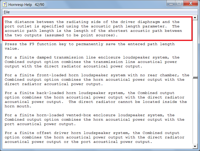

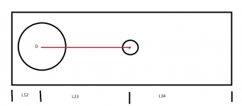

In most cases the path length is 0 since the port will be on the same side as the cone, the distance to the listener will be the same. Correct me if I am wrong.
Hi Mårten,
The acoustic path length is the length of the shortest acoustic path between the two outputs (assumed to be point sources). For your example, that means the length of the red line shown in the attachment, or in other words, the value of L23. It is not the difference in the distances from each output to the listener.
Kind regards,
David

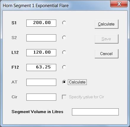

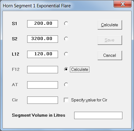

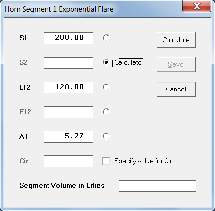

I meant that calculating after putting in other parameters should not allow the locked parameters to be altered.
Using your first example:
1. lock throat area and segment length to set values, and only allow the 'calculate' routine to change the other values (mouth area etc.).
Attachment 1 shows the settings required to "lock" S1 = 200 and L12 = 120 and allow the value of AT to be entered before calculating the other parameter values.
Attachment 2 shows the settings required to "lock" S1 = 200 and L12 = 120 and allow the value of S2 to be entered before calculating the other parameter values.
Attachment 3 shows the settings required to "lock" S1 = 200 and L12 = 120 and allow the value of F12 to be entered before calculating the other parameter values.
The are no other solvable input options for an exponential segment with S1 and L12 "locked". You can confirm this for yourself by studying the equations defining the geometry of an exponential horn.

Hi Mårten,
Kind regards,
David

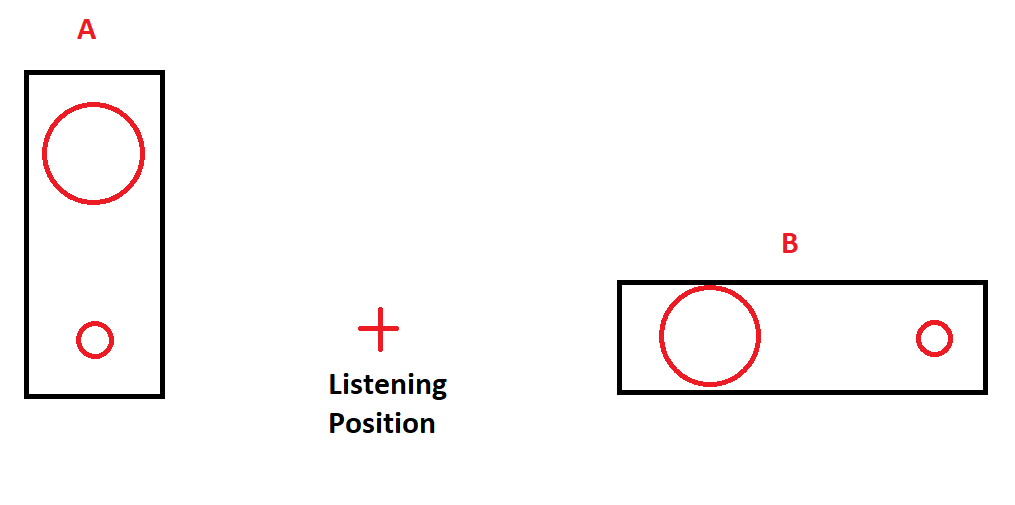

I'm trying to "wrap my brain" around this change, and the reason for it, and I'm not sure I get it.
Consider the following extreme example (see attached image). Say the drivers and vent in each box are separated by 1/2W @ 400 Hz, where the first vent resonance effect appears. Are we saying that the "path" information for them would be the same and therefore the predicted response from Hornresp would be the same?
Because I expect that they would measure very differently around 400 Hz at the given listening position, because the phase relationship between the two sources would be different at that position.
…Are we saying that the "path" information for them would be the same and therefore the predicted response from Hornresp would be the same?
Yes. The power response for both examples is the same. Power response is not dependent on mic position, as it is in essence a summation of all mic positions on the surface of a sphere(or part of a sphere) around the sources(which are considered to be point sources). This is no different than how Hornresp calculates acoustic output for individual sources(ie point source power response). DMcBean will likely have some additional comments on why Hornresp was developed as a power response calculator.
…I expect that they would measure very differently around 400 Hz at the given listening position, because the phase relationship between the two sources would be different at that position.
Not sure about 400Hz since the vent likely won’t have much output, but if you are making measurements near the enclosure where distances (mic-to-vent) and (mic-to-woofer) have significant differences you will see differences in summation as you move around the enclosure. But, at low frequencies you will find that the power response is a better match for what you would measure in an outside ground-plane test at a typical listening distance of a couple meters.
