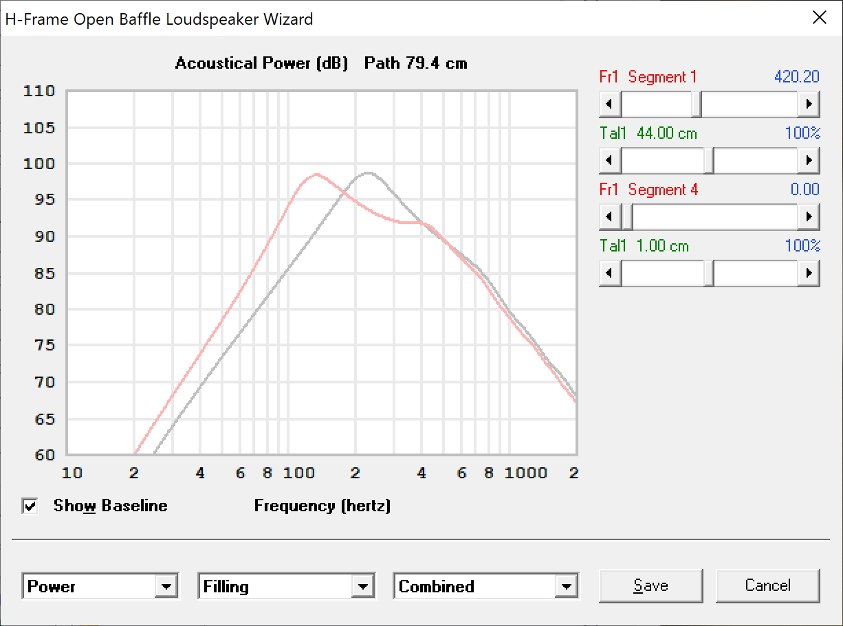

I've been having fun with HR all week designing twin BP4's for 2 Parts Express' GRS 12SW4's. I've modeled Nd, Nd with closed front, OD, and BP4 functions. HR is addictive! I'm thinking of painting them orange like NFL scoring pylons. I got a new 3 piece sectional for the man cave and I want some end table subs.

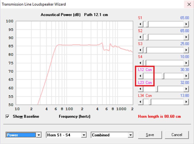

Try simulate with damping material. Fill the closed end of the pipe up to the speaker.
Hi Mårten,
I think Bambinz is already doing that - notice how the L12 and L23 slider labels are coloured pink, not red. This signifies that the first two segments contain absorbent filling material.
Kind regards,
David

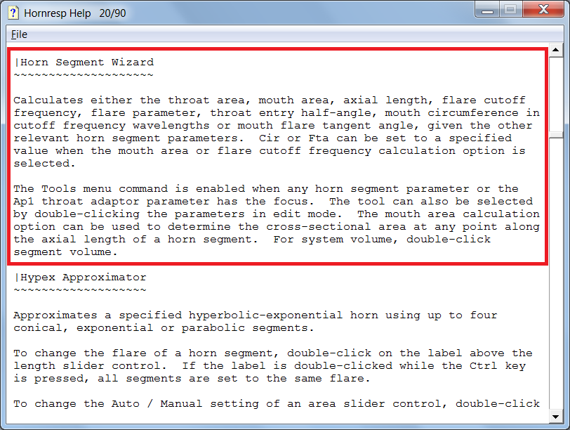

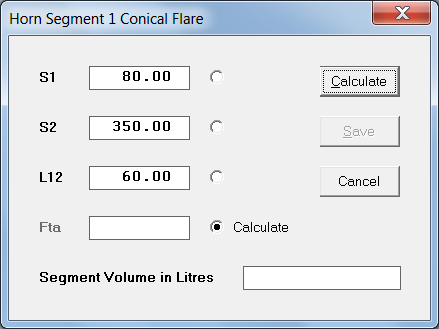

Could we get a status bar at the bottom for the various calculator windows as well? Maybe some tips on what the parameters mean and how to use the calculator?
The parameters mean the same as they do on the main input window. Moving the mouse pointer over a parameter on the main input window displays a description in the status bar panel at the bottom of the window.
Information regarding the Horn Segment Wizard is provided in the Help file. The option button simply selects which particular parameter value is to be calculated, given the other parameters as inputs.
Attachment 1 shows the default option for a conical segment - given S1 (throat area), S2 (mouth area) and L12 (axial length), pressing the Calculate button will calculate Fta (horn mouth flare tangent angle).
If you want to specify a conical horn segment but only know the throat area, axial length and flare tangent angle, you would click the option button alongside the S2 input text box, then press the Calculate button to calculate the required mouth area, and then press the Save button to transfer all values to the main input parameters screen.

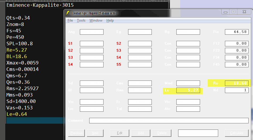

Could it be that "Paste Driver from Database" copies the values from the .txt file by line position (order), rather than by matching label value? See attachment.
Some other parameters may be affected as well.
I did edit the .txt file on purpose, that much is true.

I suspect that Hornresp does not use the built-in ReadPrivateProfileString() and GetPrivateProfileString() functions to read values from those files . Something I ran across when trying to "enhance" them to include more data about the driver, e.g. the physical dimensions and cone displacement.
Hi Andre,
That is exactly what Hornresp does. Anything to the left of the equals sign "=" on each line is simply ignored. For this to work though, the driver parameters need to be listed in the correct order in the file.
To illustrate - you should find that the values in the attached Driver file paste correctly, even though the labels have been masked.
Kind regards,
David
I suspect that Hornresp does not use the built-in ReadPrivateProfileString() and GetPrivateProfileString() functions to read values from those files.
You suspect correctly .
Hornresp only uses standard Visual Basic 6 functions, statements and methods. ReadPrivateProfileString() and GetPrivateProfileString() are not VB6 functions.
That is a dangerous thing to do .
Driver files should always be created or edited using the Hornresp 'Copy Driver to Database' menu command.

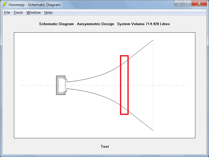

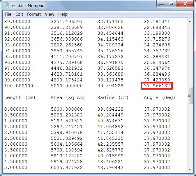

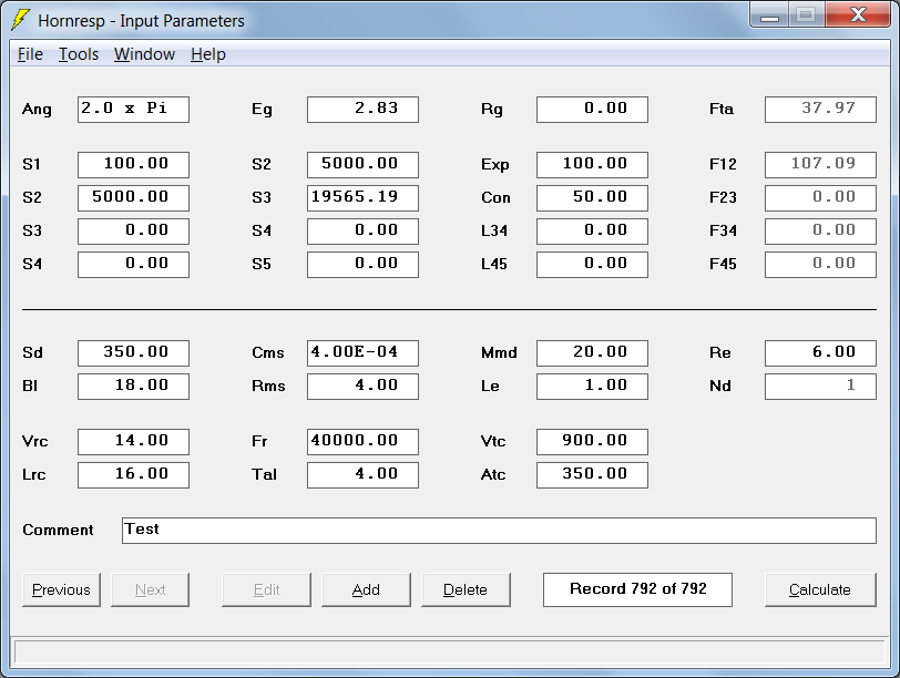

Regarding multiple segment horns:
The mouth area of the first segment is equal to the throat area of the second segment, and the mouth area of the second segment is equal to the throat area of the third segment, and so on. This is great. However, for a smooth transition from one segment to the next, one would like to have the same done for the exit and entry flare angles as well, e.g. the Fta of the first segment should be equal to the AT of the second segment, and so on. Any ideas on how to achieve that? How to get the Fta of the first segment?
If the first segment has a conical or parabolic flare then the mouth Fta can be calculated directly using the Horn Segment Wizard, as shown in Post #10403. If the first segment has an exponential flare then the mouth Fta cannot be calculated directly using the Horn Segment Wizard, as Cir is given instead. If the values of S1 and S2 are swapped in the Wizard however, the mouth Fta will be the negative of AT.

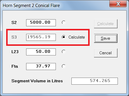

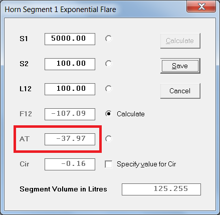

To illustrate, assume for example that we want to match a conical segment of axial length 50 cm to an exponential segment having S1 = 100, S2 = 5000 and L12 = 100 as shown in Attachment 1.
Using the Horn Segment Wizard, the mouth Fta (negative of AT) of the exponential segment is calculated to be 37.97 degrees, as shown in Attachment 2. This value can be confirmed by exporting the horn data, as shown in Attachment 3.
The throat area of the conical segment is the same as the mouth area of the exponential segment, the axial length is 50 cm and the required Fta to match the exponential segment is 37.97 degrees. The Horn Segment Wizard can be used to find the required mouth area of the matching conical segment, as shown in Attachment 4.
Attachment 5 shows the two matched segments.
I will look at the possibility of changing the Horn Segment Wizard so that in the case of an exponential segment, Cir can be toggled to directly calculate Fta instead, if required.
I was creating a new record for the first segment alone, which would give me the Fta
Hi SamAnytime,
That still won't give you the mouth Fta for an exponential segment, unless you export the horn data.
The Horn Segment Wizard will be changed in the next update so that for an exponential segment, either Cir or Fta can be specified / calculated.
