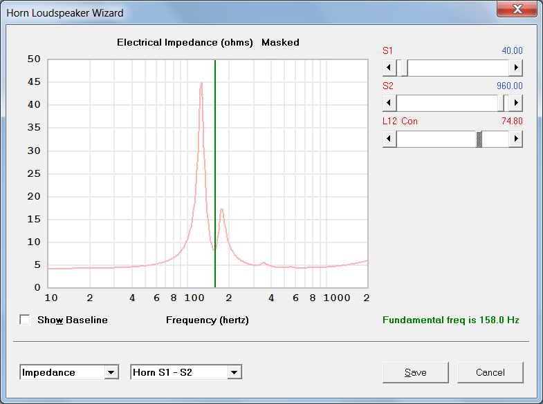

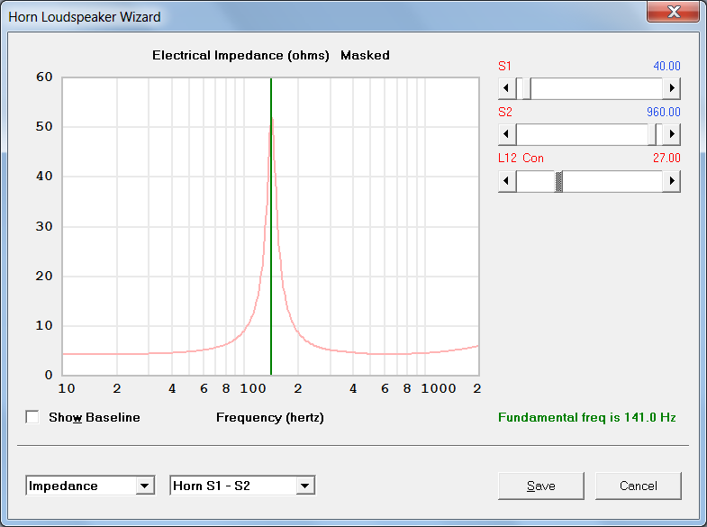

CHANGE

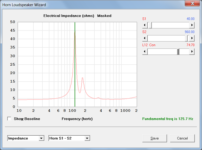

The resonance frequency issue reported by Giri in Post #10353 and followed up in Post #10370, has now been fixed.
Note that while "false positives" triggering erroneous frequencies can no longer occur, it is still possible in some circumstances for the resonance frequency to "jump" when a slight alteration is made to an input parameter value. This now only happens at the critical crossover point where the loudspeaker system transitions from exhibiting the characteristics of a parallel resonant circuit (high impedance at resonance) to one exhibiting the characteristics of a series resonant circuit (low impedance at resonance). This step-change is to be expected, and is not caused by a bug.
To illustrate the behaviour, the attachments show how the resonance characteristics transition for a given test example as L12 is increased from 27.00 (parallel) to 98.00 (series), with the crossover or "jump" occurring at the point where L12 changes from 74.70 to 74.80.
My thanks to Giri for reporting the resonance frequency issue.
Kind regards,
David

Hi Mazza,
Just to clarify - the step-change is to be expected only in the context of how Hornresp determines the theoretical resonant frequency. Your guess is as good as mine as to what actually happens to the system resonance during such an impedance transition, in a real loudspeaker 🙂.
Kind regards,
David
