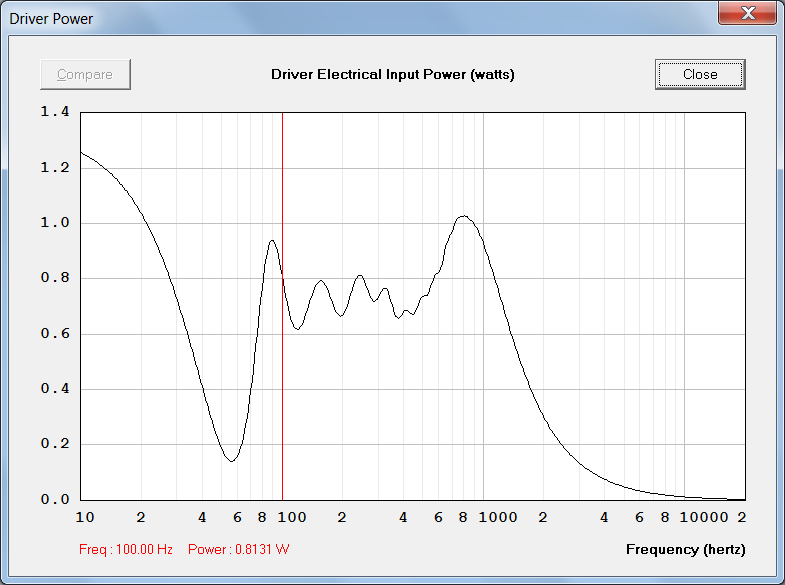

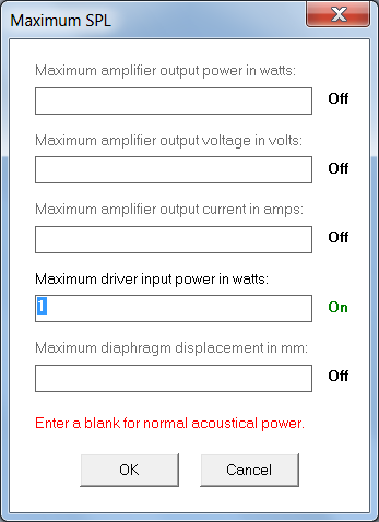

Therefore to know the power I should use the Eg voltage and the impedance graph
Hi Bambinz,
It's even easier than that - Hornresp will do it for you 🙂.
From the Acoustical Power chart window simply select menu Tools > Driver Power. Attachment 1 refers.
If for some reason you want to specify a constant power input rather than a constant voltage input, then the Maximum SPL tool should be used. Attachment 2 shows the setting required for a constant 1W input at all frequencies.

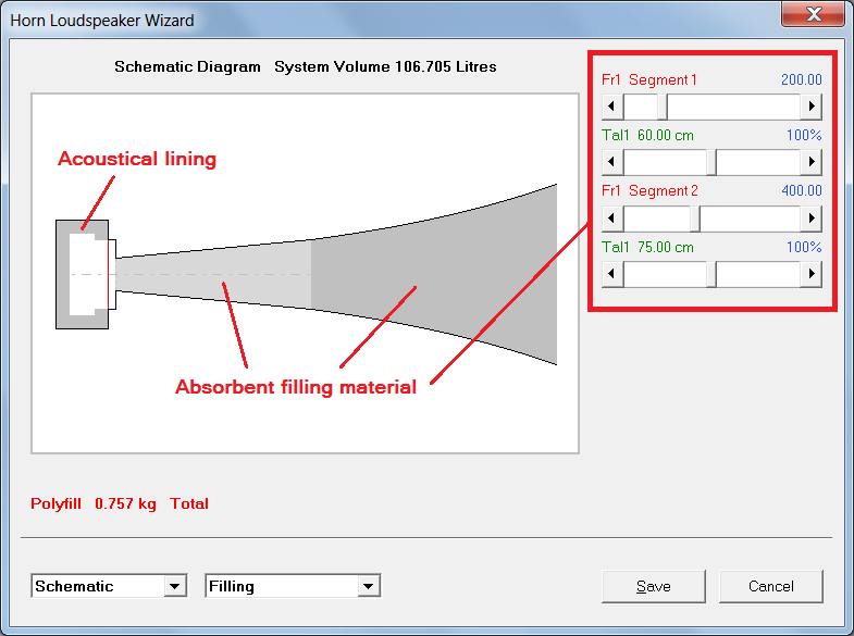

Hi SamAnytime,
I had assumed everything on the 'input parameters' window would be used in the calculations.
You assumed correctly, everything on the Input Parameters window is used. However the absorbent filling material parameters are not included on that window - they can only be accessed from the Loudspeaker Wizard, as shown in the attachment. (Fr and Tal on the Input Parameters window specify acoustical lining, not absorbent filling material).

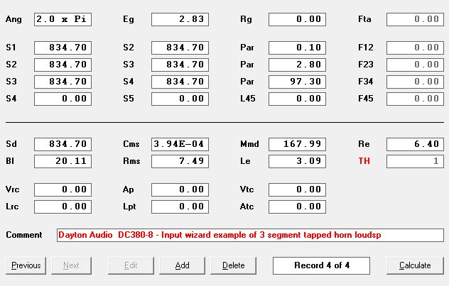

A question, is it possible to insert more than 4 segments? Because If I want simulate for example the Baby Labs of Woden Design I must insert 3 segment of different cross-section and in Hornesp is necessary to add a conical interface to put segment with different cross-section, therefor in necessary to add 3 segment + 2 conical interface = 5 segment.

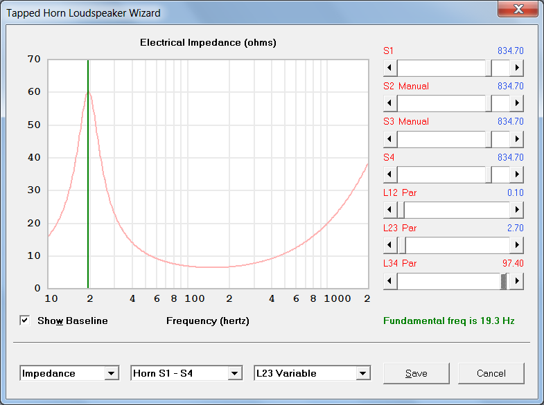

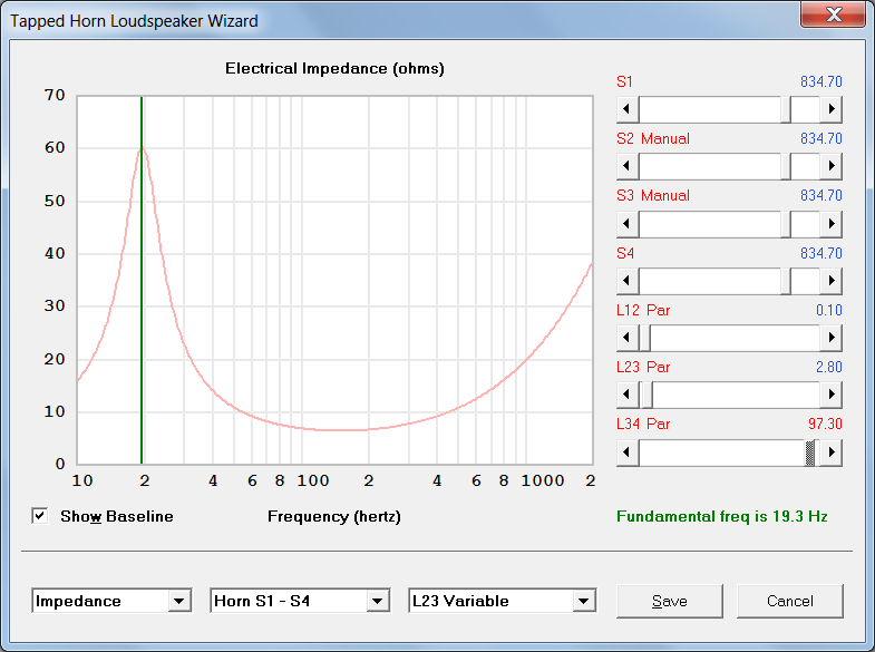

I have found the problem, and it will be fixed in the next update. The fundamental resonance frequency for your test design should actually be 249.8 Hz for both 46.8 and 46.9, as shown in the attachments.
Many thanks for reporting this issue. Even though it only occurs in extreme cases (the horn throat in your design is less than 4.7mm in diameter) the problem still needs fixing - I doubt that I would have ever found it myself 🙂.
Kind regards,
David

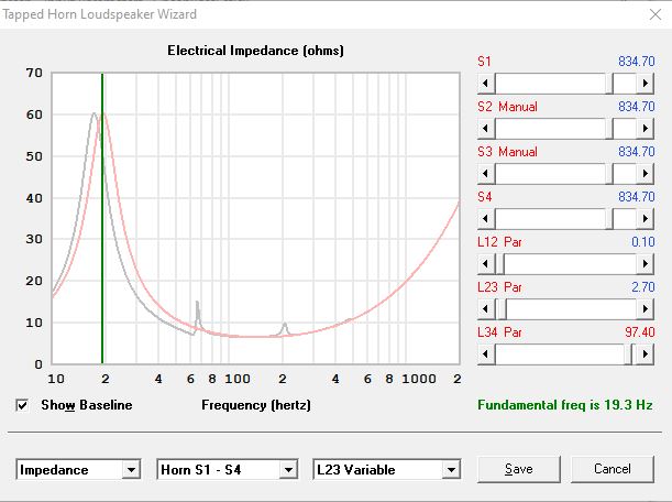

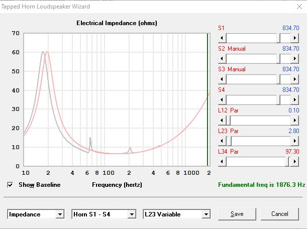

Hello David,
I found similar behavior in reported resonance value within 1mm of column length in a tapped horn simulation. I am using the updated version. Hope this helps.
Giri

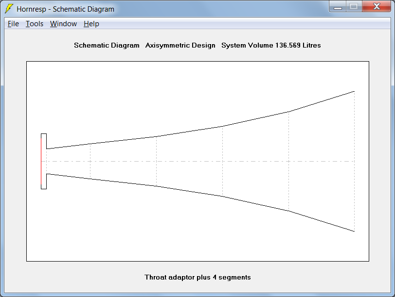

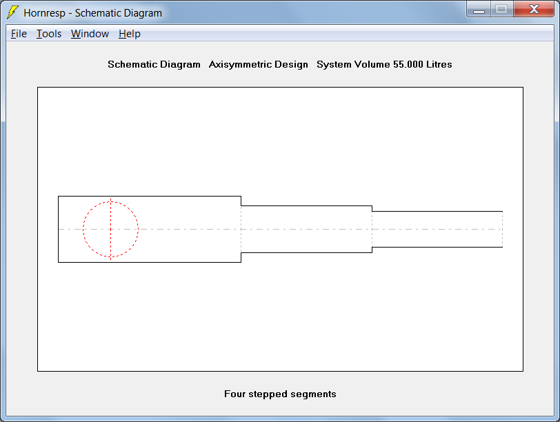

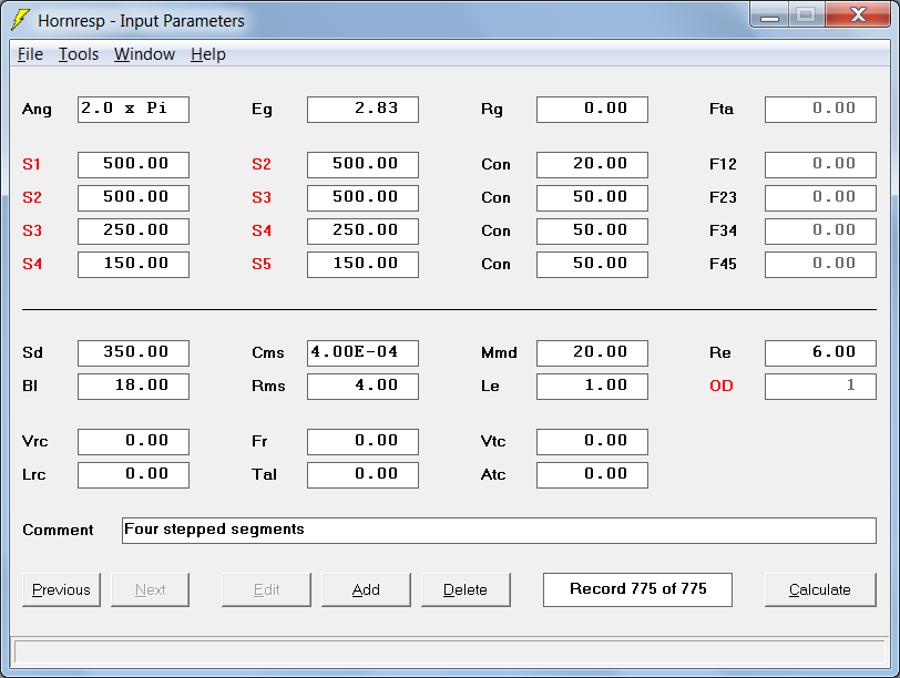

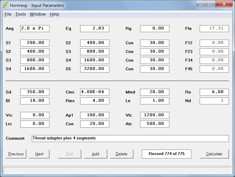

Hi Bambinz,
It is possible to get in effect five segments, by also including a throat adaptor as shown in Attachments 1 and 2.
For the Baby Labs design though, I would probably use the offset driver (OD) option and specify stepped segments, as shown in Attachments 3 and 4.
(To specify stepped segments, double-click on any one of the S1 to S5 labels in edit mode - the labels will change colour from black to red).
Kind regards,
David

Hi Giri,
Thanks for this second test example, it helps me to check that the proposed fix works with all loudspeaker types. The correct results for your TH design are as shown in the attachments.
The "next update" has not been released yet, which is why you are still getting the strange results.
