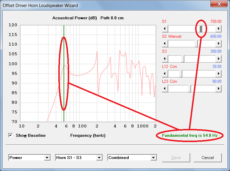

Hornresp Update 5050-200102
Hi Everyone,
CHANGE
The loudspeaker wizard fundamental resonance frequency value can now be continuously displayed while adjusting the physical dimensions of a loudspeaker system, without the need to constantly move the mouse pointer over the chart green vertical marker line to re-show the value. Attachment 1 refers.
This change was requested by Giri in Post #10312.

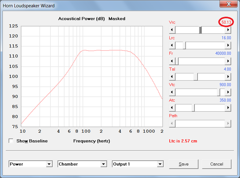

2. In the Loudspeaker Wizard, is there a 'fine control' for the sliders? E.g. if a click advances the Vrc slider by 0.1 liters, a click with the SHIFT key held down should advance it by 0.01.

Hi SamAnytime,
Rather than using the Maximum SPL tool in this case, simply make your adjustments in the loudspeaker wizard while viewing the diaphragm displacement chart. If Xmax is 5 mm (for example) then the objective would be to keep the displacement below that value over the frequency range of interest. You can observe the effect of your adjustments as you go.
While not necessarily obvious to the user, the algorithms controlling the operation of the sliders are already extremely complex, and introducing another level of (adjustable) precision is simply out of the question at this stage.
If you wish to see what the results are doing between say 50.10 and 50.20 litres (for example at 50.13 litres) then when the Vrc slider has the focus, simply key in 50.13 and press Enter. The attachment refers.

Is it too much work to change this so that the limits (especially displacement) are shown by straight lines, and the portion of the graph that crosses the limit still be drawn, but shown in a different colour to indicate that it is illegal and needs to be fixed?

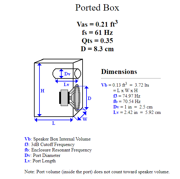

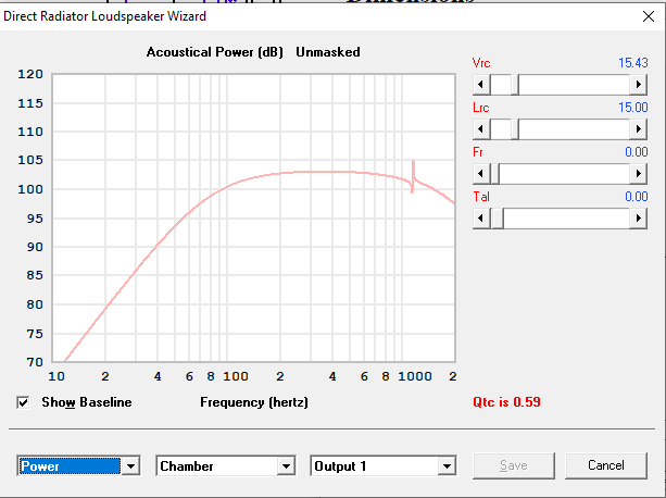

Ported loudspeaker box modelling
David,
I'm using your programme but unsure about how to add a vent port in the Loudspeaker wizard. This is what I did:
Loaded driver details
Selected rear lined driver
Added Lrc, Vrc values I calculated/guessed
But could not add the port length and diameter to the module.Can you pls help?

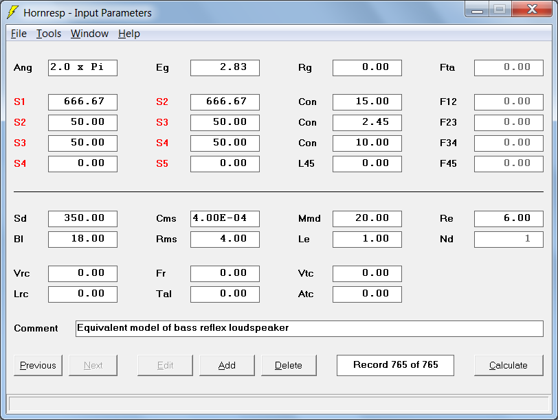

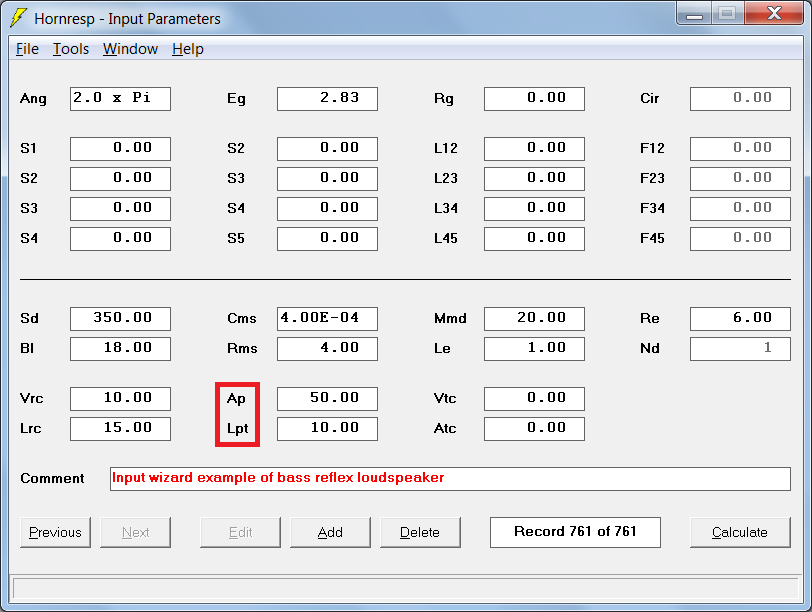

Hi Atiq,
The easiest way to specify a bass reflex type loudspeaker is to use the Input Wizard (accessed from under the Help menu) to generate a representative example, and to then change the input parameter values to suit the specific design. Attachment 1 refers.
In your case, because you are already nearly there, simply double-click on the Fr label on the main input parameters screen when the record is in edit mode, to change Fr and Tal to Ap and Lpt. Alternatively you could select the Rear Vented rather than the Rear Lined option from the Chamber Type menu, as shown in Attachment 2. Use the 'resonances masked' option (selected from the Tools > Options menu) if you wish to suppress the enclosure resonances.
Ap is the port cross-sectional area and Lpt is the port tube length.

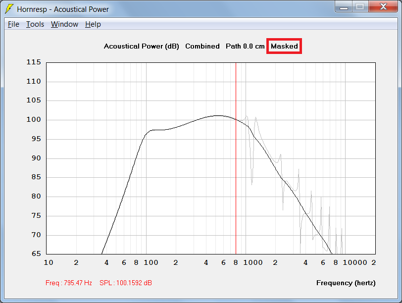

Masking vs unmasking
David,
What are the differences between resonance masking and unmasking? Unmasking is more realistic? Is it possible to add insulation using the wizard for a ported speaker box ?

When the 'resonances masked' option is selected, the enclosure chamber is modelled as a simple acoustic compliance (this is the model used in most standard "box" type simulation programs). When the 'resonances not masked' option is selected this simplifying assumption is not made, and a more rigorous model is used that shows the higher frequency chamber resonances caused by reflections from the back of the cabinet (opposite to the rear side of the driver).
If the actual built loudspeaker is going to have a lined chamber then the 'resonances masked' option can be confidently used for the simulations. If the actual built loudspeaker is going to have an unlined chamber then it is perhaps better to use the 'resonances not masked' option for the simulations. At the lower frequencies there is effectively no difference between the two models. In Attachment 1 the dark trace shows the response of a simple bass-reflex system with resonances masked and the light trace shows the response of the same system with resonances not masked. The traces are effectively identical below about 800Hz.
