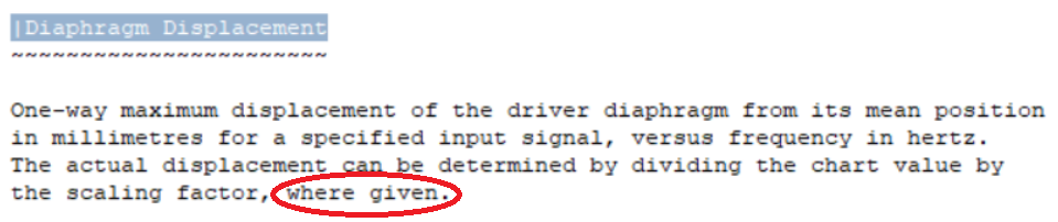

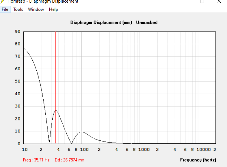

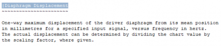

Hi Can anyone help with this. I have a reflex design that creates high excursion well over the xmax. In the help it says to divide the chart value by scaling factor. Is this somethign I have to do? and what is the scale factor?

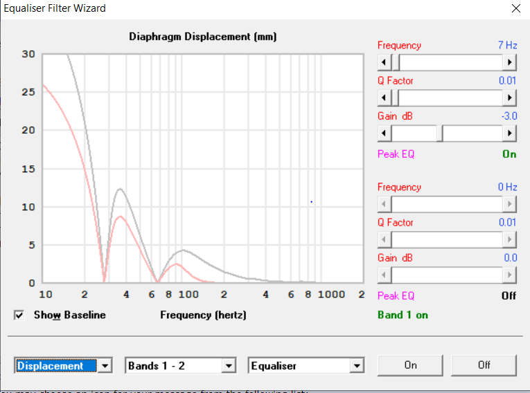

I want this design to work but with excursion like this I have to under power the driver to keep within the xmax.

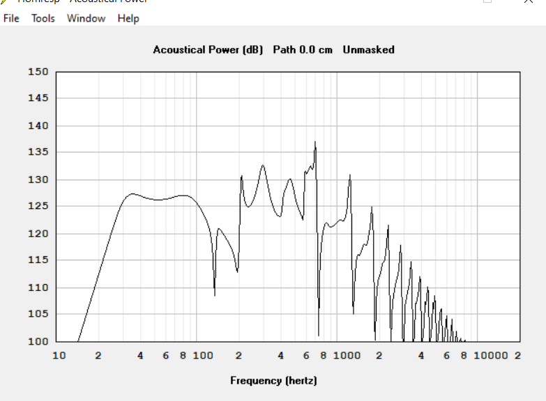

This is the displacement chart with 1200w @ 8ohms Driver Program power is 1200w driver's xmax is 8mm
Eg = 113.14
Many Thanks. I have built the cab already and testing different drivers. The excursion is too much! How can I fix this?
Eg = 113.14
Tune the box higher by reducing the port length.
Ive already built the cab and really wanted to keep the design. I know the free air creates high excursion. Wanted to understand the diaphram displacement chart data and if there was any hope.
I can under power the driver to fix it but I wanted to undrstand "why" and "when" displacement chart data is divided and "how". Hoping that woud be the solution to getting more power.
The scale factor is shown in the chart when the excursion is very low. There is no scaling factor shown in your chart.
Damn. Thanks for clearling that up mate. Looks like im having to put 300w through a high powered driver to get it down. It will create 120db at 30hz though. Trying to decide if it's worth it.

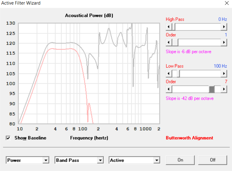

You can fix it with an external active filter. To see the effect, go into the Loudspeaker Wizard and select the "memory and width" , then select "filter", and then add a filter HP@20hz (or 30Hz) 2nd or 3rd order. It will reduce the excursion by reducing the voltage at VLF (<30Hz) where the driver gets unloaded.
Thanks bud. Im aware of the filter wizard but I wanted to keep the flatline frequency response. Im just going to under power the driver I think. Here is the freq response with a low pass filter on and a EQ for gain reduction to keep within the xmax, 390w @ 8ohms Power.
Good advice though it did help having a steep slope but wasnt enough. 🙁
Thanks though, I think the problem is between 30hz and 40hz
You need a HP@20Hz.
What I see in your settings (LP+EQ) won't help.

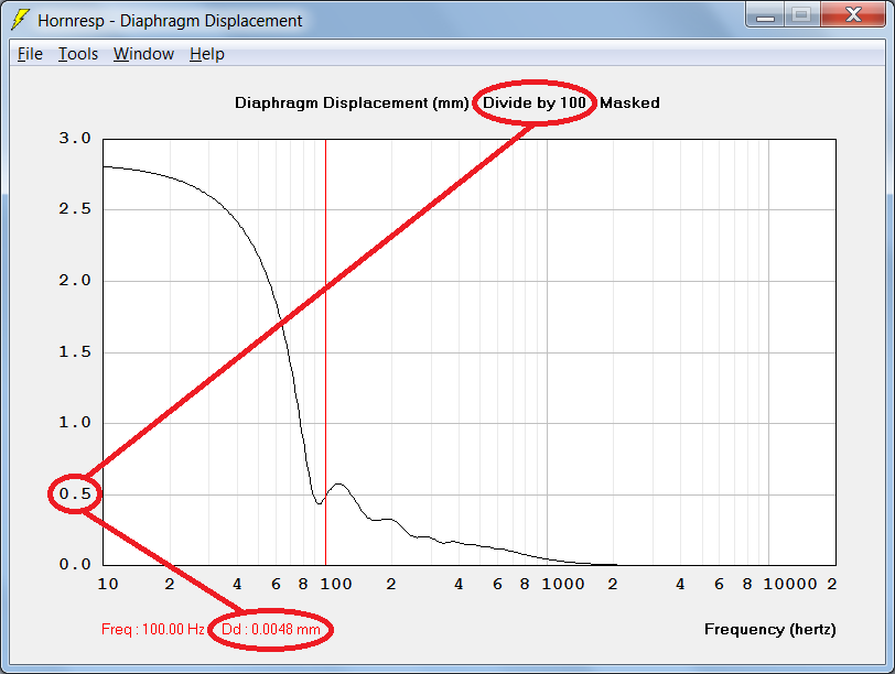

By way of further explanation...
The key words in the Help file notes are: "where given" - see Attachment 1.
A scaling factor is used when required to ensure that the Y-axis values on the diaphragm displacement chart never exceed 3 characters in width. In Attachment 2 the value taken directly from the chart at 100 Hz is 0.48, but the actual displacement is the chart value divided by 100, giving 0.0048 mm, as shown in the sample result.
