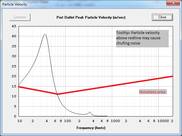

I thought about something simple and useful like add "reference line" at port outlet particle velocity chart that may help user to evaluate the design regarding potential noise.
See the example below. You could also add tooltips in some cases to guide users.
Thanks for the clarification.
If someone can provide me with the equation to use to plot the limiting "reference line" particle velocity for a single, circular, unflared port tube, as a function of frequency and port diameter, then I can certainly have a look at doing something with it.
User Collo did the flare it tool if I'm not wrong. It's in VB6 ^^. Maybe should he give you all you need. I use hornresp with Flare-it tool as guideline for port sizing.
If I'm not wrong he still come and recently wrote on diyaudio.

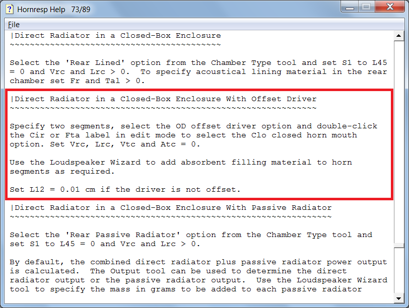

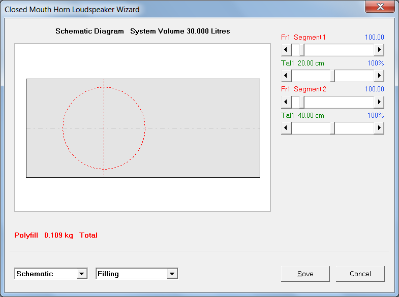

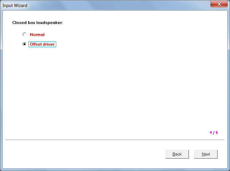

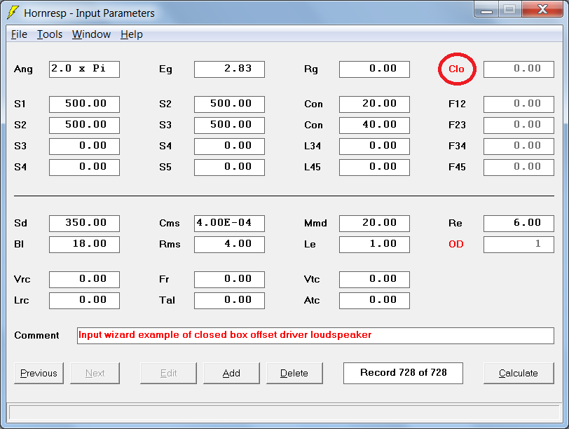

Dear Mr. McBean,
I have looked and I cannot find WHAT a closed box with offset driver enclosure is.
Could you direct me to where this is explained?
I assumed it was simply a closed box with the driver not mounted in the middle of the baffle but the model seems to suggest something more than that.
Let me know, please.
THANKS and take care,
Hi Rick,
See the 'Direct Radiator in a closed-Box Enclosure With Offset Driver' entry in the Loudspeaker Models section of the Help file for details. Attachment 1 refers.
The easiest way to specify a 'closed box with offset driver' is to use the the Input Wizard to generate a representative example, and to then change the input parameter values to suit the actual design. The Input Wizard is accessed from under the main input parameters window Help menu. Attachment 2 refers.
The input parameter values for the Input Wizard representative example are shown in Attachment 3. Note that the Clo 'closed horn mouth' option (circled in red) has been specified.
If required, absorbent filling material can be added to the enclosure using the Loudspeaker Wizard, as shown in Attachment 4.
The driver is mounted in the middle of the baffle on one axis, but not on the other. To illustrate, in Attachment 4 the driver is centred on the vertical Y-axis but offset on the horizontal X-axis.
Kind regards,
David

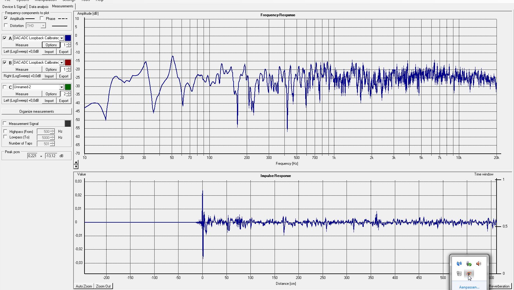

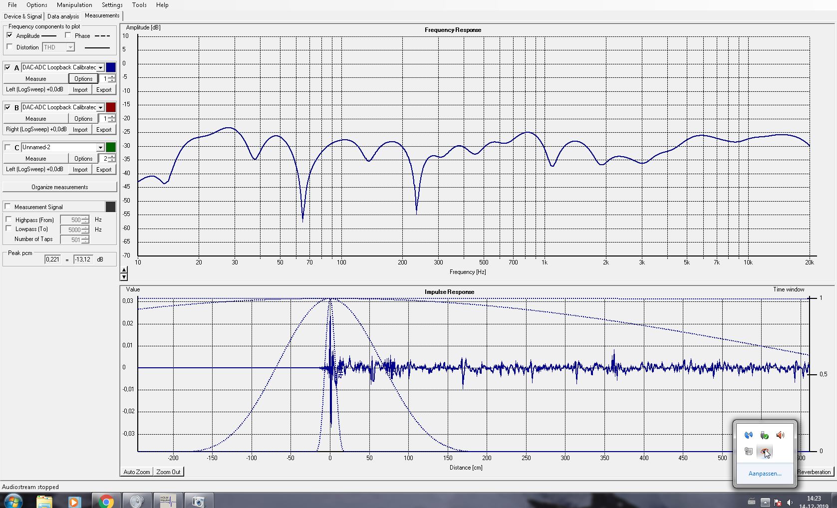

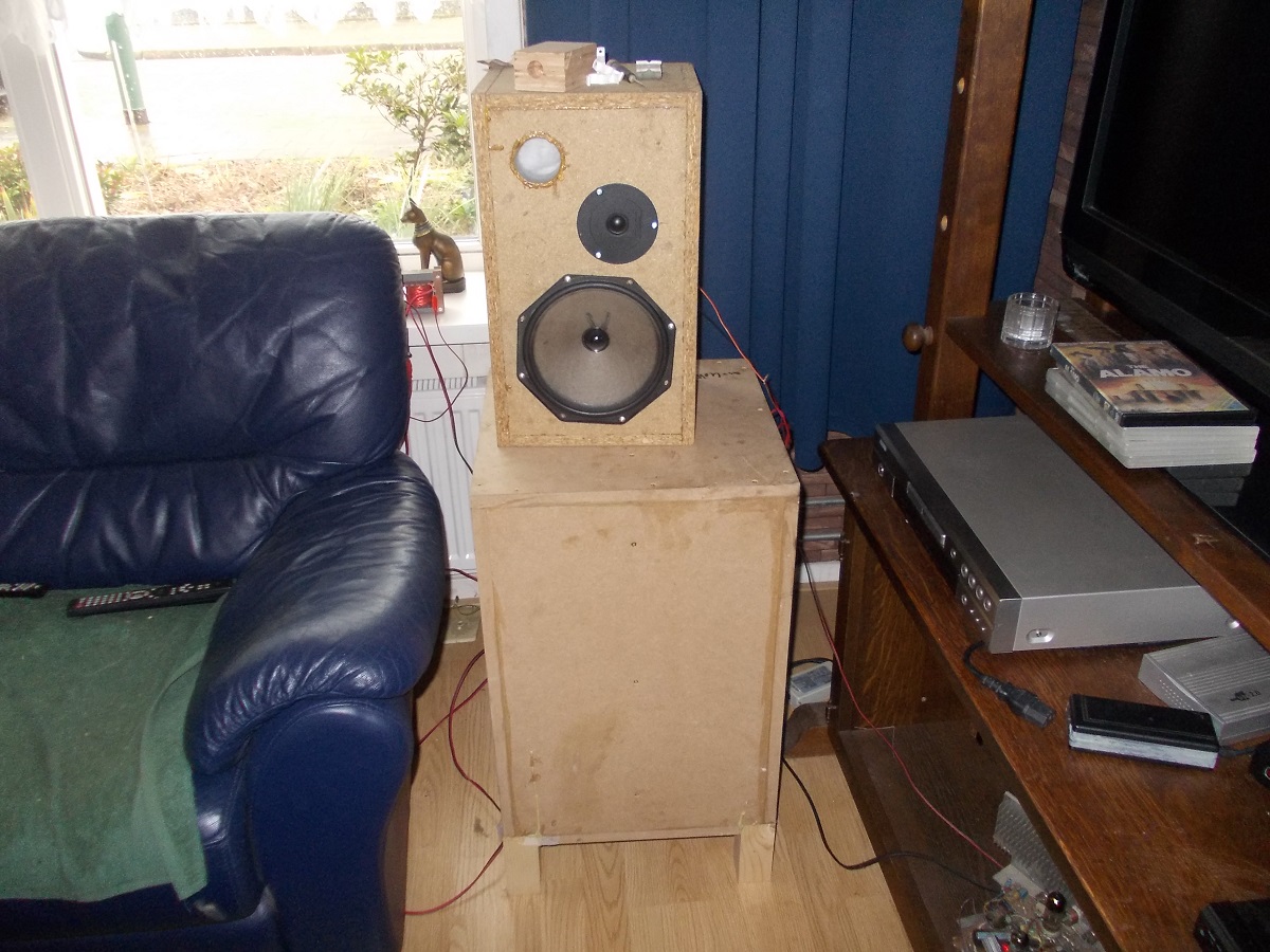

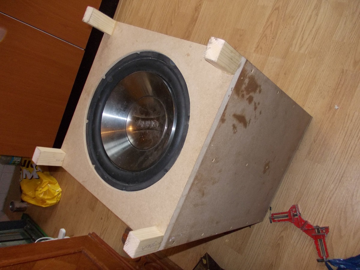

Hi All
I did measurements with the bass closed sub after putting a shelf filter on, it does up the respons so 20 hz fall into the whole respons, nabure not happy, because the measurement did rattle his stuff in the kitchen, but have a good relationship and he loves house, so was curieus about what I did.
The box and the old phillips with a tweeter do like good, hoever the dips in the bass, I think these are room modes or maybe the placement as it is not good between couche and tv, maybe it need open in the middle, can make a table from it for example..
Now I go build the dipole and measure together to see if it does cardioid the solution for room modes?
For the bass, I go build me a class D bass amplifier with a shelf into it, now it is on a hybrid amp open loop.
The last respons you can soo on pic 4 these is raw measurement.
have a nice day.
kees
