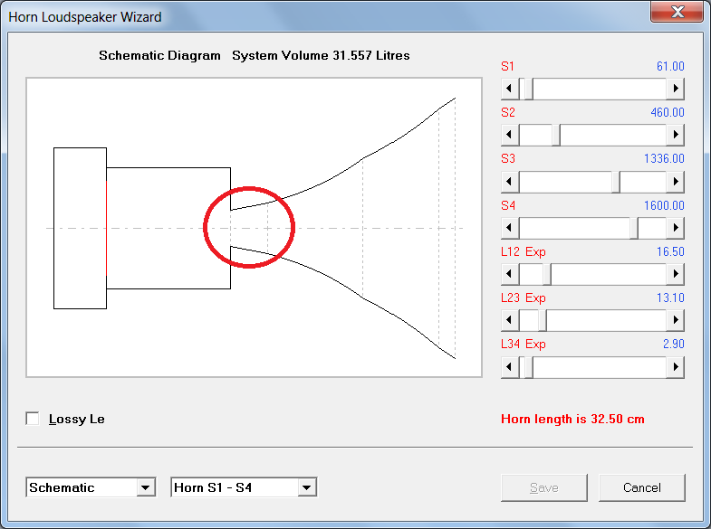

Hi Damien,

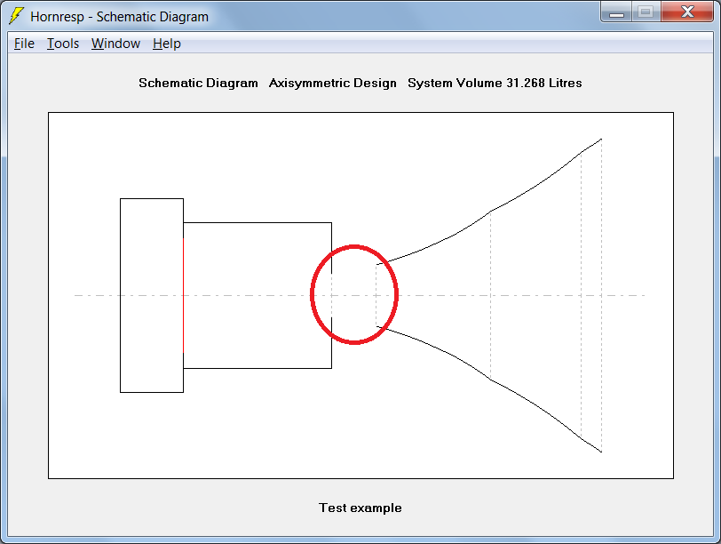

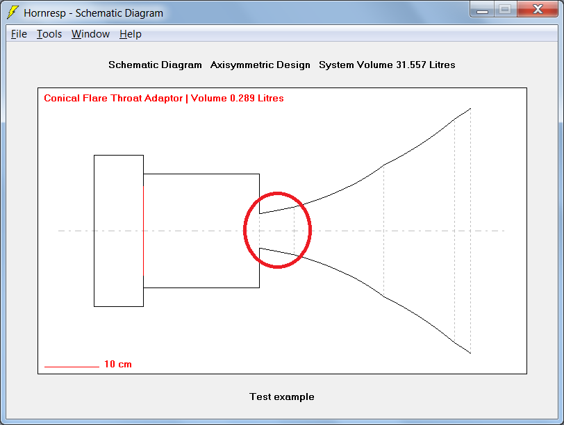

Thanks for reporting this bug - another thing I overlooked, it seems 🙂. The throat adaptor is included in the loudspeaker wizard schematic, but not the main diagram. It will be fixed in the next release.

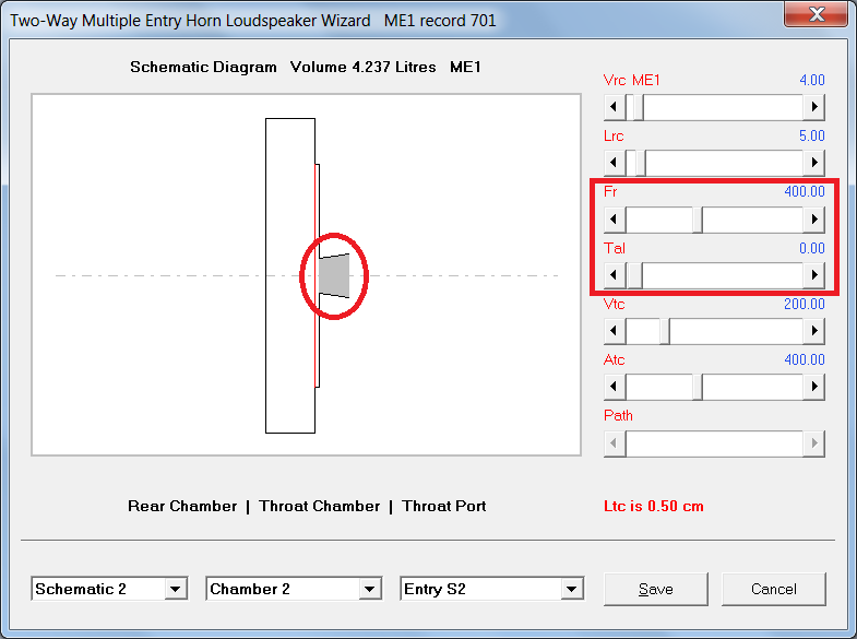

Also in the next update will the absorbent filling Christmas present you asked for recently 🙂. The existing Fr parameter will be "multi-tasked" to remove the need for the user interface to be modified. This reduces the implementation work required to a much more acceptable level.

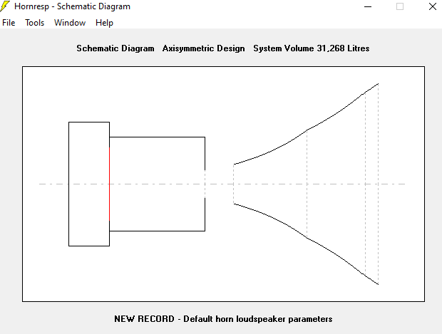

Hornresp Update 5050-191206
Hi Everyone,
BUG FIX 1

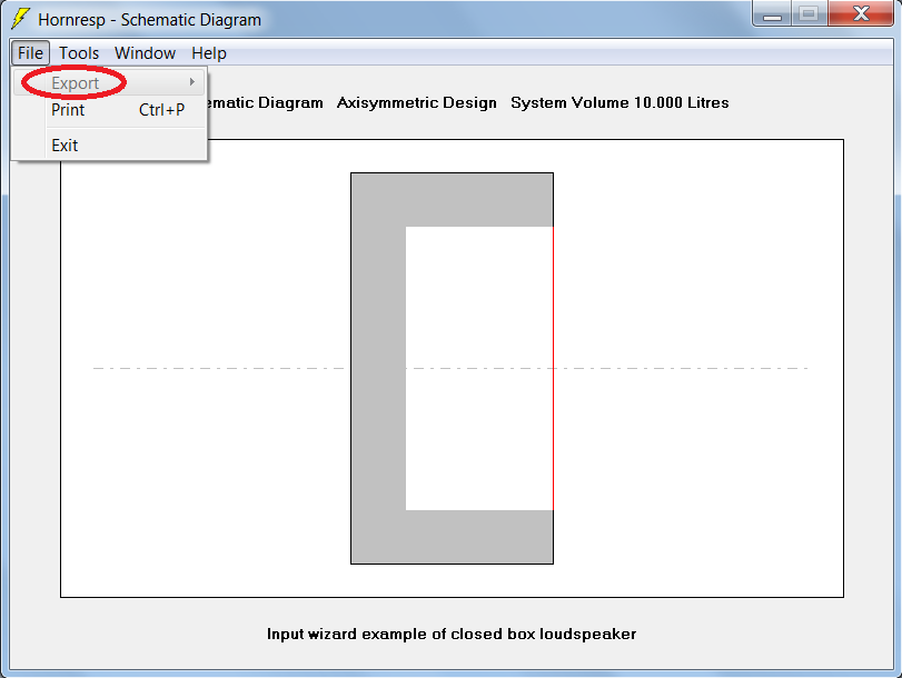

Trying to export horn data from the schematic diagram of a direct radiator loudspeaker would generate a fatal run-time overflow error. To prevent this the export horn data menu command is now disabled for direct radiator loudspeakers. Attachment 1 refers.
BUG FIX 2
A throat adaptor specified using the Ap1 and Lp labels was not being included in the main schematic diagram. This bug has now been fixed. Attachments 2 (before) and 3 (after) refer. My thanks to Damien ('papasteack') for reporting this problem.

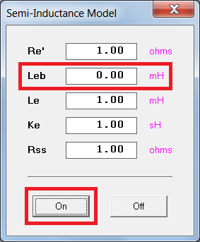

The semi-inductance model free inductance parameter Leb can now have a zero value. Attachment 4 refers.

Absorbent filling material can now be specified in the ME1 or ME2 throat port tube of a multiple entry horn loudspeaker by setting the Fr parameter to the airflow resistivity value, and the Tal parameter to zero. Attachment 5 refers.

BUG FIX 2

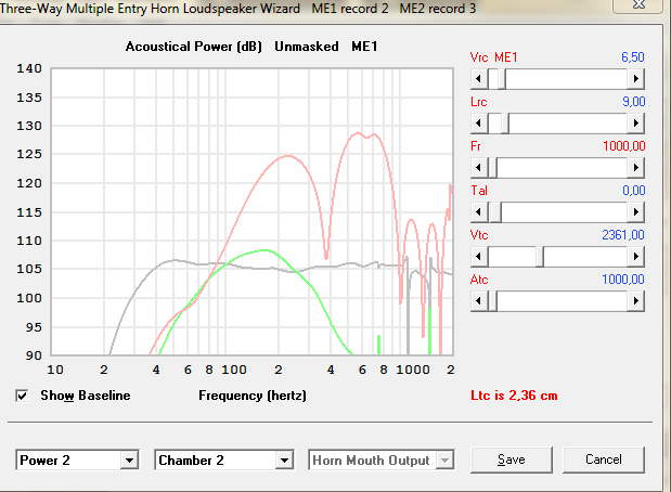

Wow ! This one was fast !
Can you verify ME response, i got a strange result with added filling. Adding a lot of filing at ME1 port, i got the red response for ME1 driver compared to the original green one. 125/130db, this is a lot of boost adding filling ^^
Effect on "Nd driver" response is really nice to see !!!
Here the Nd, Me1, Me2 files if you want to play 🙂
Hi Damien,
Thanks for the feedback. I have identified the problem, and will try to release an update tomorrow (Sunday). I have noticed a couple of other minor "loose ends" that need to be tidied-up at the same time. The response for your test example should have been as shown in the attachment 🙂.
