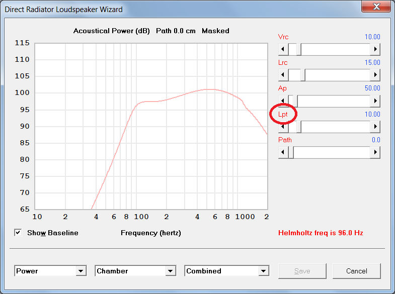

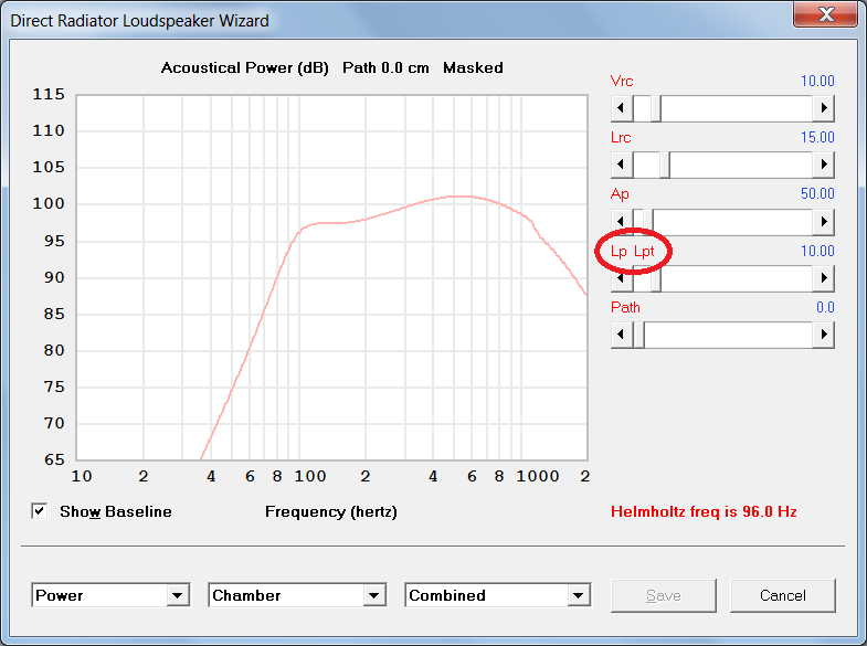

The Lpt label was shown as Lp Lpt in the Loudspeaker Wizard when it should have been shown simply as Lpt. This has now been fixed. Attachments 1 (before) and 2 (after) refer.

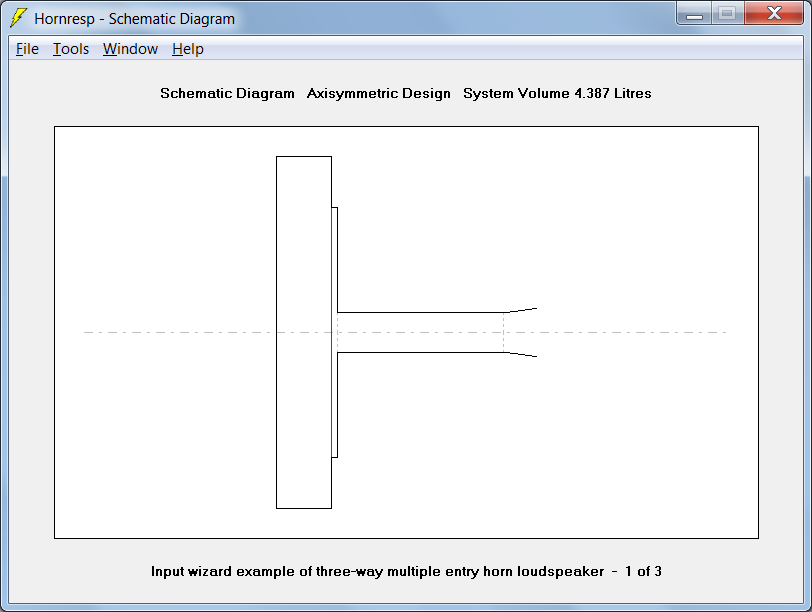

BUG FIX 2

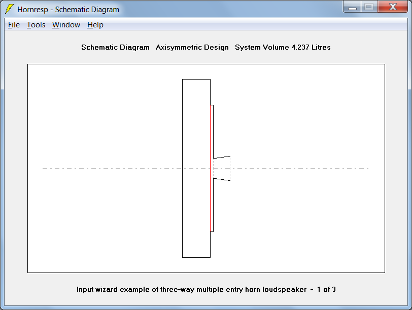

The ME1 and ME2 chamber schematic diagrams in the Multiple Entry Horn wizard were correct but the main schematic diagrams were not. These have now been fixed. Attachments 3 (before) and 4 (after) refer.

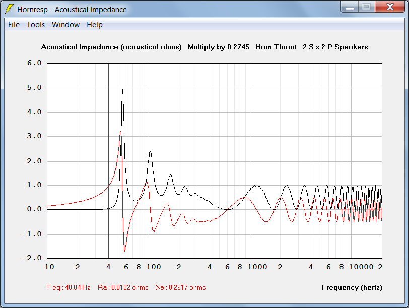

I'm having a bit of trouble getting my hornresp frequency response graph to match reality closely enough to make design decisions on a project I'm starting.
Hi Hugh,

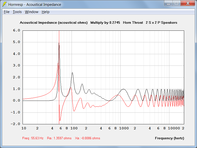

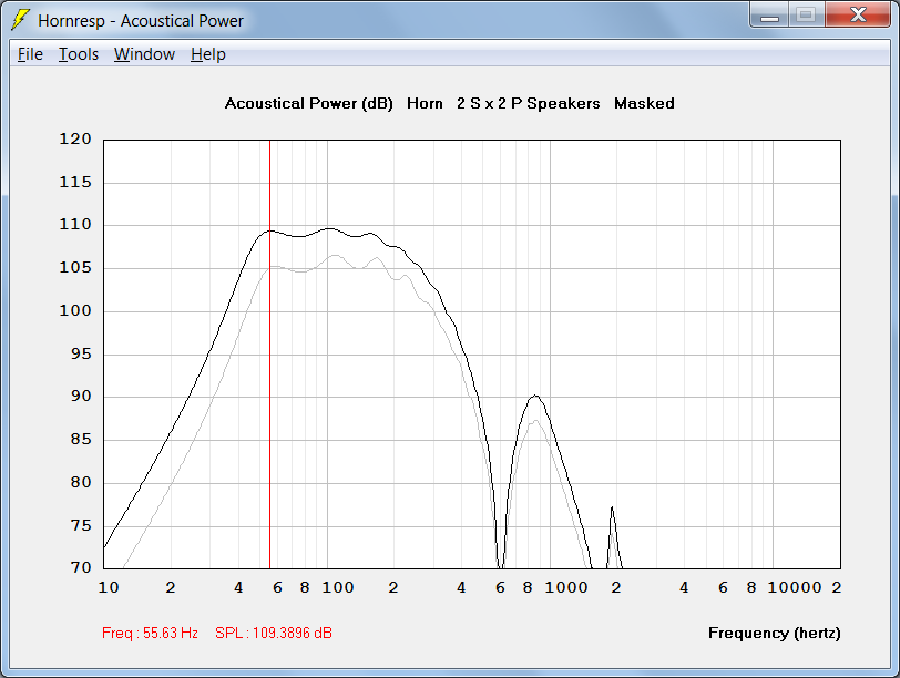

If your simulation model is an accurate representation of the actual physical loudspeaker system, and the driver parameter values are correct, then I have no idea why there should be such a discrepancy between your measured results and the Hornresp predictions.
It is interesting that the Punisher speakers roll-off as low as 40Hz. The predicted 55Hz figure is closer to what I would have expected to see for such a design, which in reality is just a severely foreshortened front-loaded bass horn, resulting in a very peaky throat acoustical impedance loading the front side of the diaphragm.
Attachment 1 shows the acoustical resistance Ra peaking at 55Hz, while Attachment 2 shows that at 40Hz the resistance is very low, which is why I am somewhat surprised at the performance you are achieving.
Kind regards,
David
