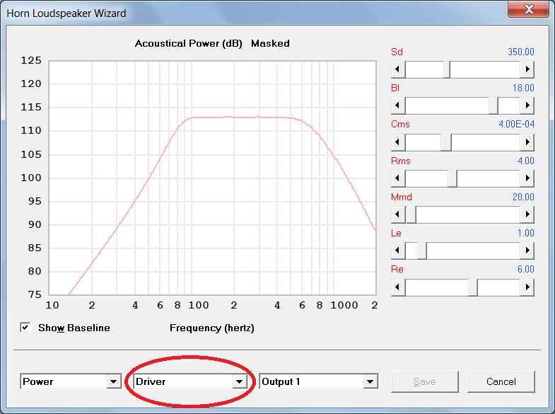

How About a Sensitivity Analysis Tool that explores system sensitivity to driver parameter tolerances (variation).
If you are looking for a "parametric sweep" type tool, then that's not going to happen. I'm afraid you will just have to make do with selecting the Driver input option in the Loudspeaker Wizard, and adjusting the slider values to see what happens to the results 🙂.

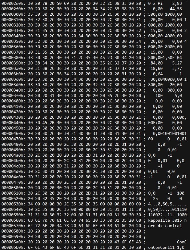

Hello David,
Upgrading from 50.30 to latest 50.50 introduced an error 13 (type mismatch) whenever loading my usual data file followed by moving to the 'next' record. Looking at the file (UltraEdit) I see that the first record is the default set, and I attached a cut out of the second, probably faulty, record (hope it is right).
Why would it crash where 50.30 (and older versions) did not?
I could email you the whole file if you'd like to.

I think I'd better post the entire file, here you go. (adding extension .txt)
I see that after opening a datafile Hornresp modifies the modification date but does not modify the file.
I just ran 50.30 again and 50.30 finds this file okay (all records can be browsed). But 50.50 crashes on the 'next' to the second record.
The file counts 22020 bytes.

I have same problem with the last version, but I also lost the previous version. In the meantime, please how to get the 50.30 version from your site ?
Hi Andre,
Many thanks for posting the file - it has enabled me to quickly track down the statement in the source code that is causing the problem.
I will try to release and update tomorrow, which will hopefully fix things.
Thanks again for your invaluable help!
Kind regards,
David
Sorry, I don't retain copies of earlier versions.

I updated windows 10 and HR worked fine afterwards.
It turns out that the problem had nothing to do with what Windows operating system was being used. I was able to see the issue for myself using Windows 7 when I tried to run the data file Andre posted. This enabled me to quickly identify the cause. The reason I did not have the problem originally is because it only occurred with records of a certain "age". Just by chance, none of the records in my own Hornresp.dat file fell into that age category.
