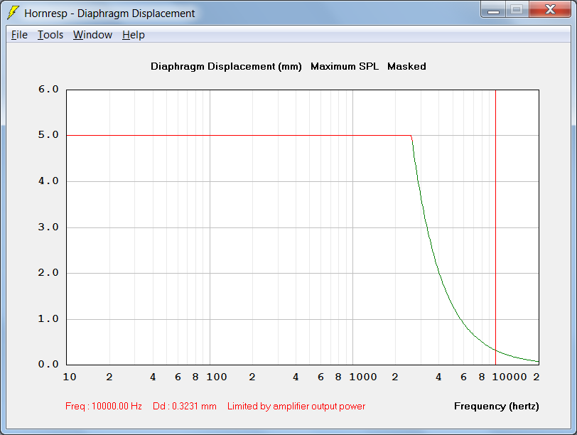

Hornresp Update 5050-191115

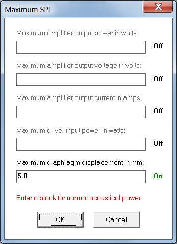

CHANGE 1
The Maximum SPL tool On / Off settings for a given record can now be permanently saved to the Hornresp.dat data file. Previously only the limit values could be saved.

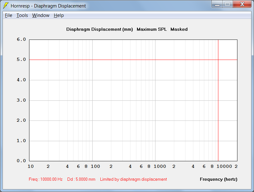

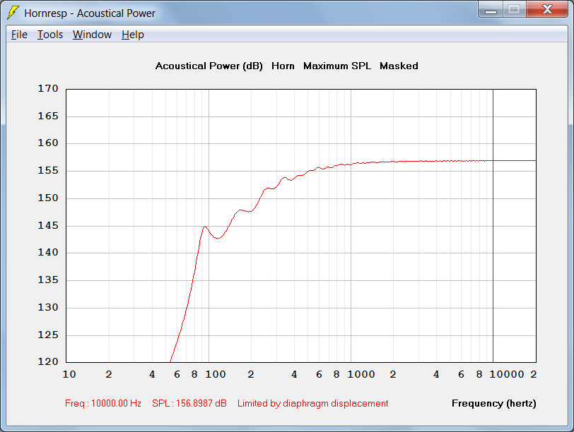

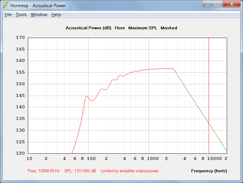

BUG FIX 1
For some input settings, the Maximum SPL tool results were incorrect. To illustrate, for the default record (with resonances masked) the input shown in Attachment 1 would produce the results shown in Attachments 2 and 3. The green power-limited sections of the traces are not correct. For the given input setting the outputs should be displacement-limited over the whole frequency range, as shown in Attachments 4 and 5.
This bug has now been fixed.

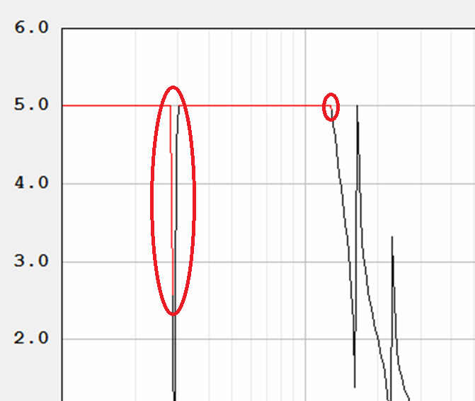

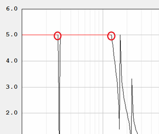

BUG FIX 2
Sometimes there would be an "overshoot" on the Maximum SPL chart traces, as shown for the diaphragm displacement chart red trace in Attachment 6. This bug has now been fixed, as shown in Attachment 7.
