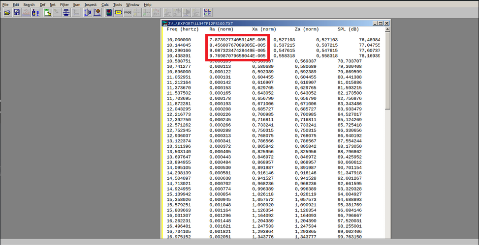

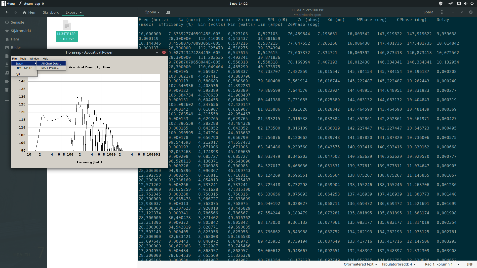

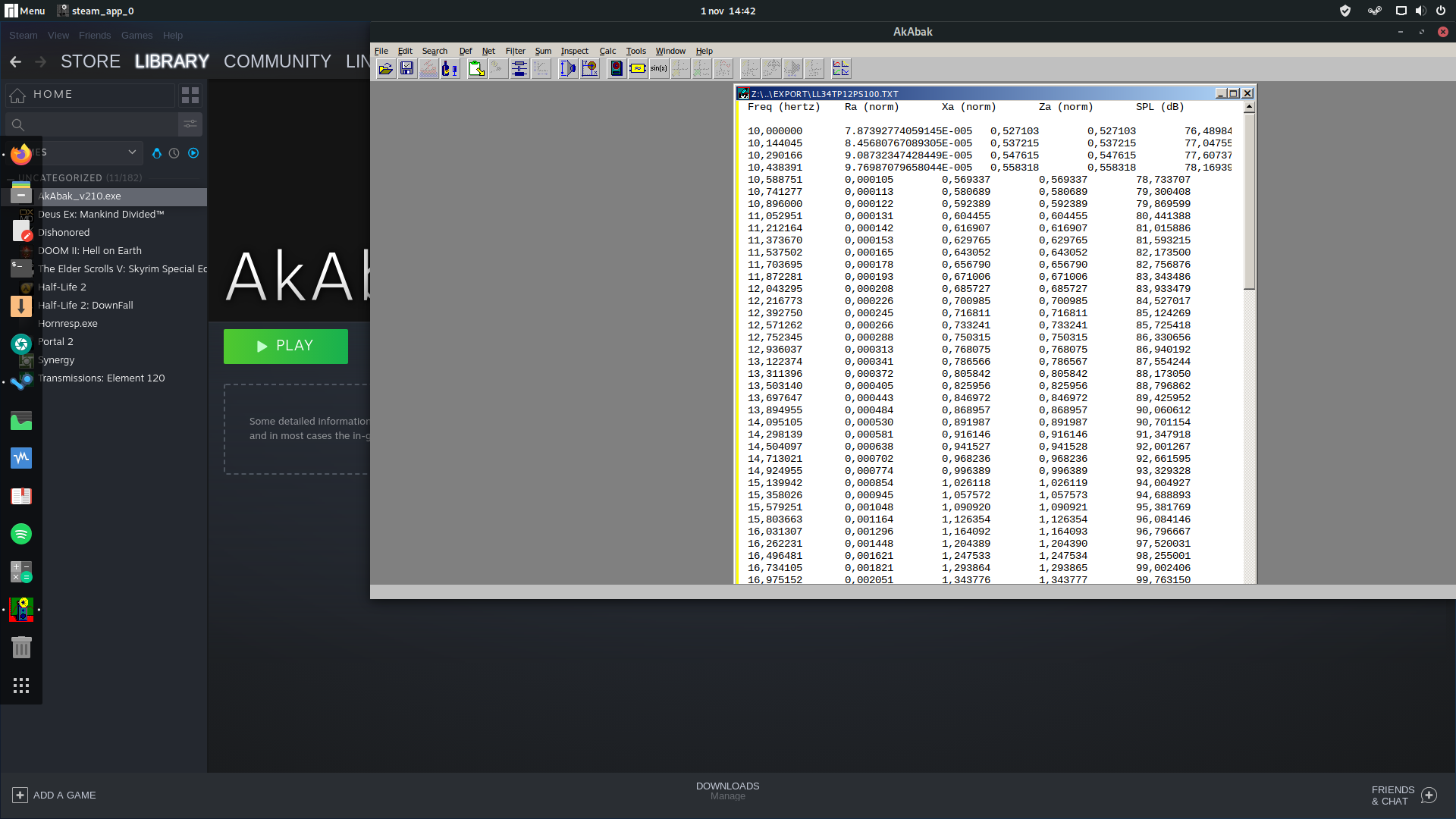

Exporting data does not seem to be a problem at least.
I have only used Hornresp in Proton for an hour or so, but I was amazed by the simplicity of installing it and running it. There was always some struggle under Wine, even though I got it to work once in a while.
Can steam proton run on android phones?
I would guess no. They run ARM processors. I don't think Proton runs on ARM at all.
Not that it really matters, but as far as Hornresp is concerned, even for very small or very large numbers, all exported values should be formatted simply to 6 decimal places (ie. scientific / engineering notation not used). In the example you show, for some reason the normalised Ra values for the first 4 frequencies are formatted to more than 6 decimal places, using scientific notation.Exporting data does not seem to be a problem at least.

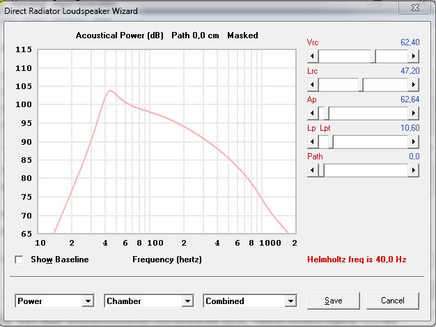

If you are referring to a down-firing closed-box woofer, then it is not really possible to simulate such a system in Hornresp.
Kind regards,
David
Hi David. Using the normal closed box calculation works fine for downfiring types. i have meaure the resonance and it is 5 hz higher then with hornresp calculation, what is normal because also the speaker still new and not played in well so it is quite precise.
In a old book I did see the hemlholtz frequency has to be tuned to this resonance including speaker I have in that closed box, doing so I get a big peak. but make the tuning lower hornresp give me a nice graph. Is that oke.

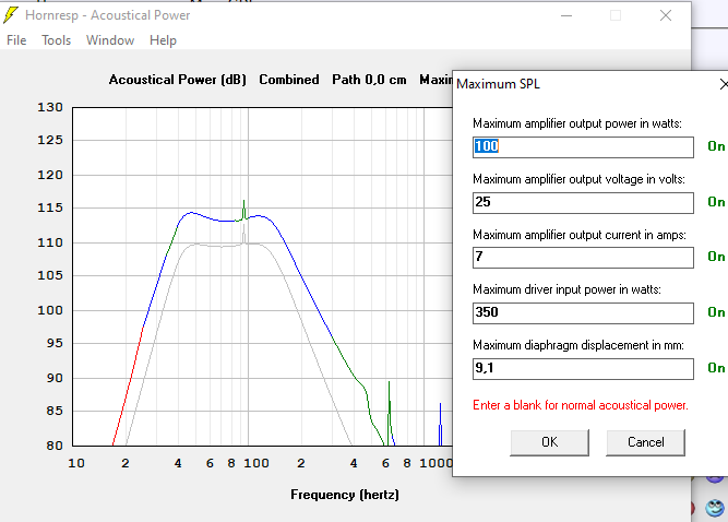

Hi all, it appears the Max SPL tool doesn't take in to effect the filters set in the Filter Wizard.
Is this correct?
Or is there a way to get filters to work with Max SPL that I might be missing?
Thanks!

As I understand it, MaxSPL is the max_power(freq) subject to a short list of constraints irrespective of filter settings. Best thing to do with filters set is increase power until you hit the excursion limit and then look at the "driver power" screen to see if you have exceeded driver or amplifier power limits.

Gotcha, makes sense. Thanks🙂
Max SPL at 1 frequency point doesn't depend of filter. It depend of the capabilities settings you gives in Max SPL screen.Hi all, it appears the Max SPL tool doesn't take in to effect the filters set in the Filter Wizard.

In the shown design, whatever i do with the set of constraint i put, colors gives me the max SPL i can reach before being limited. I used Tool=> compare previous, to see if with the input voltage i set i main input screen i would be limited. It is in grey. It appears i have a really good margin of 8-15db before reaching some of the limit i set using the voltage i plan to use. And filter was active in grey curve.
