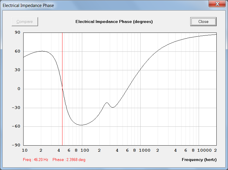

Capacitive reactance is negative, and inductive reactance is positive, and in this way you can separate inductance and capacitance in the impedance plot in Hornresp.

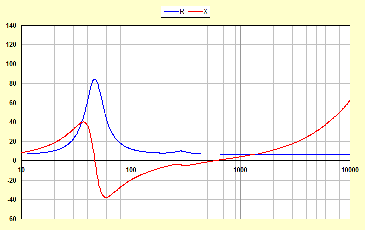

Just to clarify, it is necessary to export the electrical input impedance magnitude (Ze) and phase (ZePhase) data before the resistive (R) and reactive (X) components can be extracted.
R = Ze * Cos(ZePhase)
X = Ze * Sin(ZePhase)
Further to my post above, if the numerical values of the inductive and capacitive components of the reactance are not required and only the frequencies at which they occur are of interest, then this information can be determined directly from the electrical impedance phase response. If the phase is positive, the reactance will be inductive (ie. below 46 Hz and above 600 Hz in my previous design example).

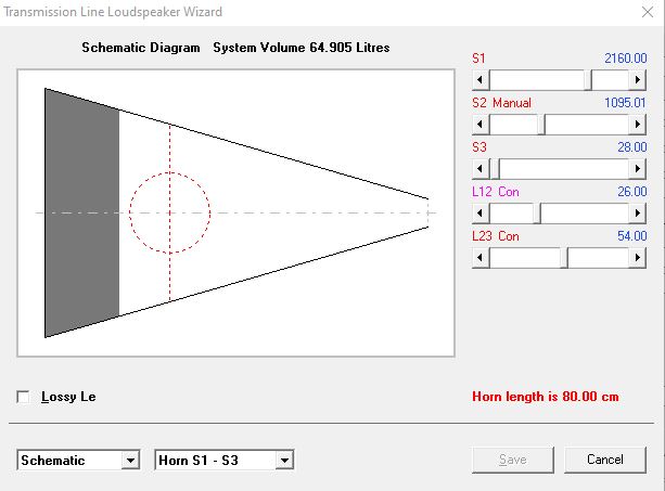

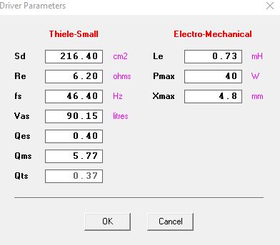

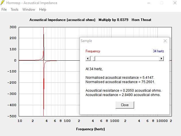

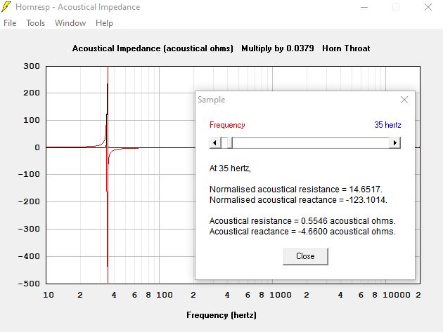

Just for reference, this is the simulation that made me wonder about capacitance and inductance at the tuning frequency. Started with a normal TL but as I tweaked the design, I had to keep increasing the S1 to compensate for the lower Qts. What I ended up with was a stunningly short line length, with decent frequency response. But obviously, its TL character is now questionable.
Exactly what I needed. Thanks.
