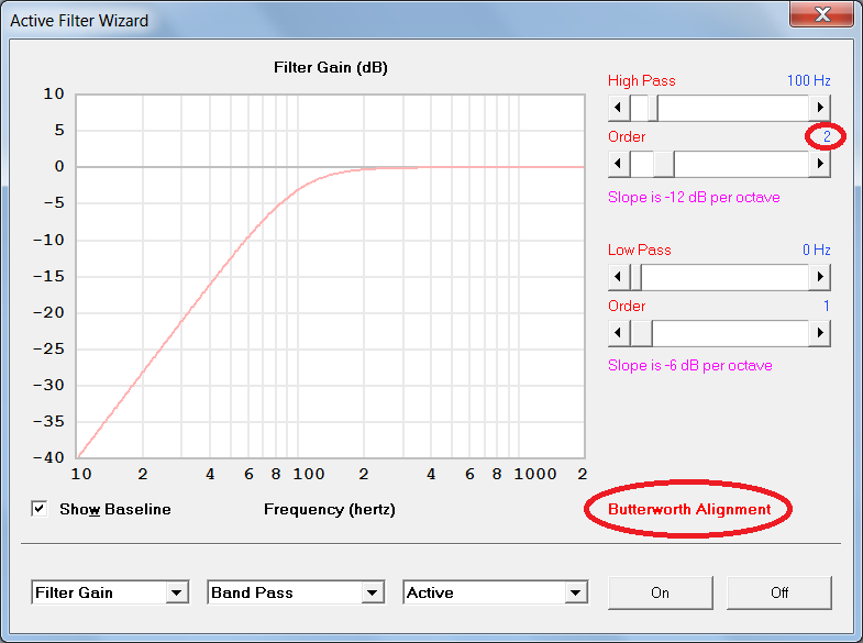

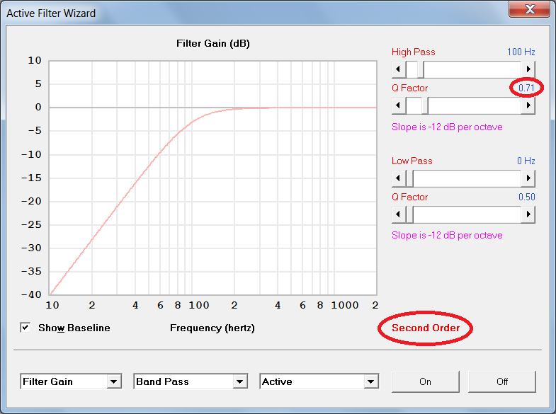

Hello, Can I ask. In the Filter Wizard Settings.
I have used a Second Order Filter. Is this the same as a Butterworth Filter with an order of 2?

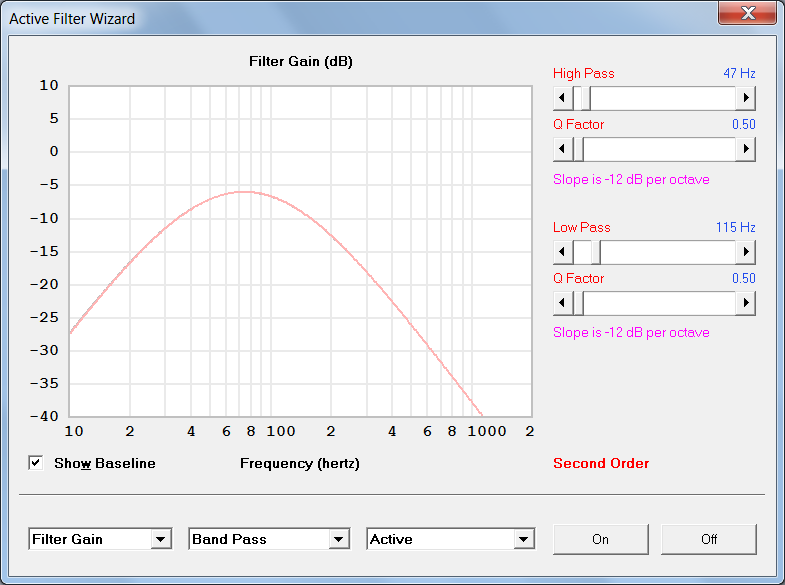

I have designed a folded horn/ Ported Cabinet and have to apply filters to reduce the Diaphram Displacement.
How can I replicate this filter for the sound test I am going to be doing on the Cabinet.

Hi Andypk,
A Second Order Filter with a Q Factor of 0.71 (1 / Sqrt(2)) is the same as a Butterworth Filter with an order of 2.

The only way to get the cab to function is "Second Order" with a Q factor of .5

I have a Q of .5 as second order. This is the best result for a Vented Rear chamber Folden Horn Design to reduce the xmax.

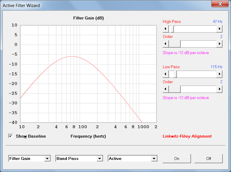

Not sure if it helps, but a Linkwitz-Riley Filter with an order of 2 is the same as a Second Order Filter with a Q Factor of 0.50.
