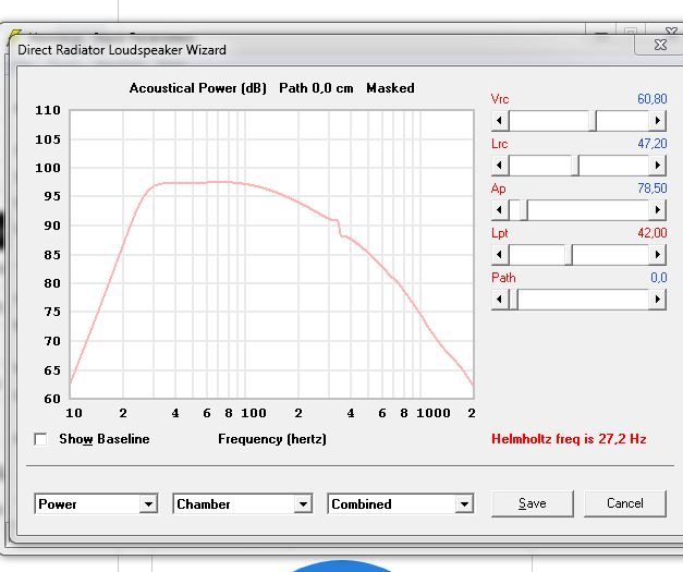

No that is not possible because of bracing, I have a downfiring closed box 64 liters, when I do simulate with a bassreflex I get fairly low, maybe the speaker is a good fit with low vas and high Sd, calculations say it is better for closed, the speaker is 12 inch.
I can split the tubes then I do need two 6 cm ones, get some more cm2 but it is more suitable because of ethic view she come out on the sides, if it is aloowed that the input of the tubes are quite close to the speaker in the box, because then, it needs to output just above the floor.
I see a small resonance tube, but the sub goes not so high, it stops around 100 hz.

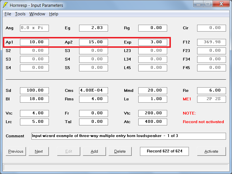

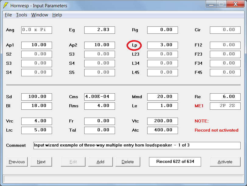

The offset entry ports in a multiple entry horn loudspeaker system can now have a conical, exponential or parabolic flare profile, as shown in Attachments 1 and 2.

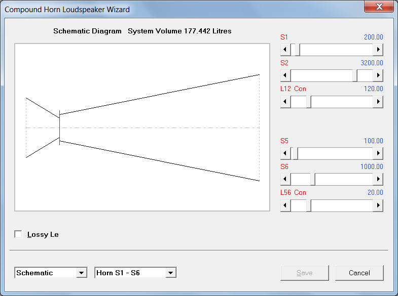

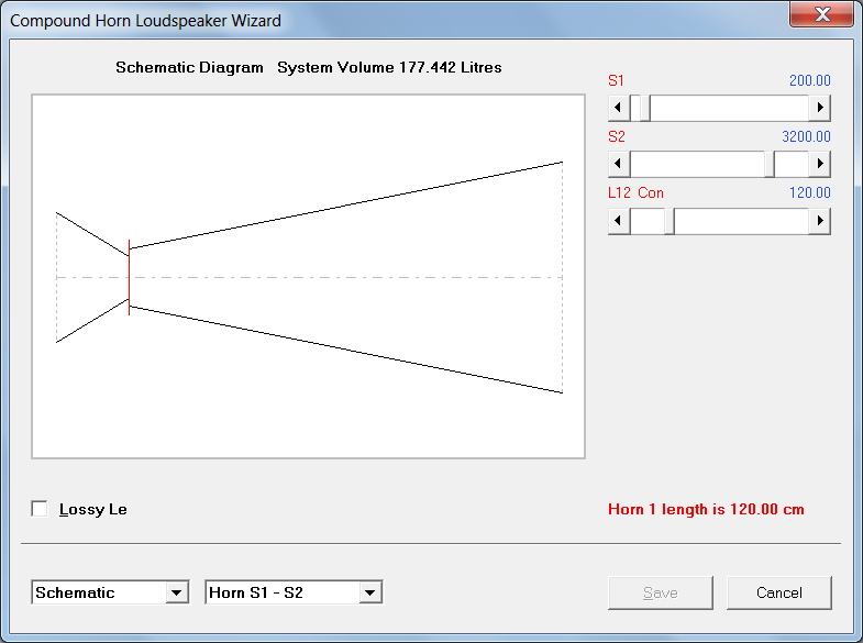

Previously, when horn 1 in a compound horn system had one segment, the sliders for horns 1 and 2 were displayed separately, as shown in Attachments 3 and 4. They are now displayed together, as shown in Attachment 5.

Due to those new change, at first i was affraid, but in fact, in ME1 ME2 screen (when using multi-entry wizard), for a previous done design, to make things equivalent to previous result in previous version, we just have to set L12 to CON segment, and put in it field Ap2 value, and so set Ap2 value to Ap1 value.
Not sure many can understand what this sentence is about. ^^
Hi Damien,
To specify a cylindrical port all that is really required is that Ap2 = Ap1, so that the mouth area equals the throat area. For the port tube length Lp, it doesn't really matter what flare profile is specified - it can be Con, Exp or Par, or even just left as Lp, as shown in the attachment. If left as Lp, and Ap1 is not equal to Ap2, then the flare will be conical by default.
