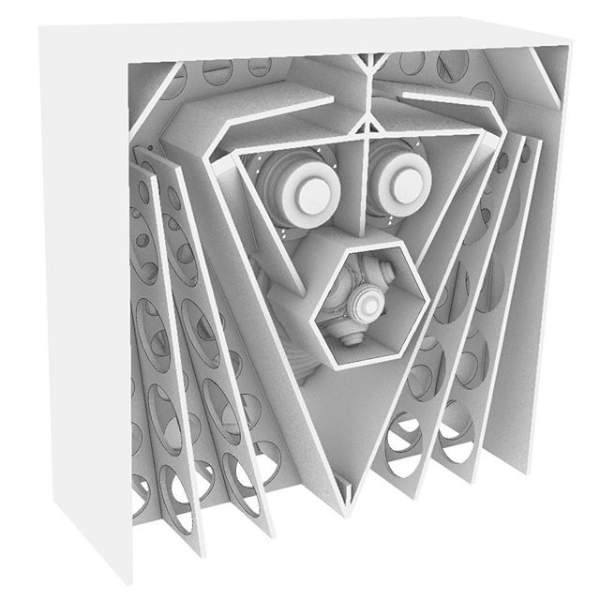

To celebrate I've attached some pictures of a more complex build that used Hornresponse to model several parts.

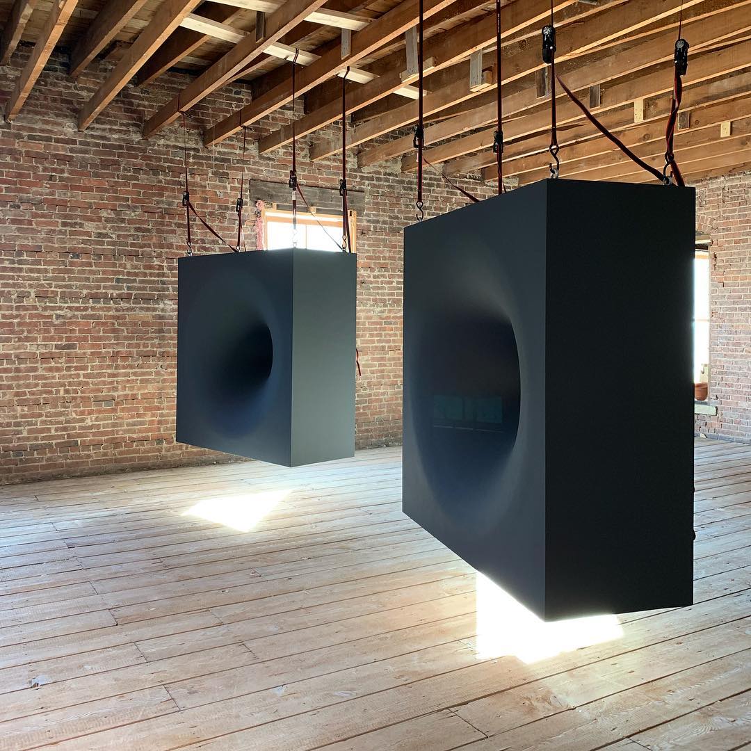

Those look awesome! Please tell us more about them.
Its a loudspeaker I designed for A For Ara, called H3.
All horn loaded, Hypex FA503. Sounds superb, goes very loud, complex build.

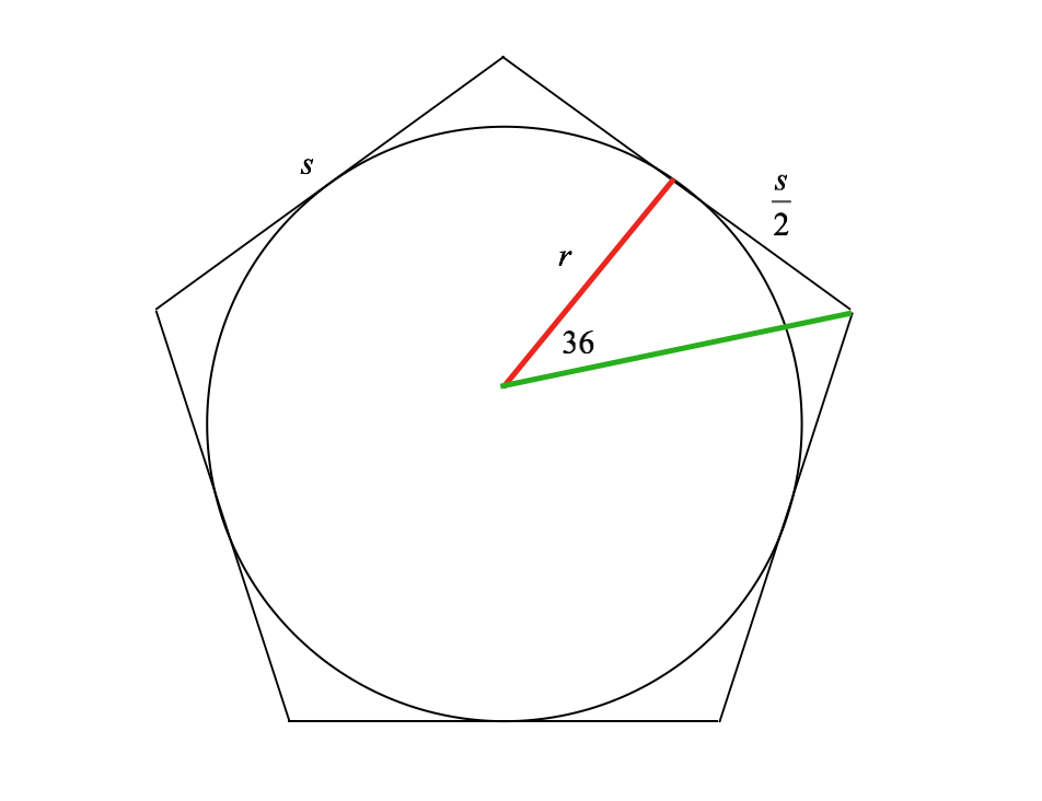

the interior radius (I need help with this one) of the cross section in cm
Inradius - a circle having this radius will just fit inside the petal horn cross-section. A circular horn constructed using this radius can serve as a temporary former for assembling the petals around the outside.
the side length (I need help with this one) of the section in cm
Side Len - distance along the curved surface of the petal itself, for a given axial distance from the horn throat. This distance is required to be able to make the petal.
the width (square root?) of the cross section
Width/2 - half the petal width at the distance given by 'Side Len'.
I do not know why the data is broken up into multiple sections.
Each horn segment has its own section of data.
Kind regards,
David
1.5 meters square I'm guessing?
The 'Inradius' value is the length of the red line shown in the attached cross-section of a 5-petal horn.
The 'Radius' value (also given in the exported data for a petal horn) is the length of the green line.

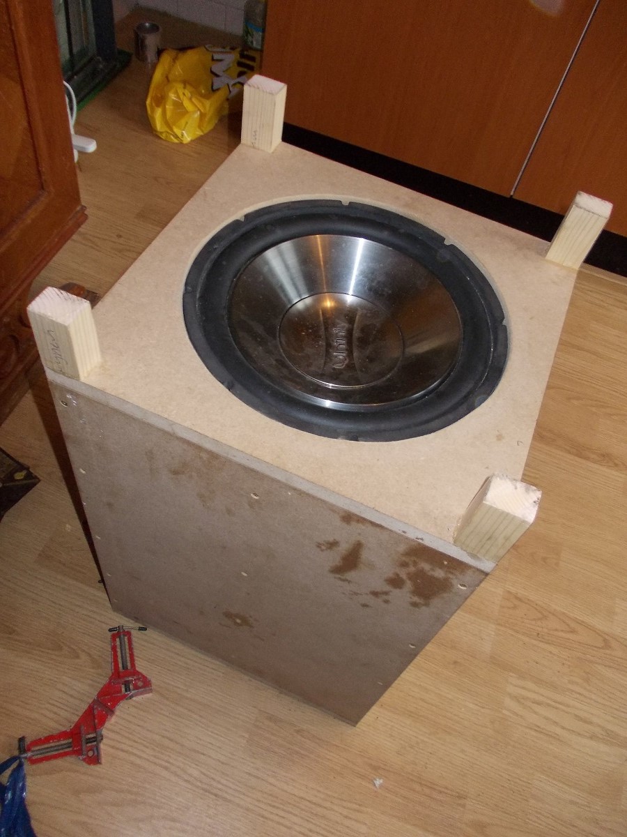

I have build now a closed box and c o build a dipole with 2 x wsp26s woofers, try to get cardioid effect with both as seen on pic.

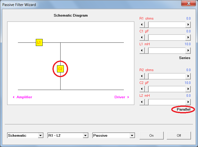

David, I did try the filtering passief into hornresp, are you shure these works oke? because I see serial all the way there, but need coil series, and cap parallel for low pass.

David, how long may be a bassreflex port be? I get 40 cm length and 10 cm accros is 78 and some cm3 for 12 inch low vas woofer.
The sub does fire on the floor, that works nice here in the small room.
thanks
Hi Kees,
Double-click on a 'Series' label to change it to 'Parallel', as shown in the attachment.
A 40 cm bass reflex port tube seems reasonable to me, but others with more practical experience in such matters may care to comment further.

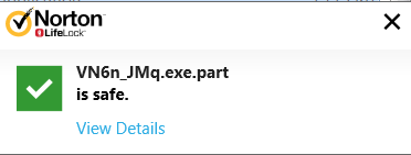

Hi Sabbelbacke,
If you happen to read this message, just to check I tried downloading a copy of Hornresp after seeing the post by Hofmann below, and experienced a similar problem to the one we discussed recently. This time I received the attached message. After several attempts I finally managed to download a workable copy of Setup.exe.
I don't know if Hoffmann had the same problem as me, but it seems that odd things are still happening from time to time with the downloads, and that the issue now doesn't appear to be confined just to myself.
Kind regards,
David
It appears that I am unable to download Hornresp trough the hornresp.net website.
Kind regards,
David
David, the problem for me was on my side.
It appears that the computers at work are protected against downloading certain filestypes. So I won't be designing any speakers during my lunchbreak 😀
Hi Hofmann,
Many thanks for clarifying what the problem was. It doesn't surprise me that you couldn't download Hornresp at work. Most companies are very wary of allowing executable files such as Setup.exe to be downloaded, just in case they are malware, and try to take over the business 🙂.
