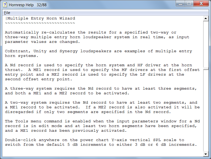

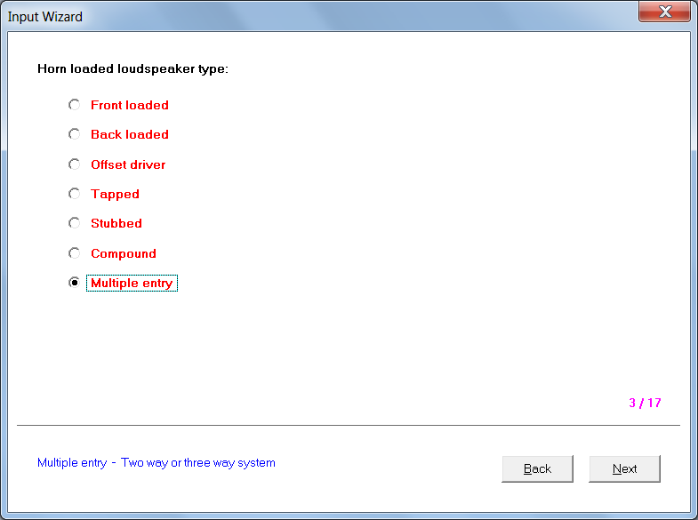

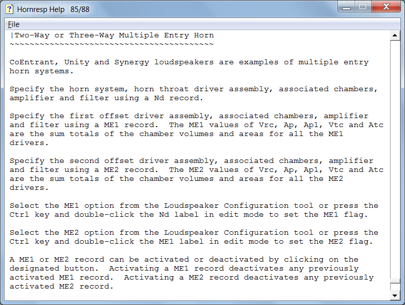

Could the Unity Horn be simmed in Hornresp? better yet 3 ways Unity where the woofer is in the horn?
Hi 1hiep0,
Both two-way and three-way systems can be simulated. A representative example of a multiple entry horn system can be specified using the Input Wizard accessed from under the Input Parameters window Help menu. The record parameter values can then be changed to match the actual design. Read the "Multiple Entry Horn Wizard" and "Two-Way or Three-Way Multiple Entry Horn" sections in the Help file to better understand how a multiple entry type system is specified in Hornresp.
Kind regards,
David

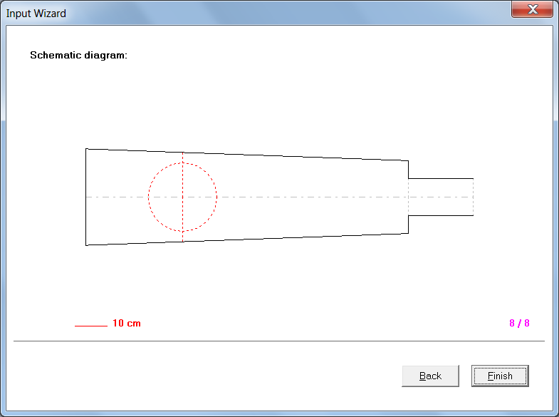

Hornresp Update 5040-190922

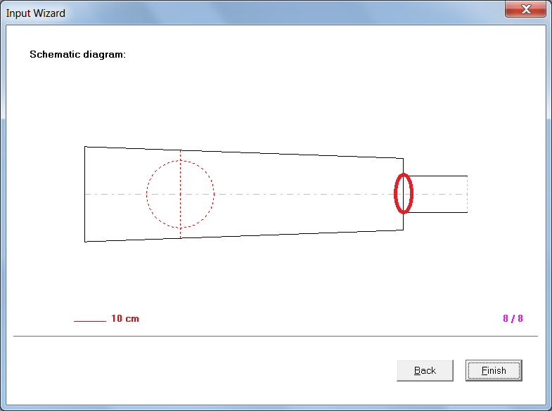

Hi Everyone,
BUG FIX 1
The following sequence of events would produce an incorrect schematic diagram for a mass loaded transmission line loudspeaker in the Input Wizard. This has now been fixed. Attachment 1 shows the incorrect schematic, Attachment 2 shows the correct schematic.
Free space
Next
Direct radiator
Next
Closed box
Next
Offset driver
Next
Back
Back
Transmission line
Next
Mass loaded
Next
Next
Next
Next
Incorrect schematic

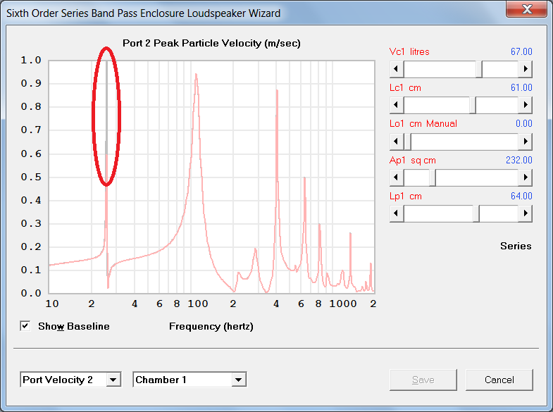

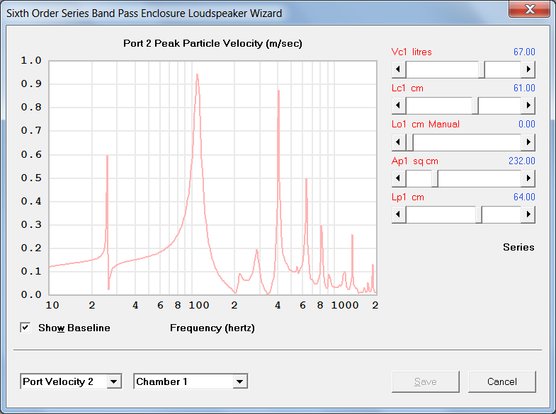

BUG FIX 2
For band pass loudspeaker systems, the initial baseline port velocities were not exactly the same as those for the initial calculated results. This has now been fixed. Attachment 3 shows the incorrect results, Attachment 4 shows the correct results. In the correct results the grey baseline trace can no longer be seen because it is identical to, and hidden behind, the light red trace.
