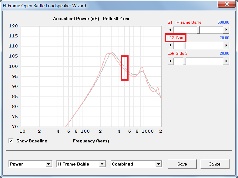

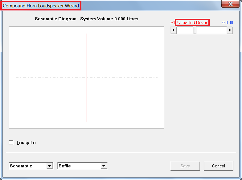

Hornresp Update 5040-190906
Hi Everyone,
BUG FIX 1
If a H-frame open baffle loudspeaker system was specified with S1 > Sd, the Loudspeaker Wizard then opened, the Power response chart selected, the L12 slider set to 0.10 to specify a U-frame, and the B key then pressed to restore the original L12 slider value, the restored response was different to the original and the L12 slider caption changed from 'L12 Side 1' to 'L12' plus the flare type - see Attachment 1. This has now been fixed.
BUG FIX 2
If an unbaffled driver or flat open baffle loudspeaker system was specified and the Loudspeaker Wizard then opened, the wizard caption was incorrectly shown as 'Compound Horn Loudspeaker Wizard' - see Attachment 2. This has now been fixed.
Kind regards,
David

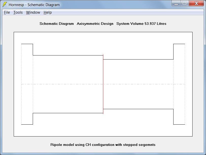

It was Rudolf's work to simulate H-dipol and Ripol in the AJ-Horn programme that got me interested in what Hornresp could do. In fact with the use of the Compound Horn model it is very easy to set up these models. And I think that the results are valid. H-dipol simus I have compared to MJK's models and the difference is very small.
Here is a Ripole example, which is the same as Rudolf use in his paper in the Download section on his Web: Offene Schallwand (OB) . I think that the pictures tell the story, combined response is calculated with 37 cm difference as in Rudolf's example.
The Hornresp results are a bit different from Rudolf's and I am no Ripol-expert, so it would be nice if he could comment on them.
/Erling
Pictures and instructions are gone.
Any chance of a repost?
Does anyone have a sample they can show?

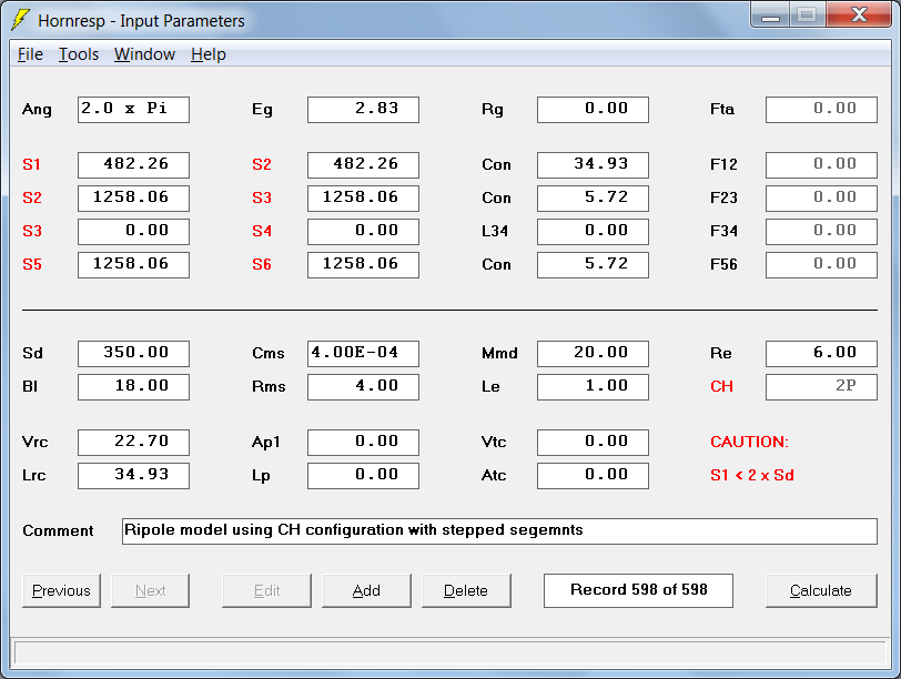

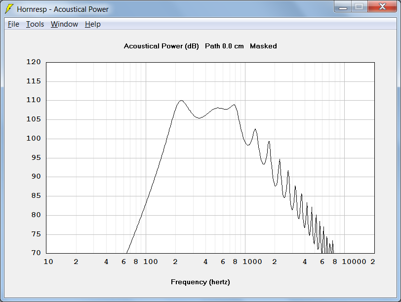

Hi DaveFred,
It seems that people may be reluctant to have a go, so here's my attempt... 🙂.
I have used the dimensions shown in your schematic, and two of the Hornresp default drivers connected in parallel. The model is obviously not perfect (drivers not offset) but it should give a reasonable indication of the expected performance.
Kind regards,
David
PS - If anyone has a more accurate Hornresp ripole model could you please post it. I won't be offended in the slightest 🙂.

I should have specified a non-zero acoustical path length. Somewhere around 50 cm seems about right.

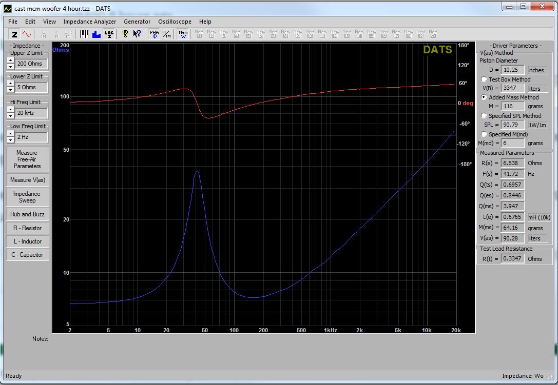

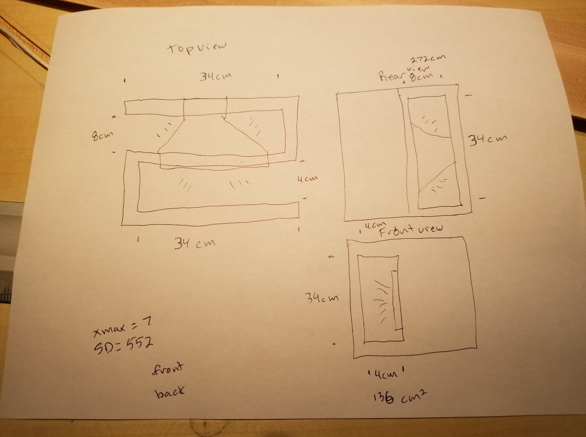

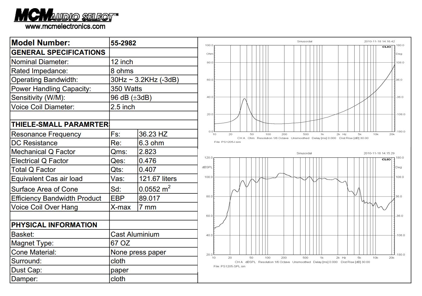

Hello David,
I made a child's drawing of a ripole with I think all the proper dimensions and here is all the data I could muster,
Here are I think all the relevant parameters as measured by me after four hours of break in,
F(s) = 41.72 Hz
Q(ts) = 0.6957
V(as) = 90.28 liters
SPL = 90.79 dB SPL 1W/1m
R(e) = 6.638 Ohms
Q(es) = 0.8446
Piston diameter = 260.4mm
SPL = 91.6 dB SPL 2.83 Vrms
C(ms) = 0.227 mm/N
L(e) = 0.6765 mH at 10kHz
Q(ms) = 3.947
BL = 11.5
n(0) = 0.7402%
M(ms) = 64.16 grams
Xmax = 7 mm
SD = 552 cm^2
Anyone care to take a stab at it? 🙂
Thank you,
David.

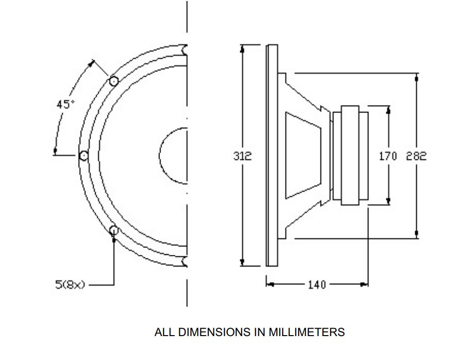

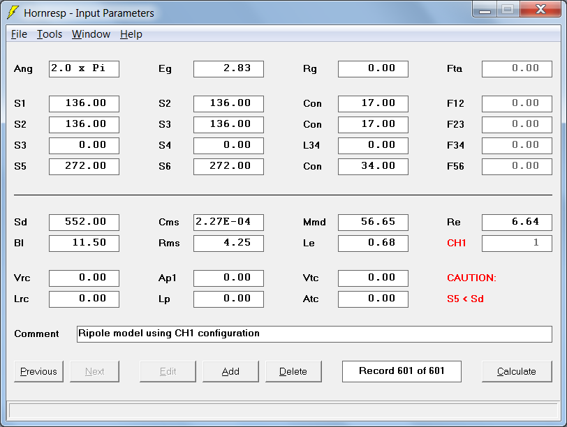

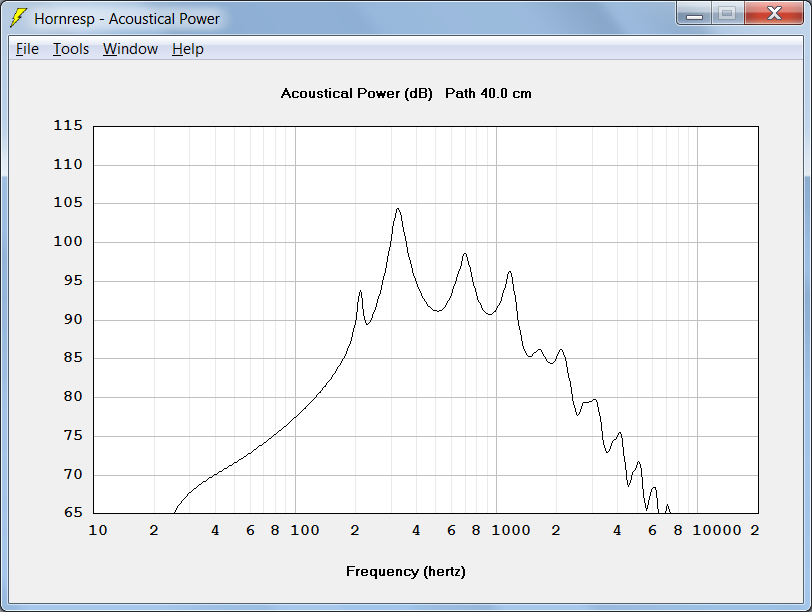

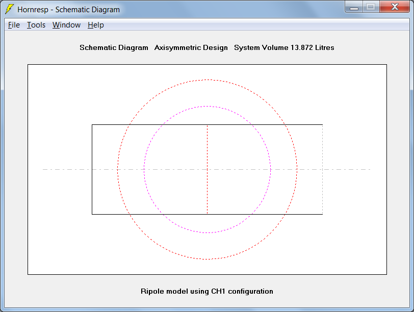

Hi David,
The attachments show my attempt.
CH1 rather than CH has been used so that the front side offset driver position is taken into account. Unfortunately this does not apply to the rear side, so that the overall results are somewhat compromised. An acoustic path length of 40 cm has been assumed.
If you are serious about accurately simulating a ripole then you should really be using AkAbak, not Hornresp 🙂.
Kind regards,
David
