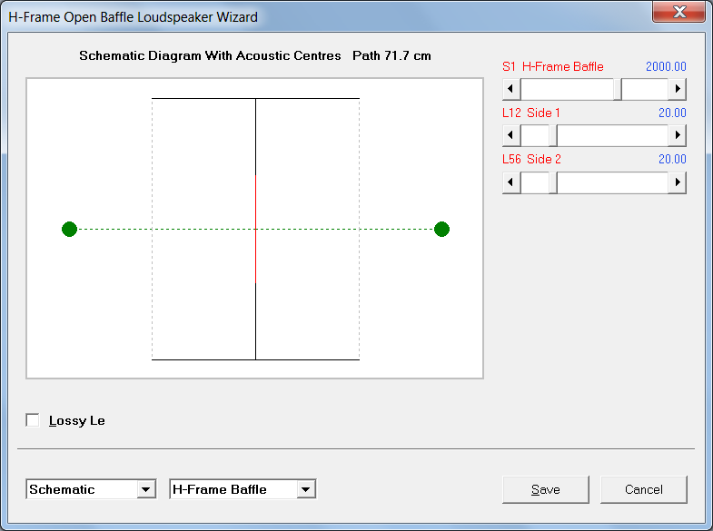

Following on from the recent release of Version 50.40, a number of minor "loose ends" have now been tidied up.
One small enhancement is that when the loudspeaker wizard is used with an unbaffled direct radiator, a direct radiator in a flat open baffle, a direct radiator in a H-frame open baffle or a direct radiator in a U-frame open baffle, double-clicking on the schematic diagram now shows the positions of the dipole acoustic centres (see attachment). Pressing the Esc key hides the acoustic centres.
BUG FIX
A single-segment compound horn with stepped segments specified, would generate a fatal overflow run-time error when opened in the loudspeaker wizard. This problem has now been fixed.

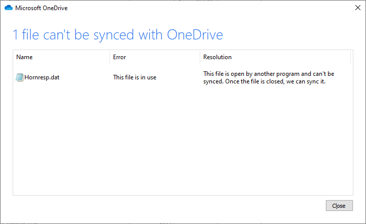

One minor change I'd like to see....
It looks like Hornresp keeps the data file open (hornresp.dat) while the program is open. I've got Hornresp loaded on my main PC and my testing PC, and they've both configured to use the same copy of Hornresp off of OneDrive. Because Hornresp locks the data file for writing while the application is open, I can run into issues saving updated sims on the test PC if I leave Hornresp open on my main PC. Can Hornresp be reconfigured to lock the data file only if it's writing to the database?

Hi Brian,
Unfortunately the way that the program has evolved, it would not be a minor change, and I am concerned that it could inadvertently affect the current "stability" of the Hornresp.dat file. As recently mentioned the file has proven to be remarkably resilient in the face of some very harsh treatment, and I don't want to do anything that could potentially jeopardize this enviable record. I am a great believer in "letting sleeping dogs lie". In other words - it's not going to happen .

I have the same "issue" as Brian - having hornresp on Dropbox which is connected to several PCs (at home, on the mobile Laptop, at work, etc..)..
In order to have a program access data files from several locations at the same time without loosing information in the access file, some sort of database access would be a solution - otherwise each copy of hornresp open at the same time would have to check all the time, if a change in the data file has happened. This is not a simple task and requires a lot of features on the programming side. So I totally get, why this is "not going to happen"
My "workaround" is to simply try to remember to close hornresp everytime I have been using it If I forget, I end up loosing my recent records, depending on which machine did the last "saving" on the file (which then is automatically synced to all others, overwriting all other versions)... I am getting better at not forgetting
One small "safety feature" that could help in usecases like this: If hornresp writes a zero byte file with nothing in to the hornresp directory as long as its running - and deletes it when it´s properly closed - hornresp could simply check on startup if this file exists and give a warning message (or even refuse to start)... The file could be called "datalock.tmp" (or whatever ) .

Hi David, first of all, thanks for all the effort put into the program! I started getting Run-time error '75': Path/file access error when trying to add a new record. In the past, it usually helped to remove the hornresp.dat file - but now I am getting the error all the time. I have the latest version and Windows 10. I can zip the whole folder and send it to you if that helps finding the problem. A new fresh install works normally again.
Exactly, you end up with a seperate file with the extension "in conflict,.." (or something like that, it´s in german here).You cannot write from two instances of dropbox to the same file, dropbox does not allow for this behavior and automatically declares a conflict.
