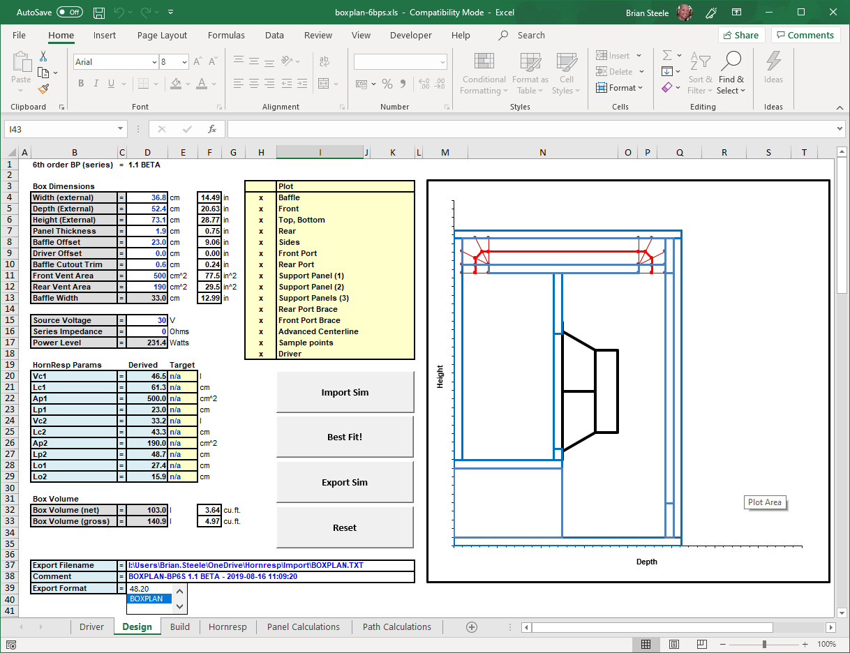

Ok, I've uploaded a new version of the workbook. This version includes the option to choose the format of the Hornresp file.
Thanks Brian.
Boxplan-bp6s.xls and boxplan-bp6p.xls both work perfectly with the proposed new release of Hornresp when the BOXPLAN export format option is selected. If you want to simplify things, you could perhaps remove the 48.20 export format option from your workbooks. While the file can be exported to Hornresp it cannot be used to update the wizard, which limits its usefulness, and could potentially cause confusion among users. Also, you could perhaps just save all your BOXPLAN workbooks as .xls rather than .xlsm or.xlsx files to overcome the compatibility issues. All versions of Excel should be able to open .xls files.

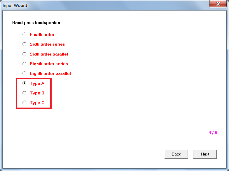

The BP5, BP7 and BP9 band pass enclosure options have been renamed as follows:
BP7 is now BPA (Type A band pass enclosure)
BP5 is now BPB (Type B band pass enclosure)
BP9 is now BPC (Type C band pass enclosure)
Existing BP5, BP7 and BP9 records will be automatically updated to the new designations. Attachment 1 refers.

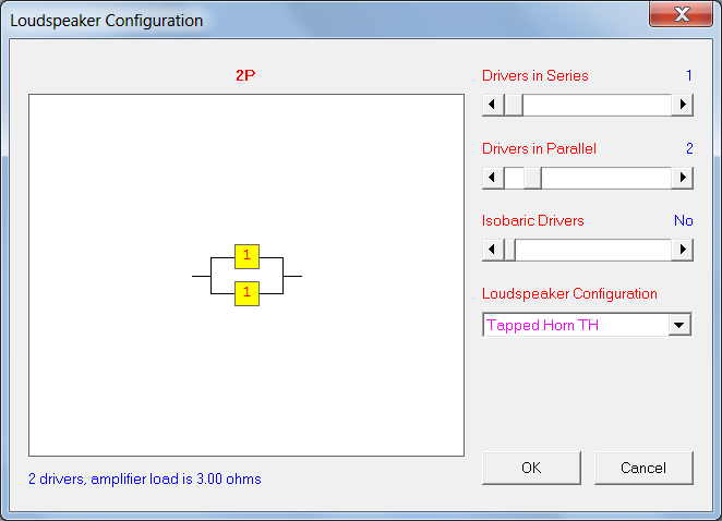

The name of the Driver Arrangement Tool has been changed to Loudspeaker Configuration tool, to more accurately describe its current functionality. Attachment 2 refers.

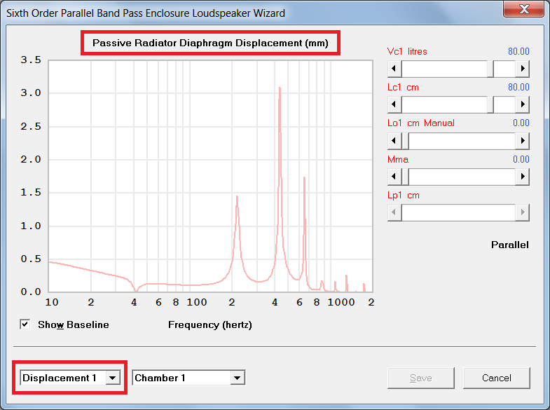

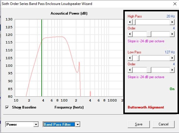

The band pass loudspeaker wizard now shows passive radiator diaphragm displacement, rather than particle velocity at the surface of the PR diaphragm. Attachment 3 refers.
CHANGE 4

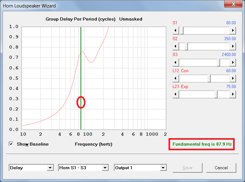

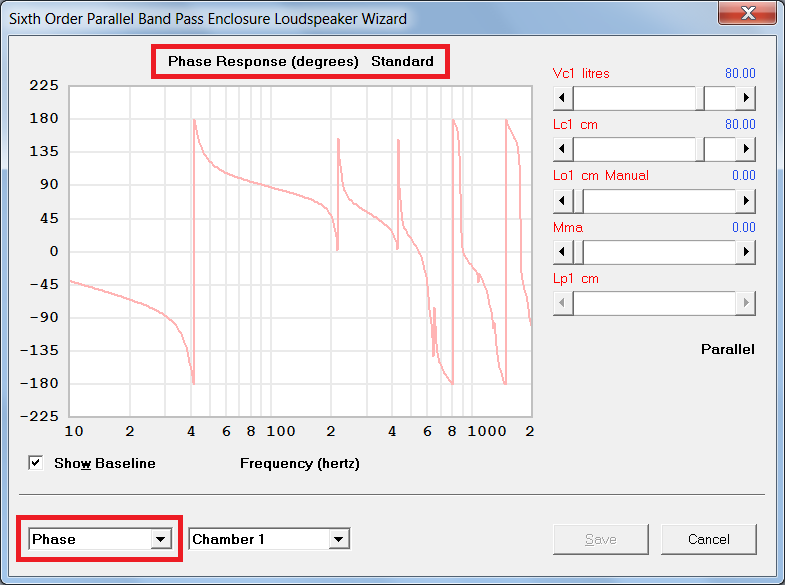

Phase and group delay charts have been added to the band pass loudspeaker wizard. Attachment 4 refers.
(Press the Ctrl key and double-click anywhere on the group delay chart to switch to the group delay per period chart. Press the Ctrl key and double-click anywhere on the group delay per period chart to switch back to the group delay chart.)
CHANGE 5
The fundamental resonance green marker line, when activated, is now also shown on the loudspeaker wizard phase response, group delay and group delay per period charts. Attachment 5 refers.

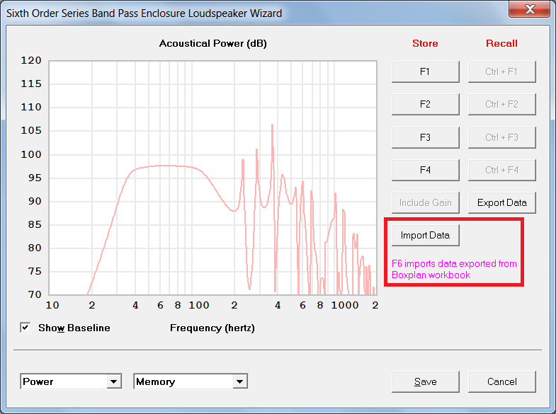

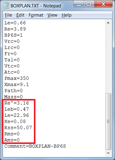

Advanced driver parameters recently added to the data files exported from BOXPLAN loudspeaker workbooks are now taken into account. Attachment 7 refers.
CHANGE 8
Data exported from the BOXPLAN band pass loudspeaker workbooks can now be imported into the band pass loudspeaker wizard. Attachment 8 refers.
I've checked this out and it seems to be working fine, not only with the bandpass workbooks, but with the slot-vent workbook that I recently updated.
