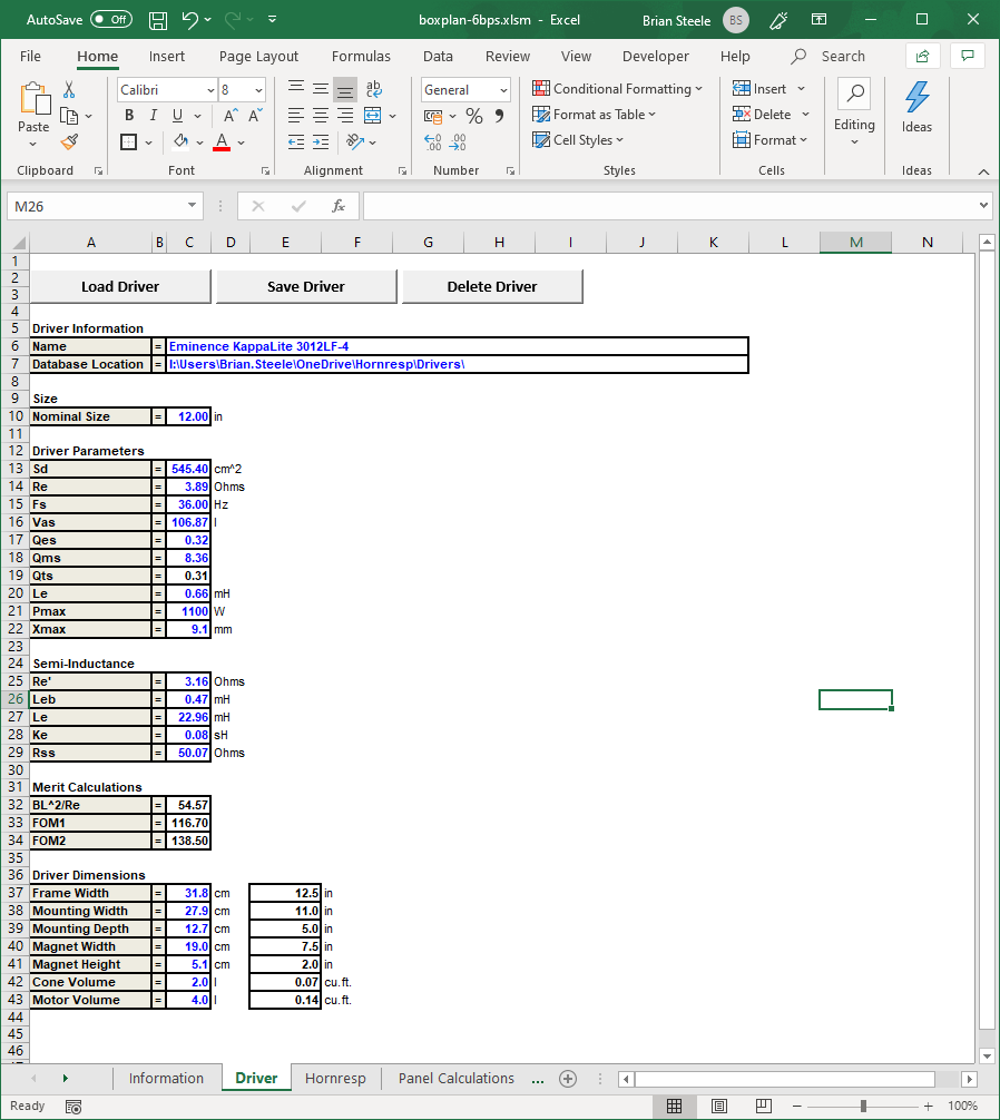

Hi Brian,
Just to confirm final arrangements, files exported from BOXPLAN workbooks will need to contain the parameters listed in the attached example, with driver default settings being specified as detailed below.
1. To specify lossy inductance, change the traditional driver voice coil inductance parameter label from Le to Le1.
2. To specify semi-inductance, advanced driver parameter values for Re', Leb, Le, Ke and Rss must all be non-zero.
(If both lossy inductance and semi-inductance are specified, semi-inductance takes precedence and will be the default setting recognised by Hornresp).
3. To specify frequency-dependent damping, advanced driver parameter values for Rms and Ams must both be non-zero.
The initial imported default options can be changed by the user on either the main input parameters window, or in the loudspeaker wizard.
You may wish to include the above information in your BOXPLAN user instructions.
I won't be incorporating support for lossy inductance in the workbooks, so no need to worry about that.
The rest looks pretty straight-forward.
Too late - it's already included. There is no requirement to use it though, if you don't want to.
How will this affect the inter-operation of my other workbooks though, the ones that are used to model TLs and THs, for example? Would I just need to update them to use the BOXPLAN ID?
I am not able to check the contents of your BOXPLAN export files because I only have Excel 2003, and cannot open your .xlsm and .xlsx files to create sample export files. Have you considered saving your workbooks as .xls files instead, so that they can be used by a wider audience? I assume all later versions of Excel can open .xls "legacy" files?
If your existing files end at Xmax followed by the comment line, then as well as changing the first line from ID=29 to ID=BOXPLAN, you will need to insert the parameters Path, Mass, Re', Leb, Le, Ke, Rss, Rms and Ams between Xmax and the comment line. The values of the new parameters can all be set to zero if you like.
In other words, all files will need to have the same format and length as the BOXPLAN.TXT reference example I provided earlier.
