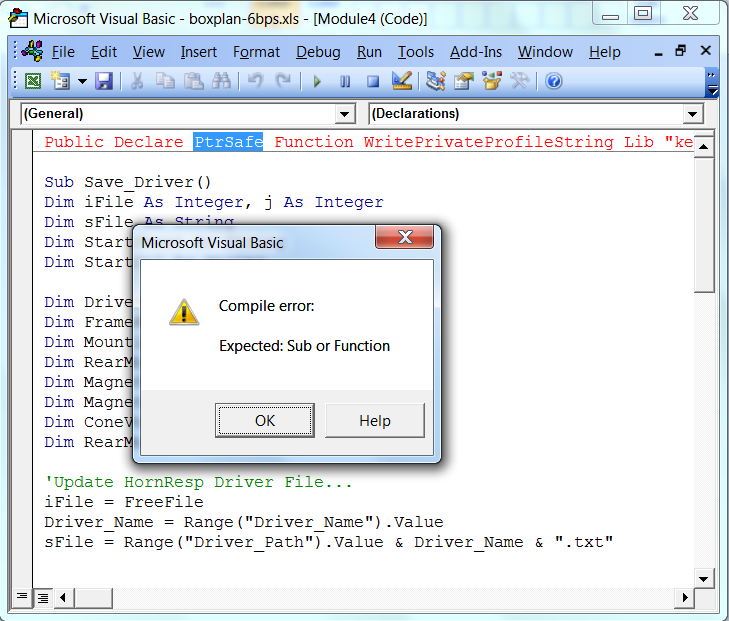

Hi Brian,
Thanks for creating an Excel 2003 version of your BOXPLAN 6BPS workbook.
Unfortunately when I attempt to open the boxplan-6bps.xls file I get the VBA compile error shown in the attachment.
Kind regards,
David
I uploaded a new copy with the "PrtSafe" removed. That's a requirement for the workbook to work properly on 64-bit versions of Office, and likely not needed here...
Thanks Brian, it works just fine for me now.
