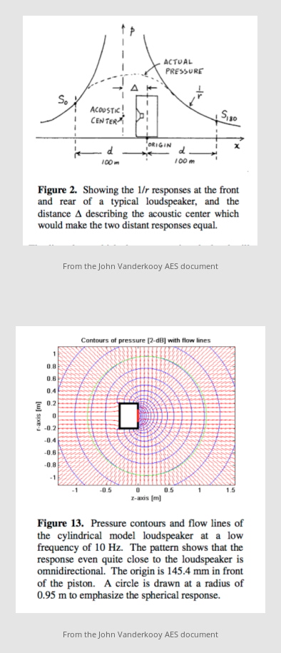

Glad to see this model for defining the effective path length between front and rear sources of dipole woofers has finally made it into Hornresp. As usual, you did a great job of cleanly inserting/implementing it into the existing Hornresp framework 🙂. I have found it to closely match low frequency measurements for H-frame as well as flat baffle dipoles. Additionally, the flat baffle results match nearly perfectly with those calculated using BTM diffraction methods.
For those unfamiliar with the acoustic center concept, a pictorial description is shown in Attachment #1. Basically, at low frequencies (baffle and driver are small relative to the wavelength) the source can be treated as a point. However, polar measurements indicate that this point source is not located at the driver cone but rather a distance in front of the baffle/driver. The distance to the acoustic center is mainly defined by the size of the baffle, but is also affected by the size of the driver, and the depth of the cabinet. John Vanderkooy’s set of papers in JAES on the acoustic center concept for loudspeakers at low frequencies was the main technical source for the model. Many thanks to mwmkravchenko for help in tracking down these papers and many of the references. For Hornresp implementation, the concept was extended to account for mirroring of the source and enclosure/baffle as you move from 4-Pi space to more restrictive radiation spaces.

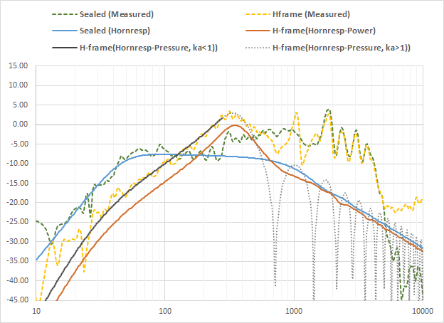

As a brief example, here are some measurements I took earlier this spring for a Peerless SLS-12 woofer in a 64 liter sealed enclosure and a short H-frame compared to Hornresp.

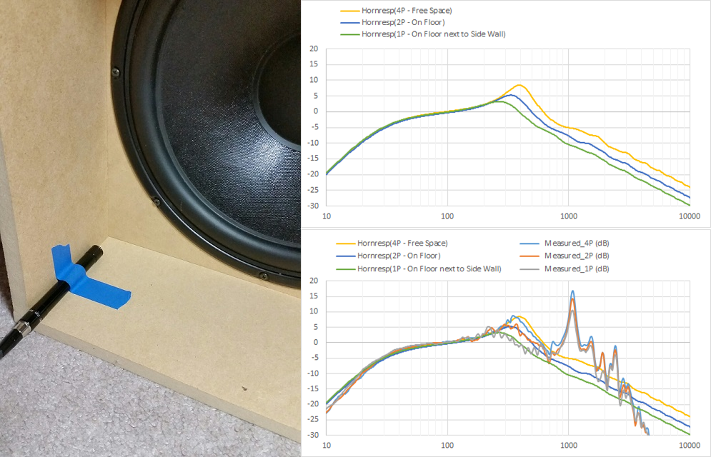

Attachment #2: Before taking outdoor measurements, I grabbed a few measurements of the H-frame cavity resonance. I was curious how well the Hornresp radiation impedance model worked for different radiation spaces. Looks pretty good to me :up:. 4-Pi measurement was with H-frame on stand in middle of garage. 2-Pi was with H-frame on the floor. 1-Pi was with H-frame on floor up against one wall.
Attachment #3: Moving outdoors, I took measurements of the same SLS-12 woofer in a sealed enclosure and H-frame at a distance of 2m. Although wind was causing more LF noise than I would have liked, you can clearly see that the level of the LF pressure response calculated by Hornresp for the H-frame lines up very well with the measurements relative to the sealed response. This indicates that the calculated path length between sources is correct.

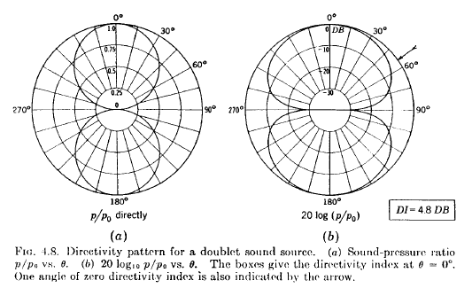

Attachment #4: Note that the power response for the H-frame in Attachment #3 is roughly 4.8dB below the measured on-axis pressure response. This is because of the DI (Directivity Index) inherent in dipole sources. In other words, a dipole source will measure 4.8dB louder on-axis than a monopole source of the same strength. Or conversely, for the same on-axis SPL level, a dipole source radiates less total acoustic energy into the room than a monopole.
Awesome stuff! A great addition to the Hornresp simulation abilities. Some of the sims versus the measurements are pretty close! Depending on the nearest reflective surface in the measurements some of the sims could be even closer.
Work well spent and greatly appreciated.

Indeed. I had hoped to have time to measure in a large gymnasium like I had done in the past for my ESL theory-vs-measurement work, but have not been able to work it into my schedule yet. Fortunately the driveway measurements were adequate to confirm the SPL level and trend was modeled correctly. That has been the missing piece for modeling H-frames and flat bafffles in Hornresp...deciding on the appropriate path length to use between the front and rear sources.

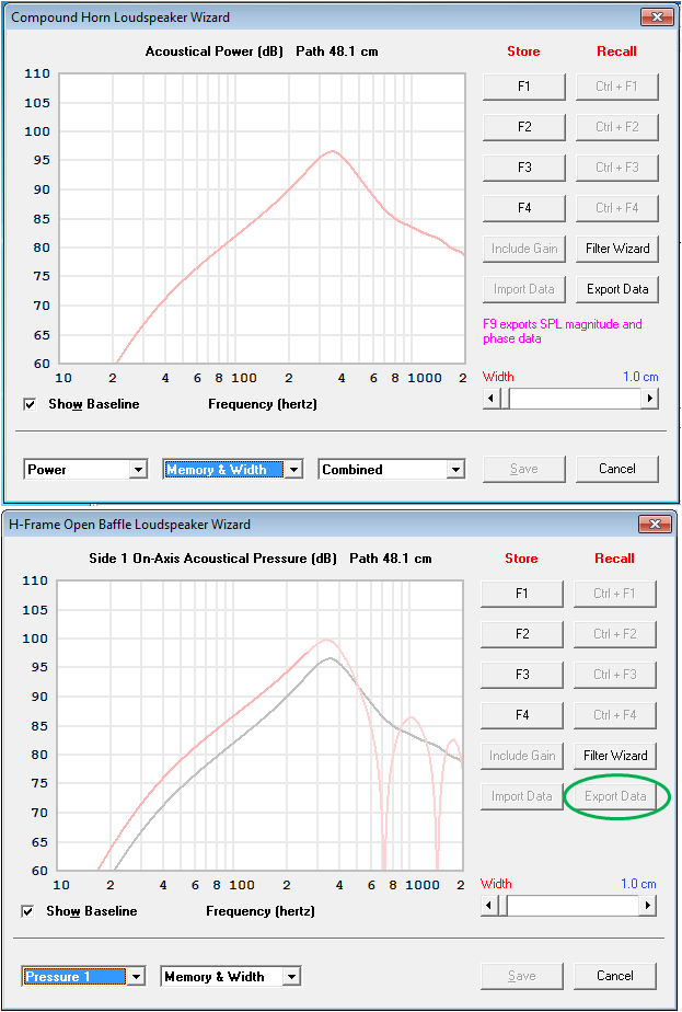

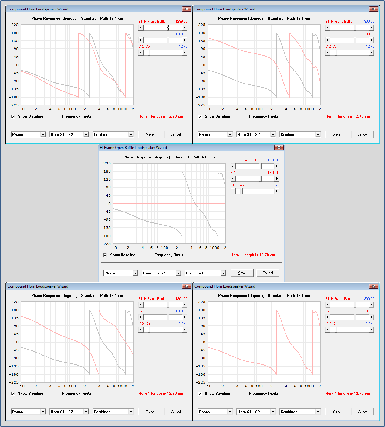

@ D.McBean,
I noticed a couple things when playing around with the H-frame Wizard tonight.
1) If S1=S2=S5=S6, then phase response is plotted as zero.
2) Small changes in any of these areas results in 4 other unique phase plots. Attached pic shows changes with S1 and S2, but similar behavior is seen with S5 and S6.
3) There doesn't seem to be a way to export the pressure responses, only the power response. This may be as intended but thought I would mention it anyways.

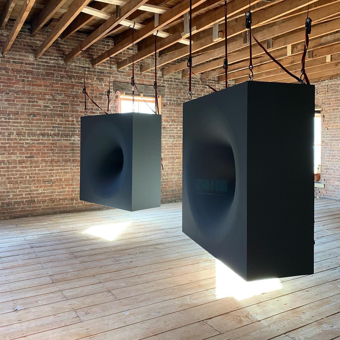

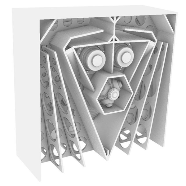

On another note David, at 10,000 posts I'd like to thank you for a fantastic contribution you have made to the world of DIYAudio.
To celebrate I've attached some pictures of a more complex build that used Hornresponse to model several parts.
attachment.php
attachment.php
Thanks again for your efforts in continual development and support! :cheers:
