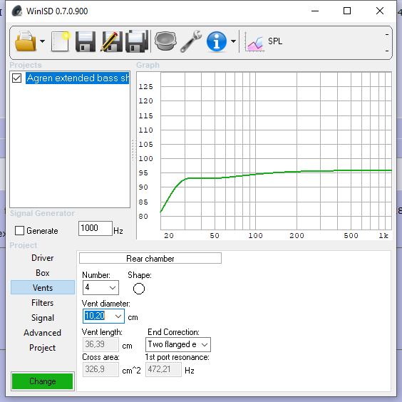

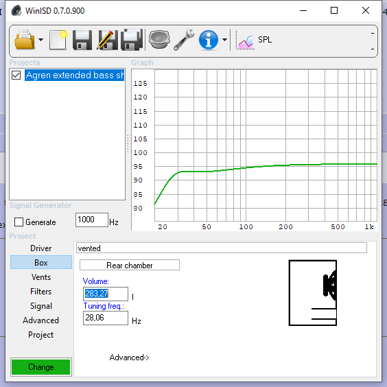

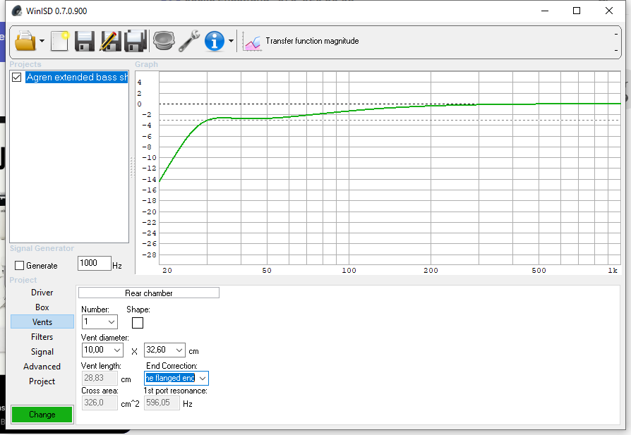

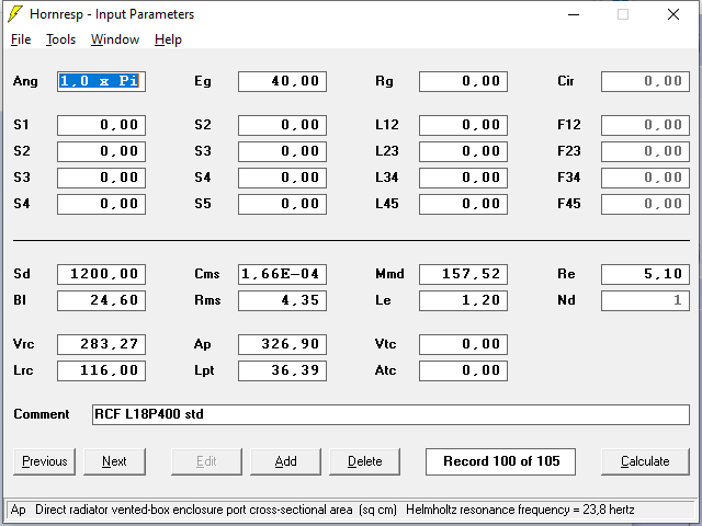

Not sure what version of WinISD you are using, but my old copy tells me that for a box volume of 283 litres, a tuning frequency of 28 Hz and a port area of 327 square cm, the vent length should be 28.5 cm, not 36.4 cm.
In Hornresp, for Ang = 2 x Pi, Vrc = 283, Ap = 327 and Lpt = 28.5, the Helmholtz resonance frequency is 28.0 Hz - exactly the same as for WinISD.
Then the current version of WinISD is buggy.

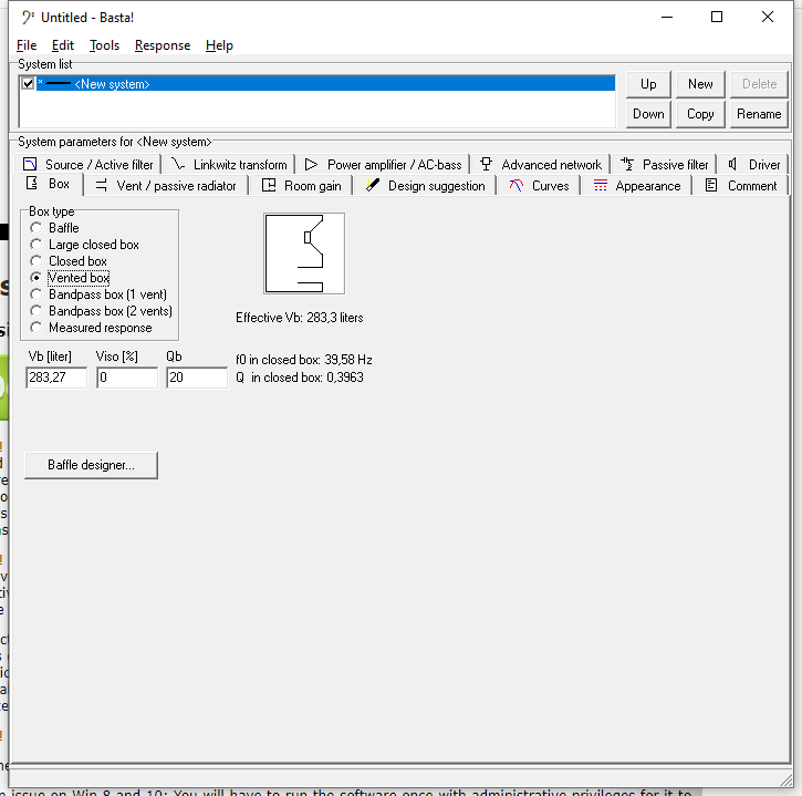

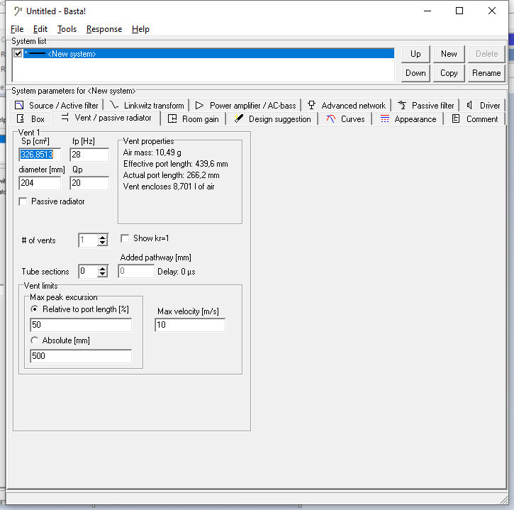

I simulated in Basta! as well. Same result as Hornresp, give or take a cm port length or a hertz in helmholz resonance.

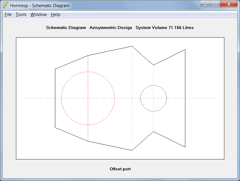

Even though the amount of work involved to fully integrate the feature is massive, I decided nevertheless shortly after your original Post #10428 to proceed anyway, but not in the manner that you have suggested above. I have been working on the code for the past month, and still have some way to go. It will be possible to specify an enclosure with an offset driver together with either an offset port tube or an offset passive radiator, as shown in the attached example (for an offset port).

Changing end correction has no effect. You are right. The tube length shortens.
Hi Mårten,
For a given enclosure volume and port tube cross-sectional area and length, changing from both ends flanged to one end flanged and the other end unflanged should increase the Helmholtz resonance frequency slightly. Changing from 4 tubes to one tube having the same total area will also affect the tuning frequency, due to the different loading conditions at the ends of the tube/s.
For a bass-reflex loudspeaker, Hornresp assumes a single port tube with the radiating end flanged and the internal end unflanged (this is different to how it is shown in the schematic diagram).

Hi Mårten,
Kind regards,
David
Thanks David!
Going from 28 cm (one tube) to 36 cm (four tubes) is reasonable?
