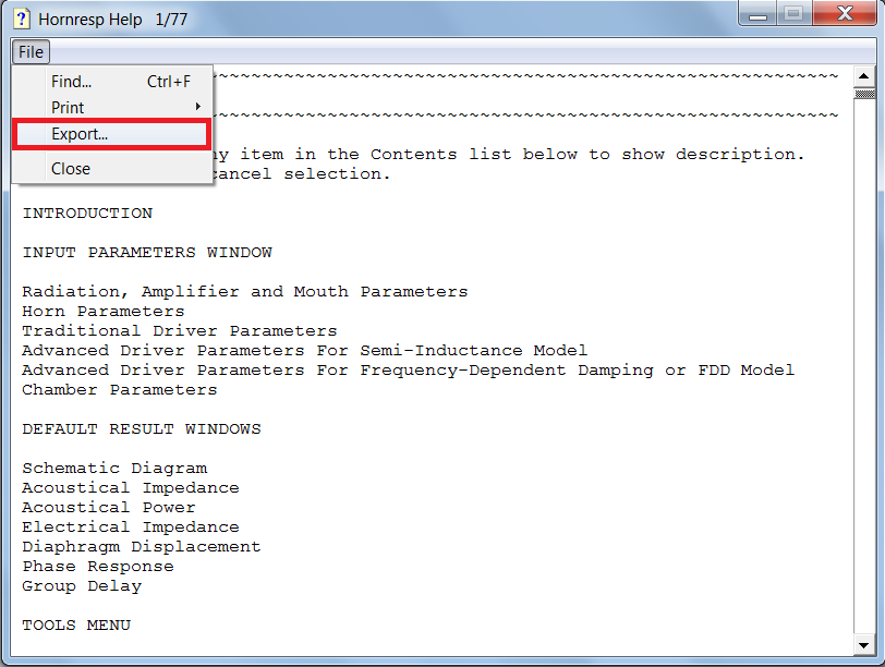

FYI you can change the .hlp extension to .txt if you want 😉
I copy/change it to .rtf to change fonts color, bold, etc., just wish the hot links, FIND feature came with it.

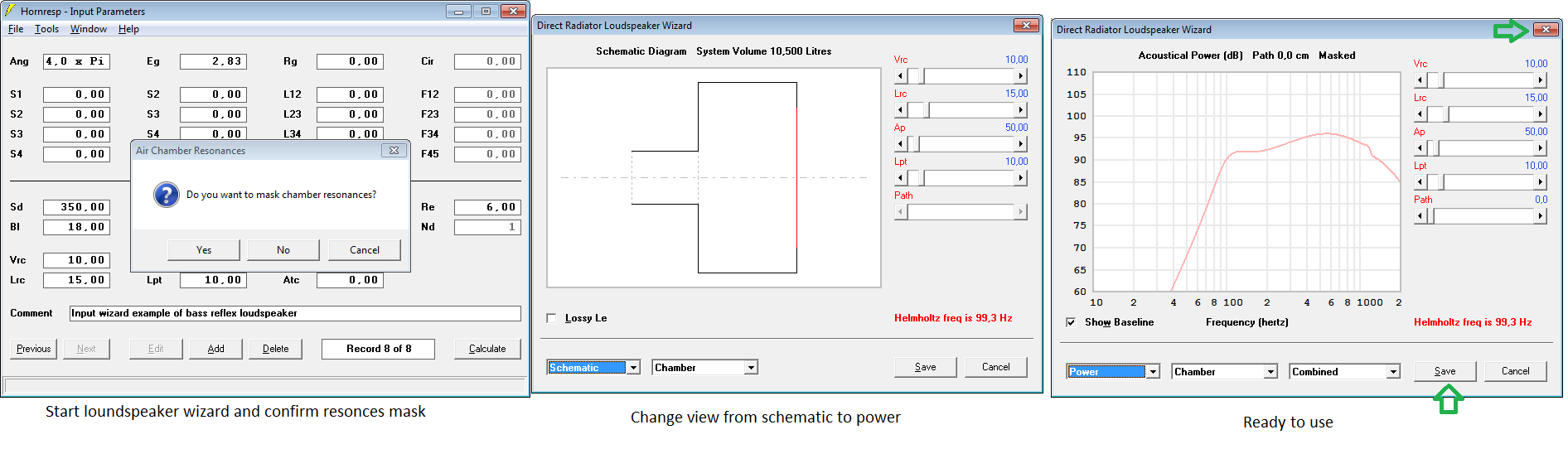

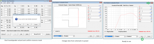

In order to make Loundspeaker wizard flow smoother, might a ask for another small change 😀
Currently after manually make optimizations using slide bar when we click on save button it will also close loundspeaker wizard window backing to the input screen, but it happen that the user sometimes wants to stay in the loundspeaker wizard windows and try to optimize even further, so do you mind to separate the function (button) "save" from "close"?
Note1: The regular button to close with X is already there in the top right, so...
Note2: it would be interesting also to deactivate the button save while the user don't change any value, so it's a visual feedback to remember the user that nothing was changed, so the button would be active only if one ore more parameter were changed.
Relaunching loundspeaker wizard all time isn't that smart, mainly when we need to confirm resonances mask and change from schematic to power or other window all time.
It took less than one minute to find the most appropriate "manually set values" (rounded to convenient numbers).

Hi Marcelo,

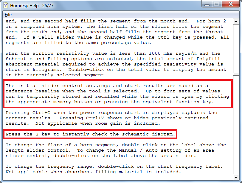

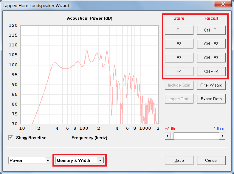

In that case, the Memory Store / Recall functionality should be used. Attachments 1 and 2 refer. Another way is simply to reset the baseline to the currently-optimised values by pressing the Ctrl+Alt+B keys. This will establish a new reference to compare against.
I will give it some thought.
It necessary for the loudspeaker wizard to be relaunched each time to bring in any changes made on the main input window, and to re-initialise particular baseline settings.
To remove the resonances prompt message, use the Tools > Options menu to permanently set the required masking option.
Press the P key to directly select the power chart.
Kind regards,
David

Thanks David, I need to say that I used only one time the function Memory Store / Recall and forgot about it, I looks like I need to improve my own memory 😛

Hi GM,

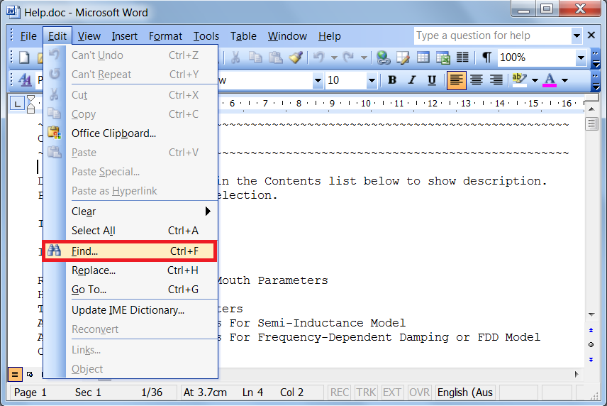

The Hornresp Help file was set up to be exported as a text file using the File > Export menu command. Once exported, the file can be opened in Microsoft Word for editing, highlighting and reformatting as desired, and then saved as a Word document (*.doc) file for future reference.
Word has a Find feature 🙂.
Greets!

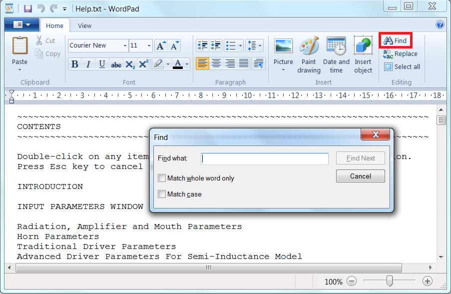

Thanks for reminding me as I know you posted it ages ago when I had issues with using it, but haven't had OFFICE available for years now and only remembered I could change the extension to use in WordPad.
WordPad also has a Find feature 🙂.
Thanks! Shows how much attention I pay to toolbars! 😱 Since it's a 'stripped down' WORD doc, just assumed it didn't have it, like Foxit appears to have a functioning 'create' feature till I tried to use it. 😡
This refinement will be in the next release.
