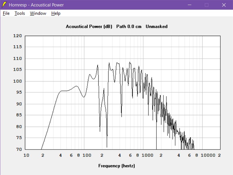

Vented Offset Driver Enclosure using HR's default parameters.

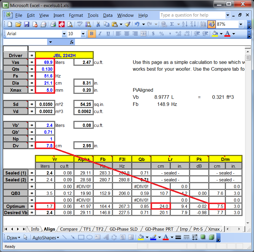

Do you mind to share just one example of the suboptimal results for better understendment from my side :)

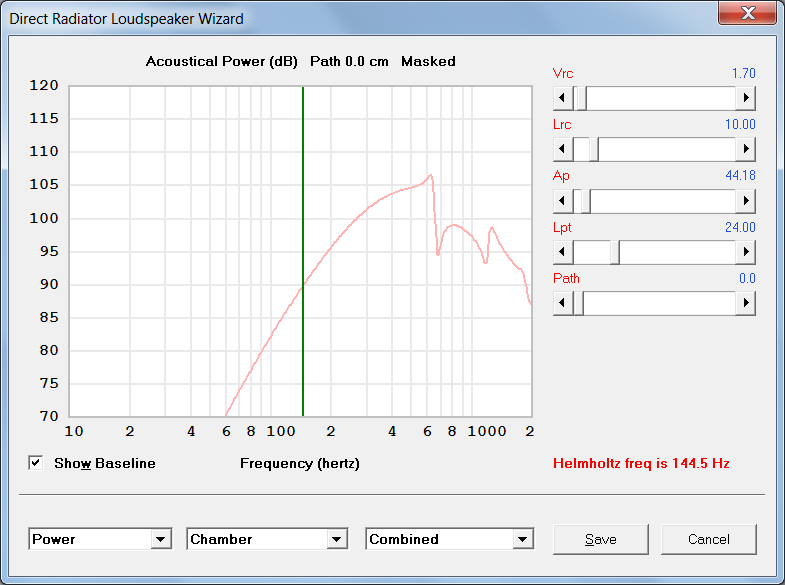

Hi Marcelo,
Entering the Hornresp default driver parameter values into the Adrian Mack spreadsheet gives the following "optimum" outputs, as shown in Attachment 1.
Vr = 1.7 litres
Drm = 7.5 cm
Lr = 24.0 cm
The Hornresp inputs become:
Vrc =1.70 litres
Ap = 44.18 sq cm
Lpt = 24.00 cm
Resulting in the response shown in Attachment 2.
Kind regards,
David

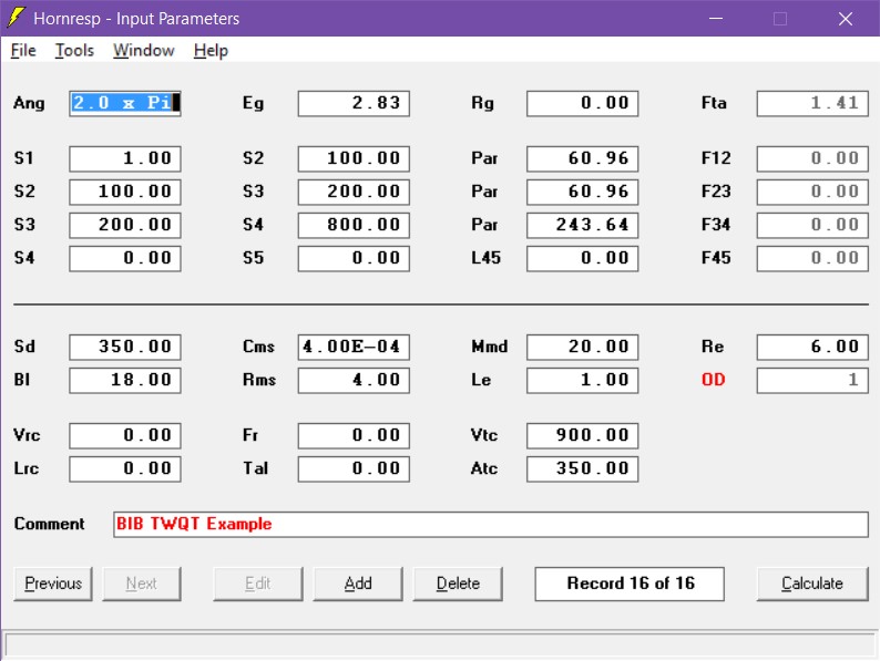

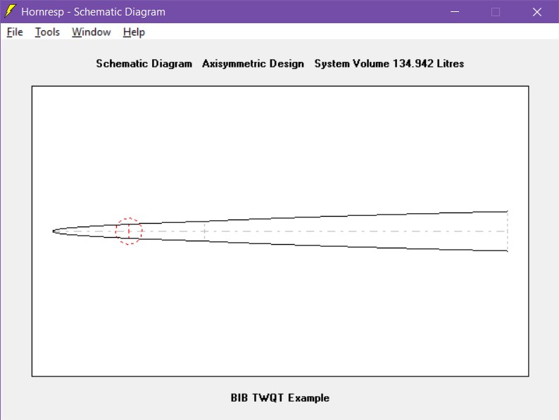

Thank you BP1Fanatic and David. I tried a sim but not sure if makes sense. I used a 0.41 * path length offset and set the horn area at that point = Sd. Then did the rest my eyeballing the schematic shape.
Your model makes perfect sense! The problem is the BIB TQWT does not provide any dimensions to work with.
