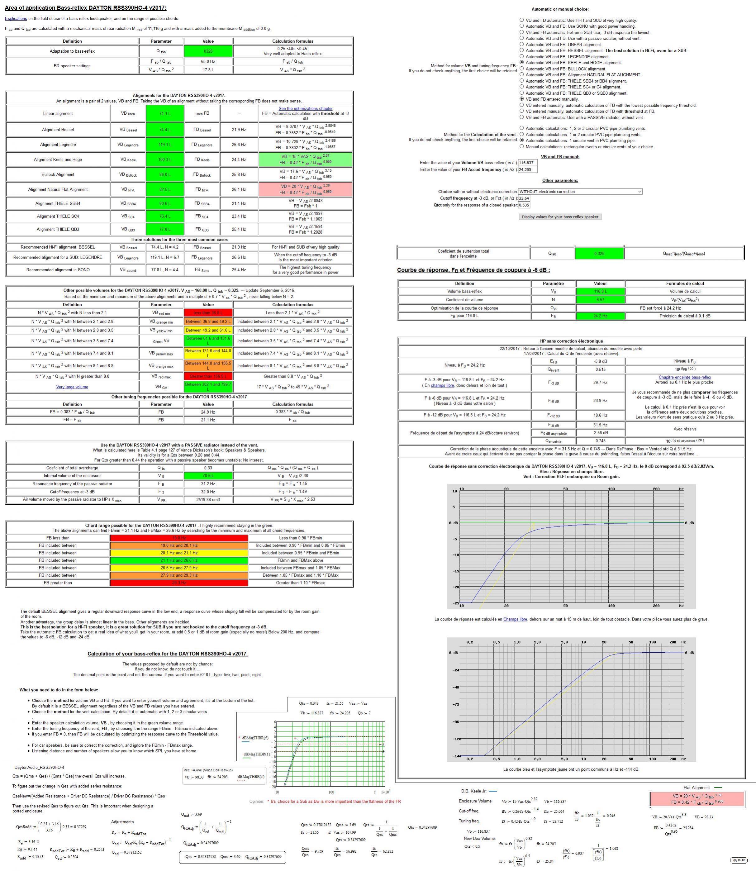

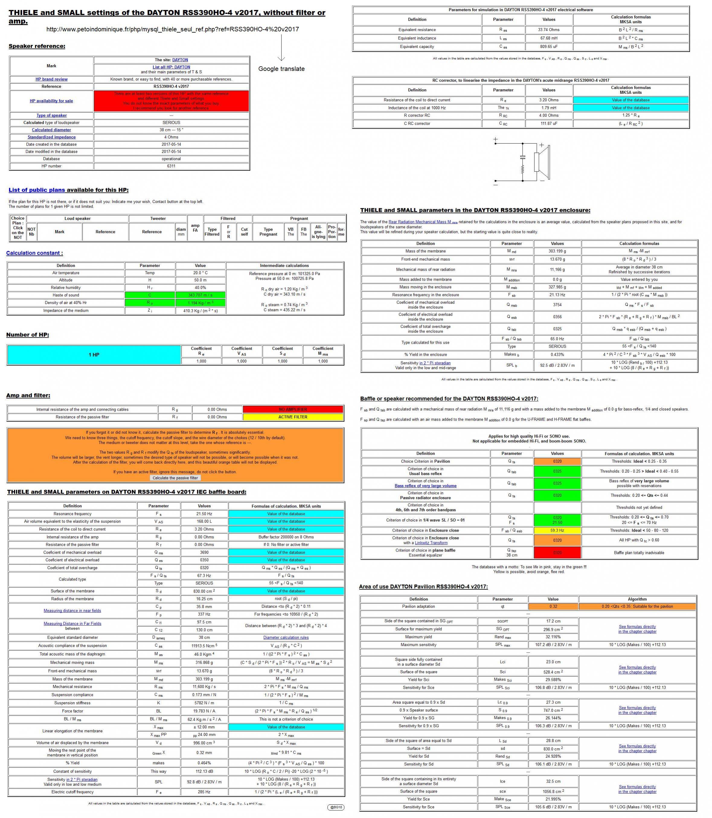

Hi David,All
My take:
b🙂

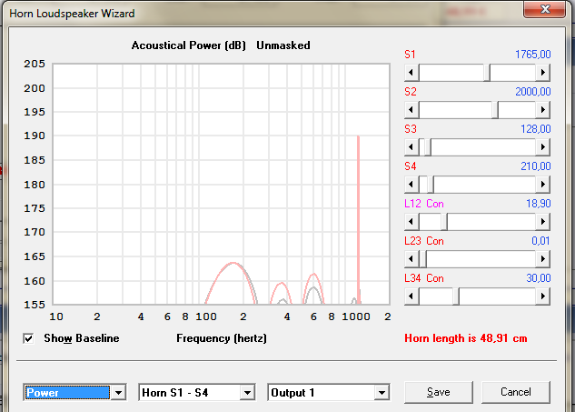

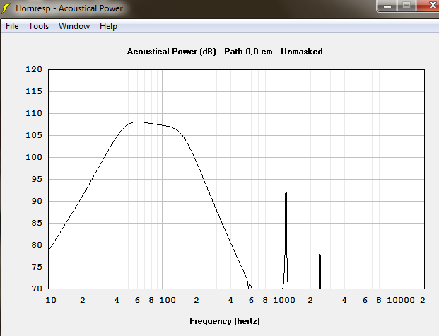

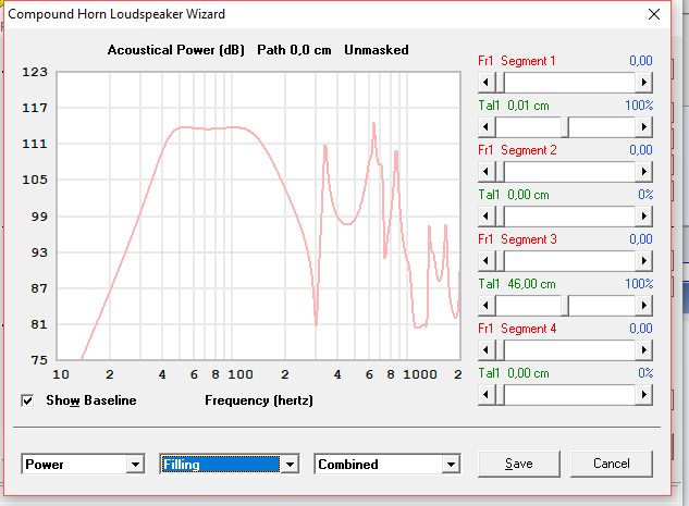

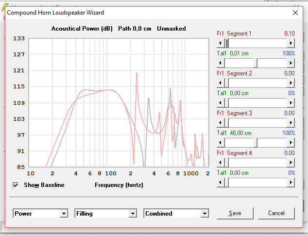

Hi David,
Got a error repport ! 😛
Strange result with wizard when changing FR1 and FR3 from 0 in this simple CH 6th BP parrallel.
I too got strange result somewhere else using multiple passive radiator, in wizard VS in calculated figures. I'll give some example later, but from what i recall , one of the two resulting frequency response seems to have 1 more PR.
  • strangeCHfilling.txt
Hi papasteack,
Many thanks for the feedback. I see what you mean, there is definitely something wrong somewhere 🙂. I need to investigate...
A specific example in due course would be very helpful, thanks.
Kind regards,
David

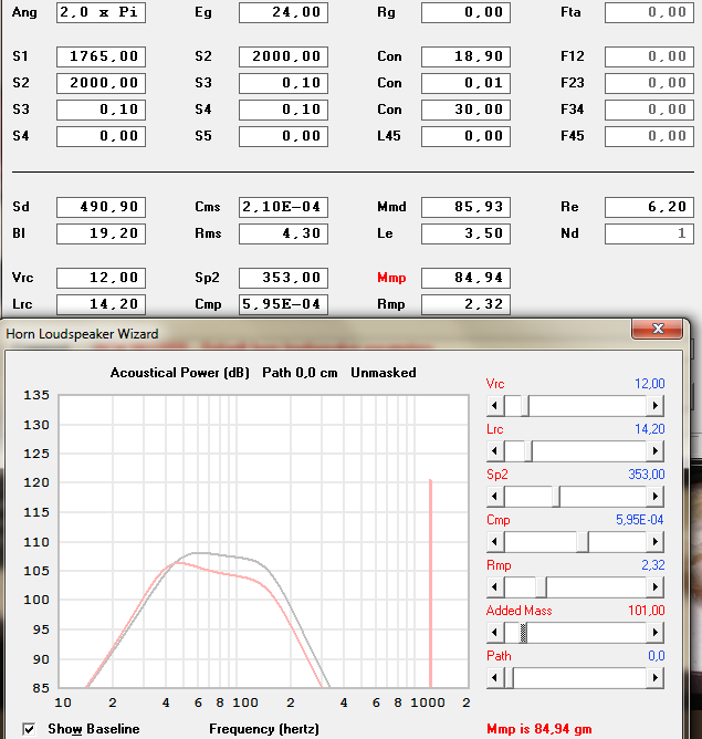

Ok, i can give you the clue for a first problem with response between wizard and calcul using passive radiators.
The problem is when adding mass to multiple passive radiators.
For this example i add 51g on two passive radiator. The result in wizard is the same as adding when 101g when calculating.
First capture is wizard, moving added mass from 51g (grey result) to 101g.
Second capture is calculated result.
From help, added mass is added mass to each cone. Which result is the good one ? 51g to each cone or 101 g ?

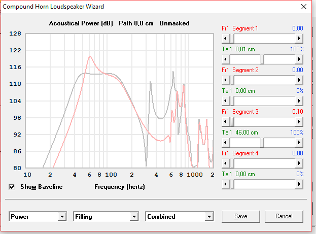

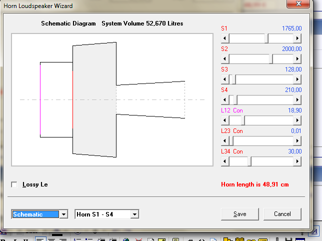

...next, another repport about filling, again ^^
  • PR.txt
    PR.txt
And with same record, i got strange result using filling, but i though at first it came from the use of false closed back with 0.01cm² pipe. But here i found the same result moving this port from 0,01cm² to 128-210 cm²... ~ 164db @ 180 hz...wow 🙄
Hi papasteack,
I have found what is causing the problem with the filling results. It is great that you picked it up, as the bug would have been there for quite some time.
The following statement appears in several parts of the program:
If CompoundHorn Or CH1Flag And N = 4 Then
For the logic to be correct the statement should actually have been written as:
If (CompoundHorn Or CH1Flag) And N = 4 Then
It will be fixed in the next release.
That's how easy it can be to wreck the results 🙂.
I will have a look at the passive radiator added mass problem as soon as I can, but unfortunately Hornresp Santa won't be bringing you any other presents this year 🙂.
Selecting a passive radiator in place of a segment by double clicking on L12-L45 would be just too messy to implement. Things are complicated enough already...
Kind regards,
David
