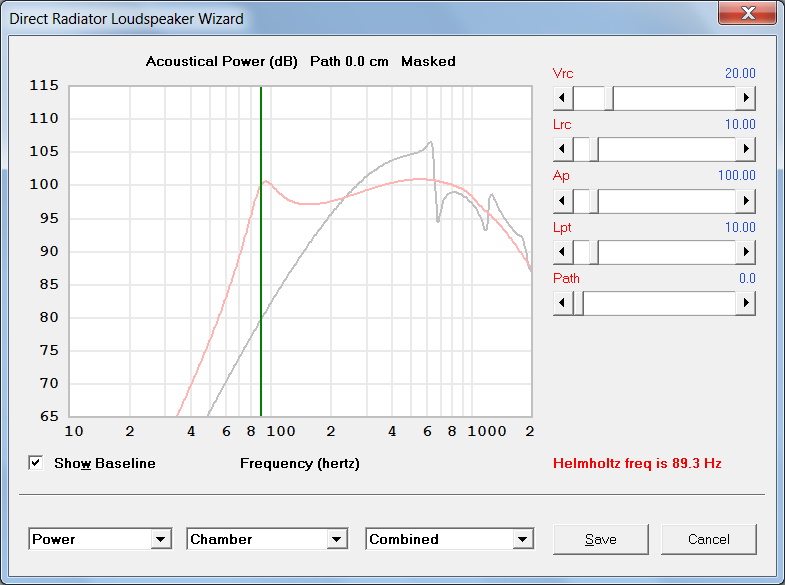

Further to Post #8690.
In the attachment below, the grey trace shows the power response obtained using the optimised values calculated by the Adrian Mack spreadsheet, and the red trace shows the response obtained by manually setting the slider values to generate the "best" response. The Hornresp default driver was used in each case.
Spreadsheet-calculated values:
Vrc = 1.70 litres
Ap = 44.18 cm^2
Lpt = 24.00 cm
Manually set values:
Vrc = 20.00 litres
Ap = 100.00 cm^2
Lpt = 10.00 cm
It took less than one minute to find the most appropriate "manually set values" (rounded to convenient numbers). The final result would indicate though, that the Hornresp default driver is perhaps not particularly well suited for use in a bass reflex system :).

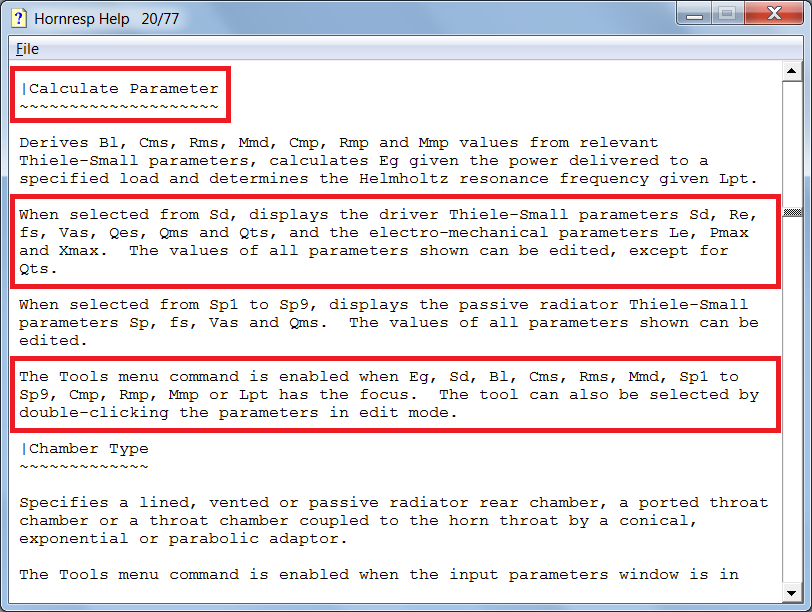

Every feature available in Hornresp is documented in the Help file, including double-clicking the Sd parameter in edit mode to activate the Thiele-Small Calculate Parameter tool.

Pic 1
Calculate Parameters...
I am not looking to calculate anything, I am trying to enter parameters, so I would instinctively look under "Entering Parameters".

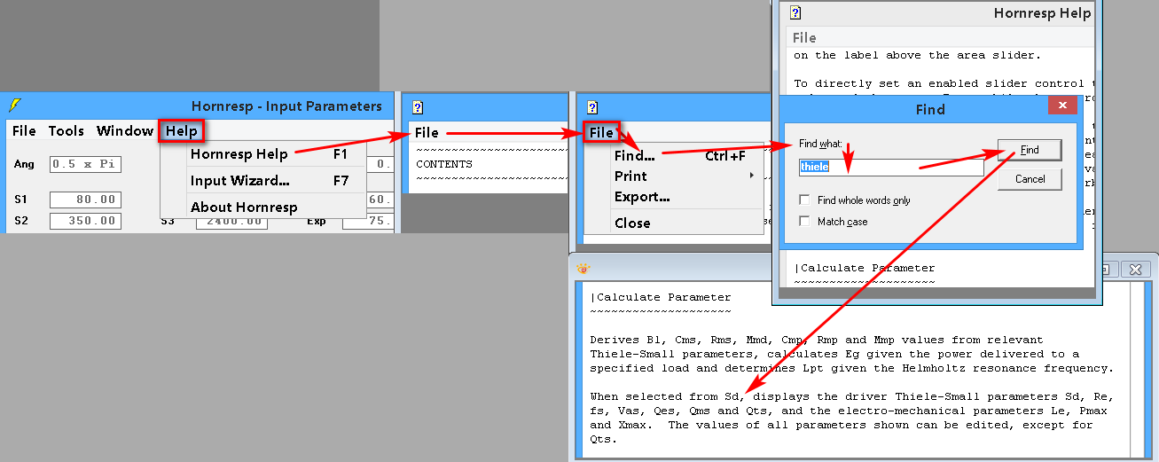

Pic 2
When selected from Sd... That doesn't instruct me to double click the Sd value box to reveal the the TS parameters... While that might mean the same thing to some people, I don't get the intended meaning from that wording.
Even if the words weren't clumped on top of each other, I would still struggle to find that meaning it that wording.

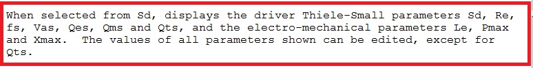

Pic 3
After reading it several times I still don't understand the hidden meaning in the words.
Coming from a senior licensing specialist background I only speak black and white.
So let's break it apart and see if any sense can be made of it...
The Tools menu command is enabled when blah has focus.
The only tool menu I know of as a programmer is the whole top bar of the program. So it is disabled (meaning nothing can be used or selected) until one of a number of specific items has focus. Derived common sense would tell you not to select the actual item itself, but the associated text box. Although I have written programs before where I have triggered an activity by clicking on the actual text as well so maybe it takes two goes.
The tool (which tool?) can be selected by double-clicking the parameters in edit mode. Edit mode when did we enter an edit mode? So we are clicking some parameters once we are in an edit mode?
None of those instructions amount to double click the Sd text box to reveal the TS parameters. As I said I only speak English and bad English.
