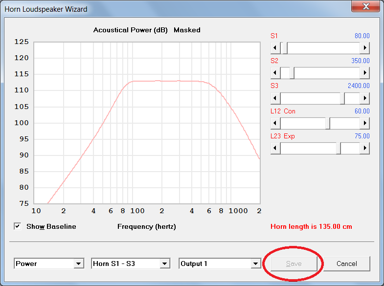

CHANGE 1
The loudspeaker wizard Save button is now not enabled until a parameter value is changed. Previously the button was always enabled. Post #8738 refers.

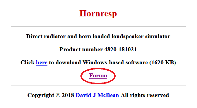

A link to this diyAudio forum thread has now been added to the Hornresp download webpage.

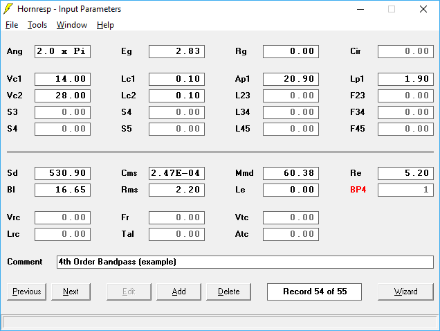

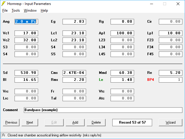

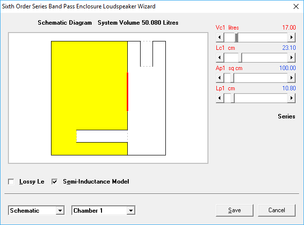

Hi, I have a small suggestion for improving the BP sim component of Hornresp...
When switching from a 4th order BP sim to a 6th order sim (series), it might be best not to switch the Vc1 and Vc2 volumes in the process, i.e. let Vc1 remain the volume that's vented to the outside.
I was doing some "sanity checking" of a design by changing the sim from a 4th order BP to 6th order series tuned BP. If the internal vent is made really small, the response curve should be the same as that predicted by the original 4th order BP sim, but it wasn't when I tried to do that, and I eventually figured out that it wasn't the same because the volumes were being swapped when the type of BP was switched from 4th to 6th :).
I'm re-writing the entire BP section of my The Subwoofer DIY Page site to focus on the use of Hornresp rather than the old lumped-mass modelling equations, and came across this. I came across a few others as well, which I will document in other messages when I get a chance.

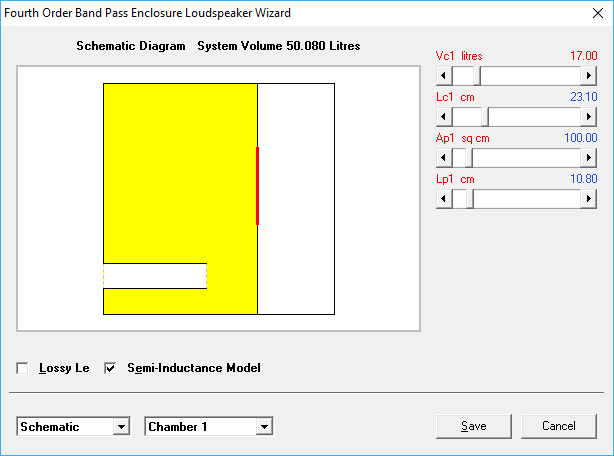

Hi Brian,
The chamber numbering rules I decided upon for the BP4, BP6S, BP6P, BP8, DBR and ABC enclosures (configured as shown in the loudspeaker wizard schematic) are as follows:
For enclosures with left and right chambers (ie. BP4, BP6S, BP6P, BP8):
1 = Left chamber
2 = Right chamber
For enclosures without left and right chambers (ie. DBR, ABC):
1 = Top chamber
2 = Bottom chamber
Letting Vc1 be the volume that vents to the outside could become an issue with BP6P and ABC enclosures, where both chambers have external ports.
I would rather not change from the existing convention. When slider values are changed in the wizard it is always good practice to check with the schematic to confirm what component is being affected. Simply press and hold the S key to temporarily show the schematic.
Even when the chamber volumes are correctly allocated, and the interconnecting port tube is very small, the responses will still be a somewhat different.
You have been busy... :).
Thanks, your feedback is appreciated.

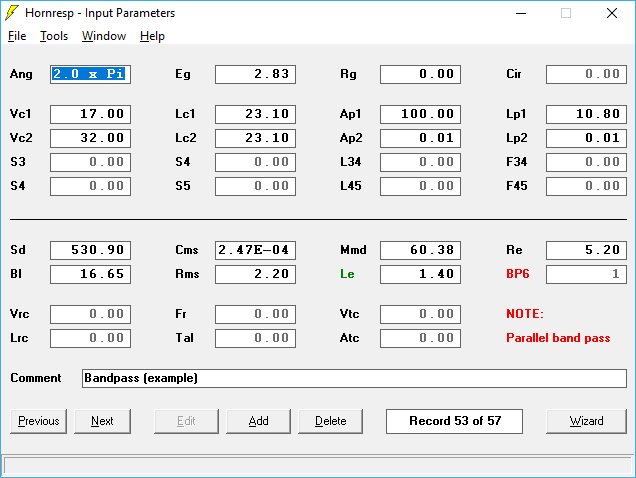

1 = Left chamber
2 = Right chamber

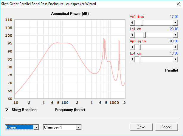

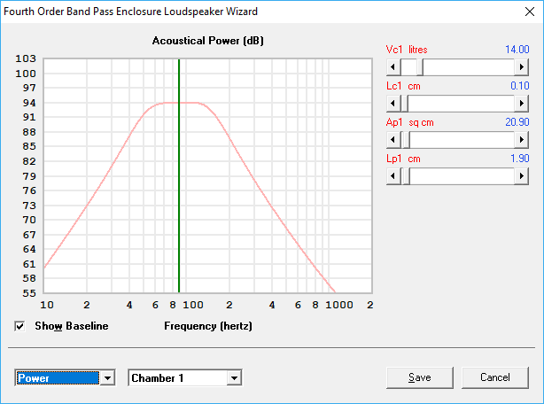

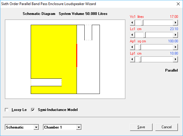

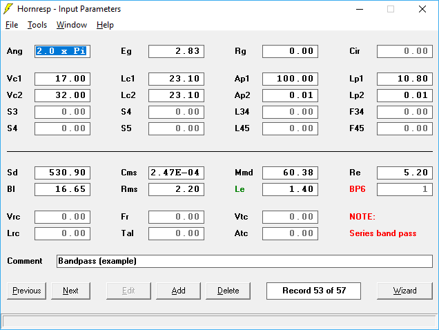

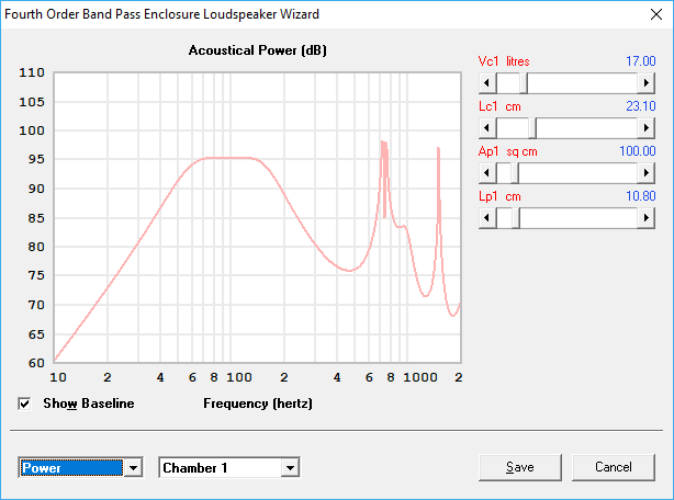

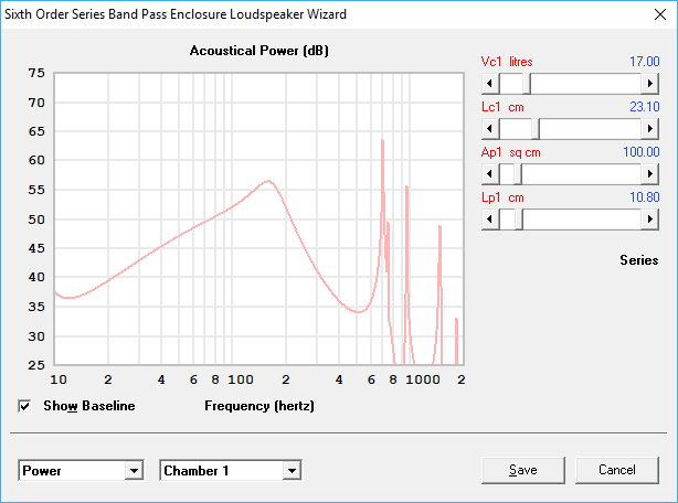

Yup. The issue is that, when switching from BP4 to BP6P, the chamber that vents to the outside is switched, making it difficult to compare what would happen if a BP4 alignment is converted to a BP6S alignment by adding a vent on the baffle holding the driver (like what KEF did with the last version of their Coupled-Cavity Reference series, if I remember correctly). You have to swap the settings for the volumes around in the sim. This doesn't happen when you switch from BP4 to BP6P, and the "sanity check" works if you do that switch and leave the size of the second vent very small - the predicted frequency response remains very close. See images below:

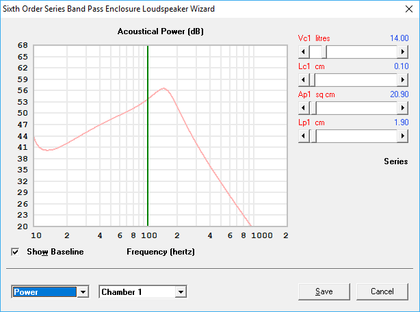

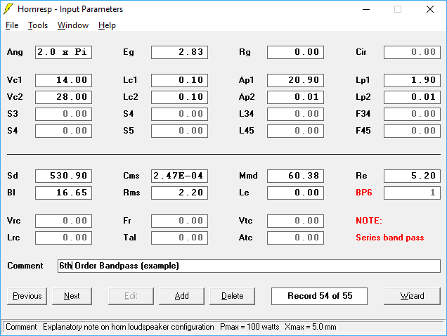

Image #1: BP4 sim
Image #2: BP4 schematic
Image #3: BP4 response
Image #4: sim converted to from BP4 to BP6P, with very small port for second chamber, no volume changes
Image #5: BP6P schematic (volume initially vented to outside remains the same)
Image #6: BP6P response (basically identical to BP4 response, as expected)
Image #7: sim converted to BP4 BP6S, with very small port for second chamber, no volume changes
Image #8: BP6S schematic (volume that was initially vented to the outside is now closed).
Image #9: BP6S response (significant difference, because now the initial volume that was vented to the outside has been switched when going from BP4 to BP6S. This makes it difficult to switch back and forth between the two for comparison purposes)
Note: addressing this inconsistency could open up the possibility of being able to switch from 4BP to 6BP (P or S) ***inside the wizard itself*** - just by setting the required vent CSA to zero, e.g.
Ap1>0, Ap2=0, Ap12=0 = BP4
Ap1>0, Ap2>0, Ap12=0 = BP6P
Ap1>0, Ap2=0, Ap12>0 = BP6S
