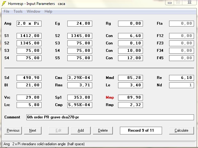

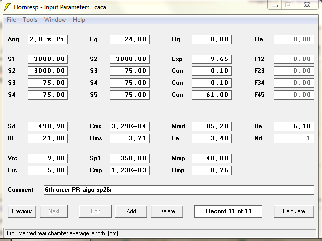

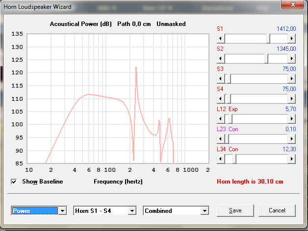

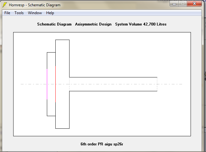

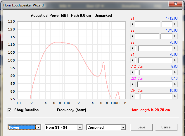

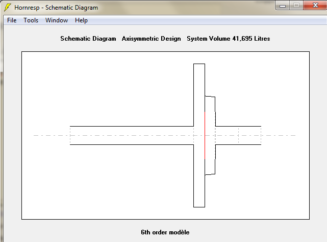

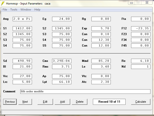

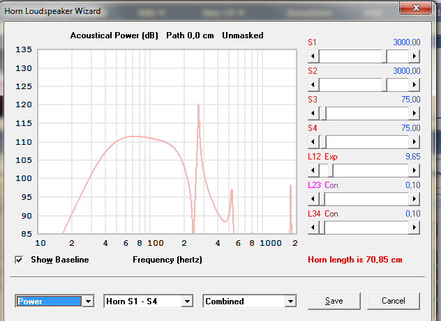

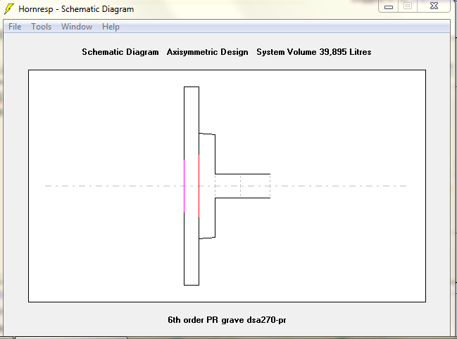

Read help ^^How can you model a PR when there are no "box types" in the software?
First image is my 6th order parrallel bandpass model parameters, using vents, as show in image 2, giving as response the last image (the 8th).
3rd/4th images are the same box, replacing magically the big port with a dayton DSA-270PR, show in pink. Response is the 7th image, wich show less resonnance (of course, there is no more the big port, as expected). But there is still a resonnance at 700hz.
5th/6th images show this time only small port replaced with a lighter PR the SEAS sp26r (not cheap...). Result is the 8th image. No more resonnnance at 700hz, but the big port resonnance come back of course.
So, we can think that with PR on each side, tada ! No resonnances !
The harder part is to find the good passive radiator with all the needed spec, with not too low qms/not too high Rms (suspension loose).
And of course, hornresp allow to add weight to PR, and allow to use multiple PR too. Use help file !

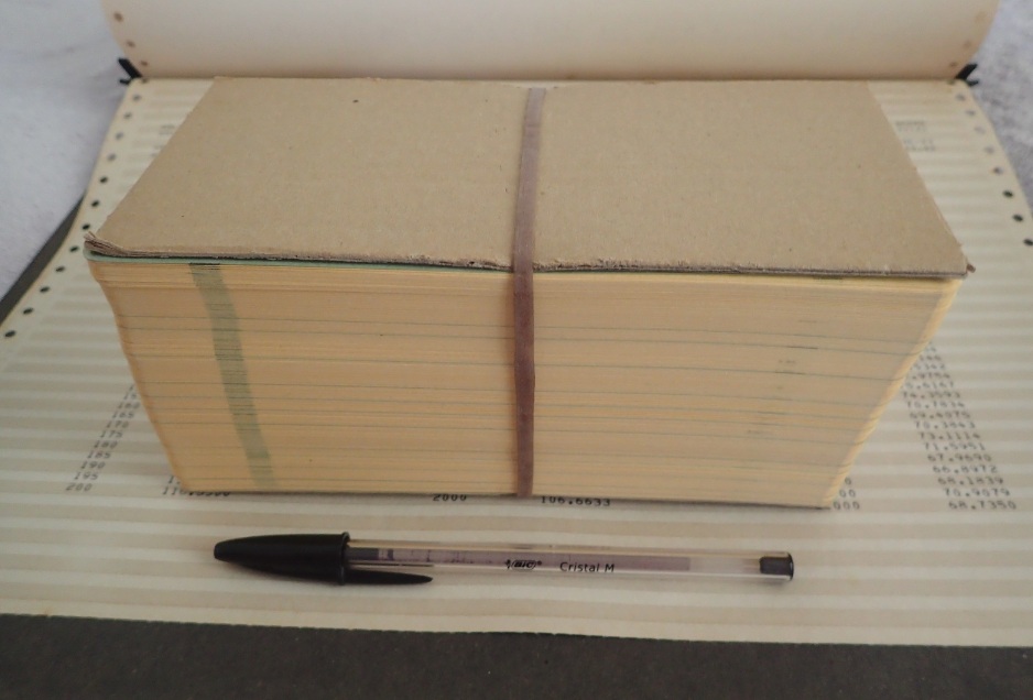

David, can you recall us when did you started working on the roots of hornresp ? ^^
Hi papasteack,
The very first version was written in late 1969 / early 1970 in the Fortran IV programming language.
Attachment 1 shows the original Hornresp "software" (deck of Hollerith 80-column punch cards).
Attachment 2 shows an original Hornresp power response chart.
(Photos were taken early this year).

Read help ^^
