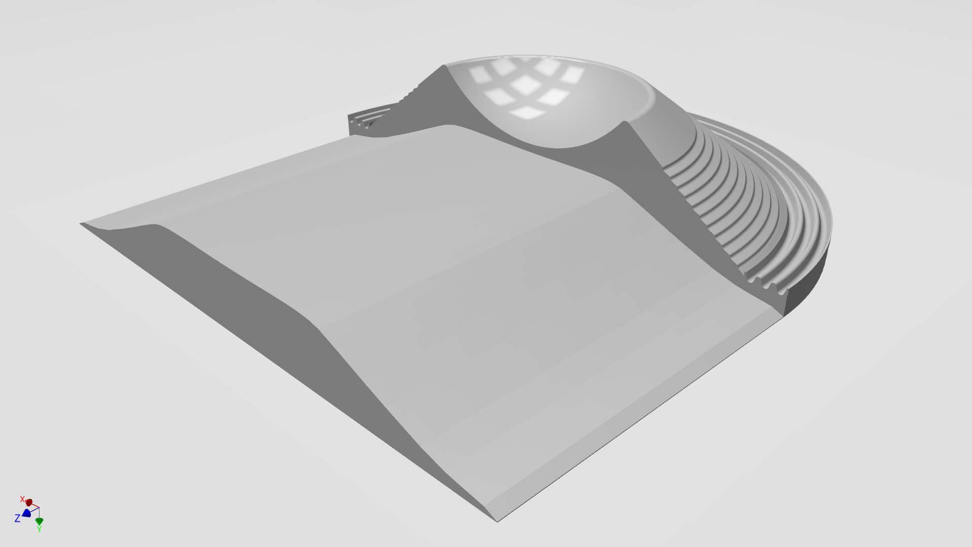

I know that feeling, and since your light is on and mine is not I have an idea 😀
David has a cone volume calculator but we don't have a tool that converts the volume to area in the expansion along the path length, I slice them manually in CAD and divide by the cabinet width so I can get the expansion correct, but I wonder if it's possible to do in excel?

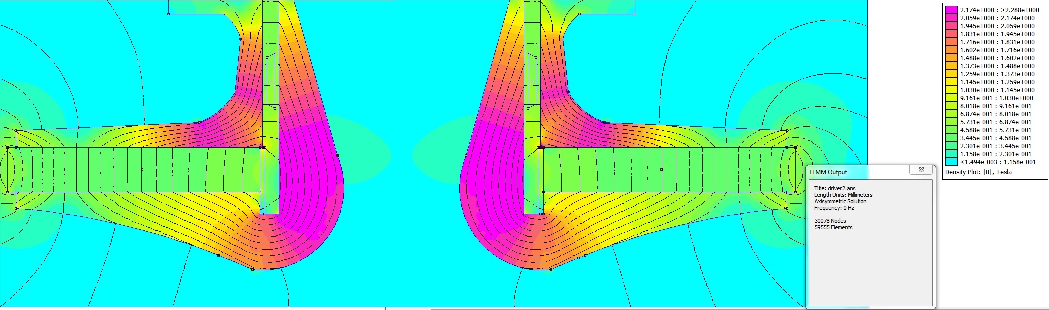

What I know is that the normal travel of this is pretty symmetric, the first 3 to 4mm of plus or minus travel. The forward movement begins to be a little under powered near 8mm one way forward. Really happy going backwards. At 12mm one way forward there is a 35% drop in the B and I'm running into limitations in the surround and spider. Rearward, all happy to be in the flux. Welcome to making design compromises. I generally think about the first 5 to 6mm where 90%+ people will be happy campers. I keep that as clean as a whistle. From thee we get a little bit more dirty. Sims tell me that even at 10mm one way I have a 3% distortion factor from the motor. I'll have to see what the spider and surround add in.
So as you guessed the BL is not perfectly symmetrical. Explanation above.

...and the answer turned out to be super-easy.
I'll describe it tomorrow - time for some shut-eye 🙂

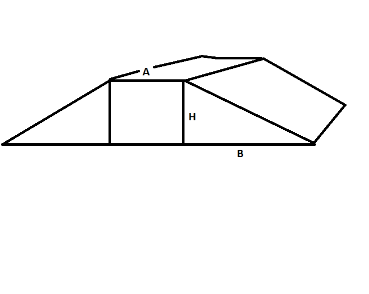

Given
V = Cone volume
R1= Cone radius
R2 = dust cap radius
W = internal cabinet width
H = V/(W*R1)
A=2*R2
B=R1-R2

Wow, that is simple, I wonder how close it gets? I've attached some sample data.
If the value of V is the calculated value from the Hornresp cone volume calculation utility, it should be pretty much exact.

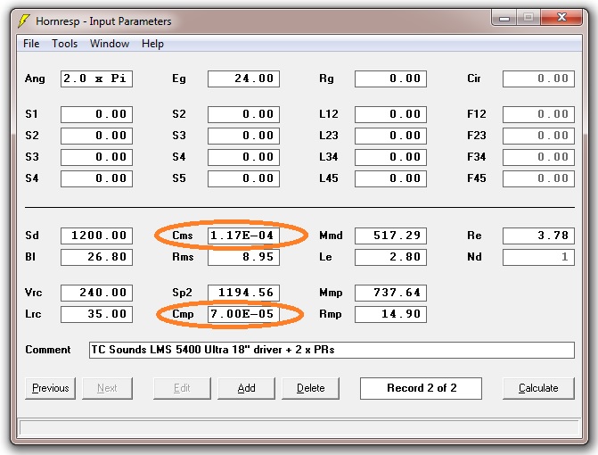

Is there a way to turn off the auto correct in Hornresp, or do you just have to use the wrong parameters to calculate your box?

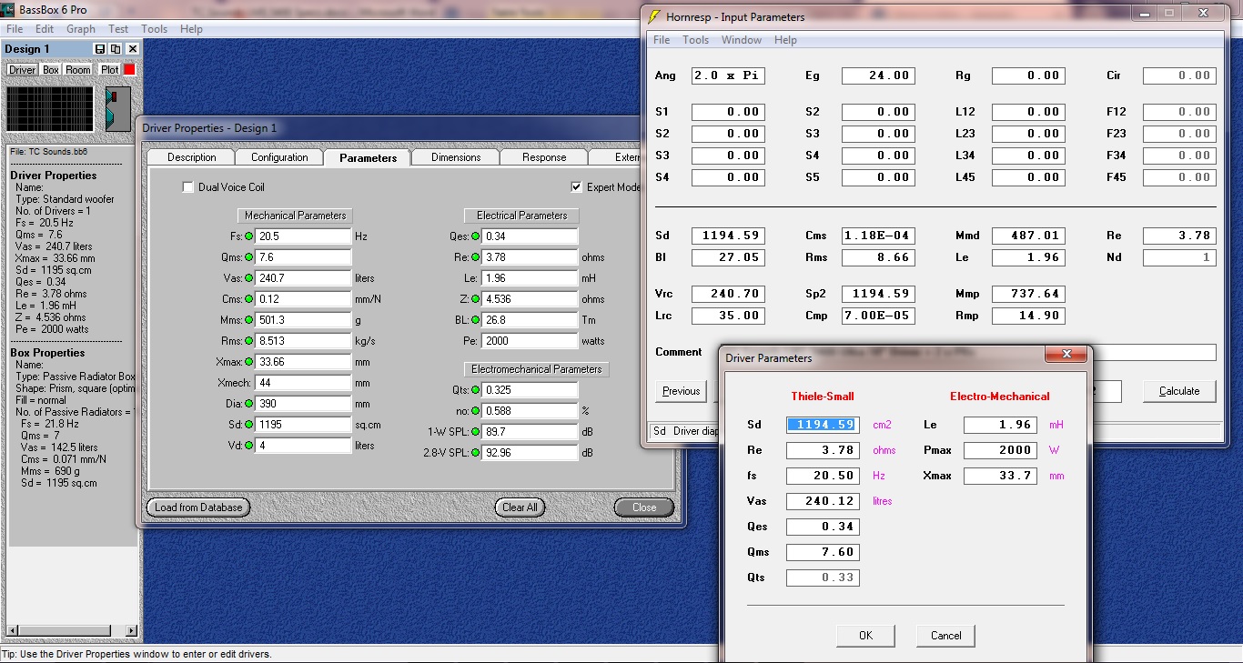

I am entering the TS parameters the manufacturers provided, and I have double checked them in BassBox Pro 6, but Hornresp keeps changing them to the wrong values.
I'm stumped what does everyone else do when you can't enter the right information?

Been thinking about writing a program to calculate this, but wouldn't it depend on the thickness of the front baffle, and if the driver is flush mounted or recessed?
Still doesn't factor in the magnet, frame or spider, but those could be roughly approximated with a bit of math.

OK if you want to enter in the T/S parameters directly you double click on the Sd field and there will be a table to fill out. Don't worry about there being slight differences between what you see and what Hornresp calculates for a few of the numbers. There is a bit of difference in the way the numbers are manipulated between programs.
As an example the Mmd or total moving mass is calculated without the air load on it. Some programs do the opposite.
In short the math in Hornresp is solid. Myself and many other people have used Hornresp for professional design work for years. I calculates things as well as some very expensive programs. And is more versatile than just about any other program I have ever worked with.
Also Hornresp calculates acoustical power at a distance of one meter not SPL at one meter. Some programs differ. But there are ways to reconcile the differences.

If the BassBox Thiele-Small parameter values shown in your example are entered into Hornresp, all values remain the same except for Vas, which changes from 240.7 litres in BassBox to 240.28 litres in Hornresp. The difference is 0.17 percent, which has no material effect on the results.
The very small discrepancy is due to rounding errors introduced when Hornresp converts the entered Thiele-Small parameter values to their electro-mechanical equivalents for use in the simulation models. The electro-mechanical parameter values are converted back to Thiele-Small values when displayed in the Driver Parameters input form.
Xmax is rounded to one decimal place when entered into Hornresp, so the BassBox value of 33.66 mm becomes 33.7 mm, a difference of 0.04 mm, which is not significant.
The Sd values should always be the same - you must have entered a slightly different value in Hornresp to that shown in BassBox.
Just worked out these are real numbers, not some system generated error.
1.17E-04 is 0.000117 expressed in scientific notation. It is the same as 1.17 x 10^-4 or 1.17 / 10000.
Scientific notation is mainly used by physicists and engineers, to express very large or very small values in a more convenient form.
Just to clarify, the total moving mass is given by Mms.
Mms = Mmd + air load
Where Mmd is the dynamic mechanical mass of the driver diaphragm and voice coil.
