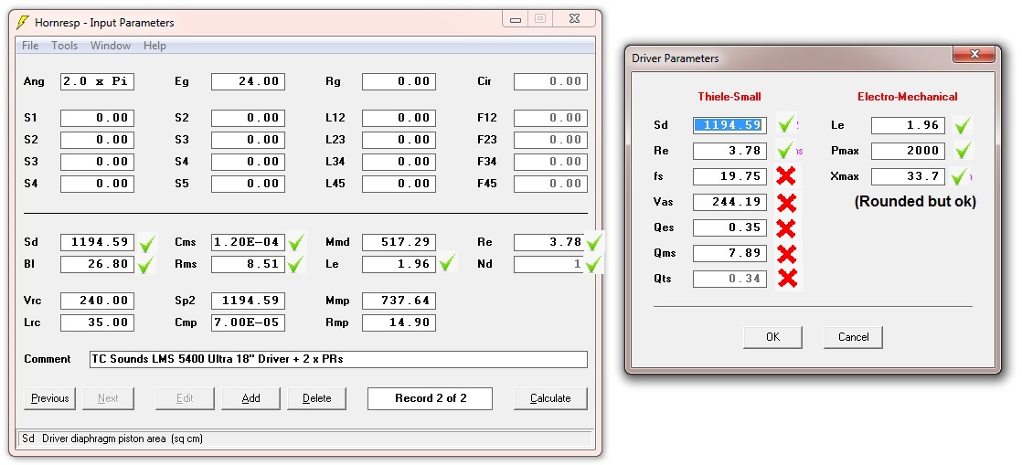

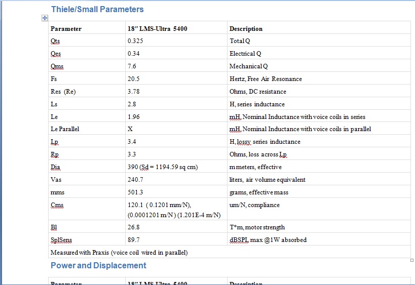

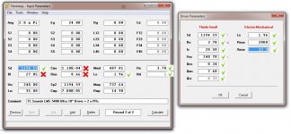

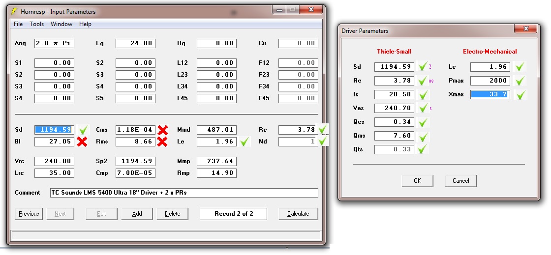

I put all the correct parameters as provided by manufacturer in the txt file and imported it. They showed up fine on the screen at first. Then I clicked the Sd to check the parameters and several of them were wrong (Pic 1)
I corrected them back to what the manufacturer said (VAS was 244.19 instead of 240.7, Fs was 19.75 instead of 20.5 etc. etc) then I pressed ok and the figures on the main screen were wrong. (Pic 2)
I tried to manual correct them but each time I clicked on the Sd and fixed the numbers up again it changed them again. Leaving me with the only real option of leaving them wrong.

There can be several reasons for the differences you see, but it basically comes down to two things: rounding error (the manufacturer's data is of course also rounded, f.ex. Fs is probably not exactly 20.50000Hz, but can range from 20.45 to 20.54), and difference in the sound speed used.
The conversion between the electromechanical parameters that Hornresp uses and TS parameters involves air density and the speed of sound, which both varies with temperature, static pressure and humidity. In some of the conversion equations, sound speed appears squared, so small changes can have noticeable impact. If the manufacturer uses different values for air density and sound speed from Hornresp, there will be a small difference in how the two sets of parameters line up. That does not mean they are "wrong".
It is also important to understand what the parameters actually describe. The electromechanical parameters describe the physical parts of the driver: the physical mass, the stiffness of the suspension, the strength of the motor. TS parameters are derived, and they describe how the driver behaves as a resonant circuit, in terms of resonance frequency and Q values. Vas is in between: it is the volume of air that has the same stiffness as the driver suspension. Since the properties of air changes with temperature etc, Vas will also change with temperature, even if the physical suspension stiffness stays the same. Is Vas now "wrong"?
I base my simulations on the electromechanical parameters, as they are more constant than the derived parameters. As an example, if you change the suspension stiffness a little, all the TS parameters change, because you change Fs (as the mass is unchanged), and the Q-values depend on Fs, so they will change.
It is also important to keep in mind that these parameters are small signal parameters, they change with displacement and heating of the driver: BL and Cms decrease as the cone move away from the rest position, the suspension softens as it is worked, and Re increases when the coil gets hot. But they still give a reasonably good description of the driver performance at low levels.
Parameters will vary within a production batch, and a new driver is stiffer than a used one. Manufacturer's data is a guide, and probably close to the middle of the bell curve, i.e. represents an average driver. But it is good practice to measure the driver parameters if you are comparing an actual build to a simulation.
My point is that the small variations you see between entering electromechanical and TS parameters will be small compared to the variations you will see between different drivers of the same type, and between the driver before and after it has been playing music for a few hours. Driver parameters are not comparable to resistor values or box dimensions, they are not exact and static. If you see large variations in the response with such small variations in driver parameters, the design is too sensitive, and will probably not work in real life.

Your "corrections" are actually rounding errors. If this level of driver parameter precision is your goal trusting in the manufacturers specifications is a bit of folly. Test your drivers T/S parameters and you will have something to rely on. If you are on a budget, REW is a good way to do comprehensive testing that is accurate and cost effective. The software is free. And the test rig is under $10 in cost.

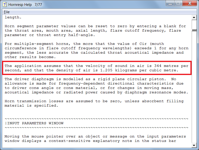

Also things like the speed of sound may not be consistent between what TC Sounds used versus what David used because temperature plays a part in that value.
Wouldn't there be generic values used for things like speed (unless you are offering a option in your code to specify the temp to come up with a derived speed)?

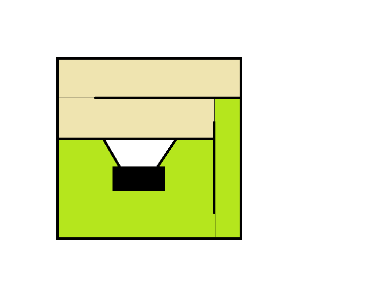

Another possible approach to the BP6S. I think I'll try to build an optimization spreadsheet around this layout this weekend.
I like the elegance of the design. But please tell me that the vents are pipes and not shelf ports. Cuz not so easy to nail a shelf port calculation.
I think David uses 344m/s for c (speed of sound) and 1.205kg/m3 for rho (air density). These are generic values, but I have seen "generic" values for c ranging from 340 to 345m/s, and sometimes rho is rounded to 1.21 or 1.2. There is no "ISO standard sound speed".
Definitely shelf vents, LOL. Hopefuly I've positioned them in a way that makes it a bit easier to fine-tune their length to achieve the target resonance frequencies.
Vents can also be difficult to get right in a bandpass design, if you make the vents large enough for subwoofer duty. Have a look at my project to see what I ran into - The Subwoofer DIY Page - Projects : An INF10 Bandpass Subwoofer

That's great news. I'll definitely start working on that spreadsheet that weekend... 🙂
