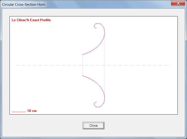

I included the spherical wave horn option in Hornresp after being contacted by Avantgarde Acoustic, who were using the profile in their horn loudspeakers. I didn't worry about mouth roll-back because they didn't to seem to employ it in their designs to any noticeable degree. I do however allow the Hornresp Le Cléac'h horn profile to roll back.

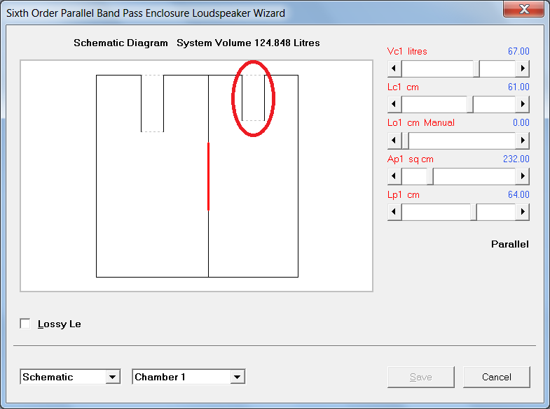

Port tube 2 has been repositioned in the BP6P schematic, as suggested by Brian in Post #8790. Attachment 2 refers.

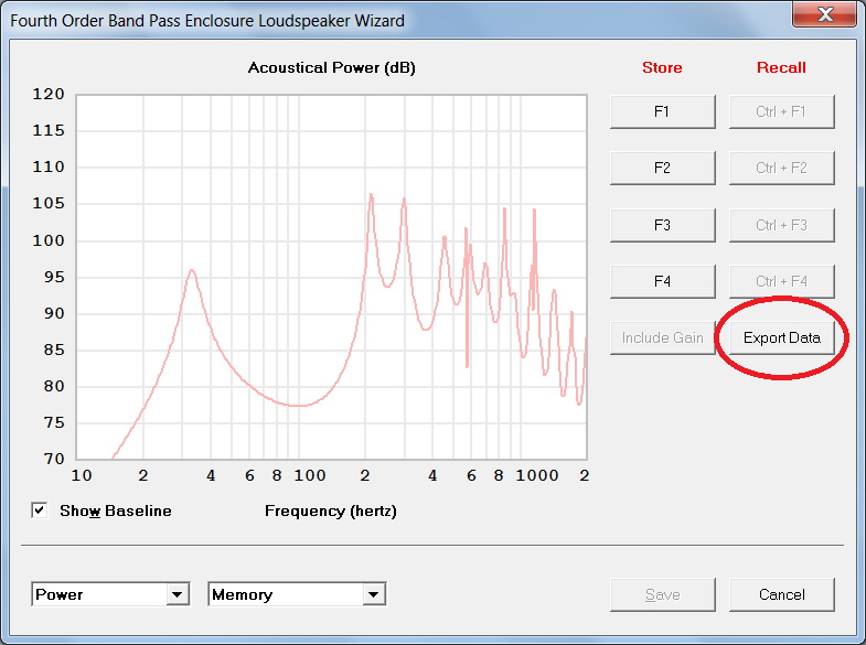

Power response, impedance and displacement data can now be exported from the BP4, BP6S, BP6P, BP8, DBR and ABC loudspeaker wizards. Attachment 3 refers.

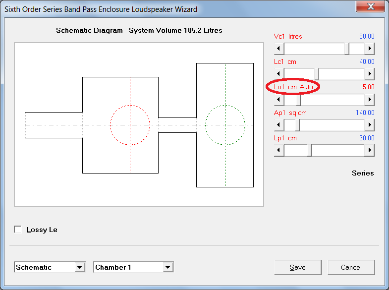

BP4, BP6S and BP6P loudspeakers can now have offset drivers. The offset is specified using the Lo1 and Lo2 sliders. The default Manual setting allows the offset in each chamber to be adjusted individually. The Auto setting makes the offset in each chamber the same. Attachment 4 refers.
