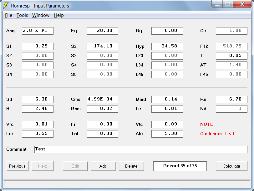

It is interesting that the rescaling method suggested by Bjørn to determine the response below 10Hz can also be used in reverse to find the system suited to the driver you specified.
Procedure:
Step 1 - Use the Resize Wizard tool with a resize factor of 10 to rescale the driver parameters.
Step 2 - Use the System Design With Driver tool to specify the rescaled system.
Step 3 - Divide lengths by 10 ^ 1, areas by 10 ^ 2 and volumes by 10 ^ 3 to find the parameter values for the desired unscaled system.

After Step 3:
System values suited to original unscaled driver are:
S1 = 0.29
S2 = 174.13
L12 (Hyp) = 34.58
T = 0.85
Vrc = 0.00 (actually 2.93 / 1000 = 0.0029, as previously advised)
Lrc = 0.55
Vtc = 0.09
Atc = 5.30
Attachments 1 and 2 refer (Value specified for Vrc is 0.01)

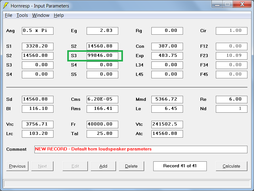

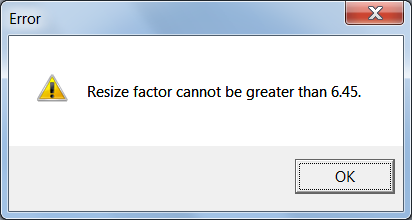

I was not able to figure out the reason for the upper limit on this sim (Resize factor can not be greater than 4.99)
To find the reason for the limit simply enter 4.99 as the resize factor and check the input parameters to see which one is close to its upper limit.
To illustrate - The maximum resize factor for the default record is 6.45. Entering this value shows that the resized value of S3 is 99846.00, just below the permitted limit of 99999.99.

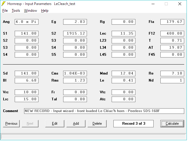

Hello David,
First, thank you so much for offering this elaborate tool, and such curteous & excellent support to go with it!
I have started using hornresp only recently, and I happened to notice that with a Le Cleac'h profile, if S2 is increased to where Fta goes past 90 degs, then the power response curve starts showing progressively higher values as Fta increases, reaching 9 dB increase at Fta = 180 degs (relative to Fta = 90 degs). This rise covers the whole freq spectrum below Fs, and the acoustical impedance curves show a similar trend. How should I interpret these results? (images & hornresp import txt record below)
I also have a question concerning exporting the Le Cleac'h profile for a rectangular horn while choosing conical width expansion. It seems that the height profile is simply computed from the equivalent Le Cleac'h axisymmetric horn, dividing the sectional area at each point along the central axis by the linearly expanding width to obtain the height at that point. If this is indeed the case, then I wonder if this reshape operation happens to preserve the original assumptions of equidistance of the successive wavefronts and their perpendicularity to the walls of the horn, or is it simply a good approximation?

Hi Amir,
Under certain conditions (and particularly in the case of relatively short horns with reasonably large throats) the Hornresp Le Cléac'h horn isophase wavefront simulation model tends to over-emphasize the effect of increasing the mouth flare tangent angle Fta beyond 90 degrees. For your 180 degree horn example, I would expect the actual performance to lie somewhere between the 90 and 180 degree predicted responses shown in your chart screenprint attachment. While the Hornresp model is not perfect, a more rigorous finite element analysis approach would take a relatively long time to produce results that are currently provided in a matter of seconds.
Correct.
It is simply an approximation. The most accurate Le Cléac'h horn to build is an axisymmetric one, using the Hornresp 'Exact Profile' option.
