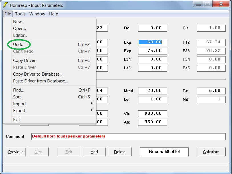

Coding changes made when the Resize Wizard tool was added inadvertently disabled some of the functionality in the Undo / Redo feature. Details of the action being undone / redone were no longer shown. This functionality has now been restored. Attachments 1 and 2 refer.
CHANGE 1
While working on fixing the above bug the opportunity was also taken to further refine and improve the operation of the Undo / Redo feature.

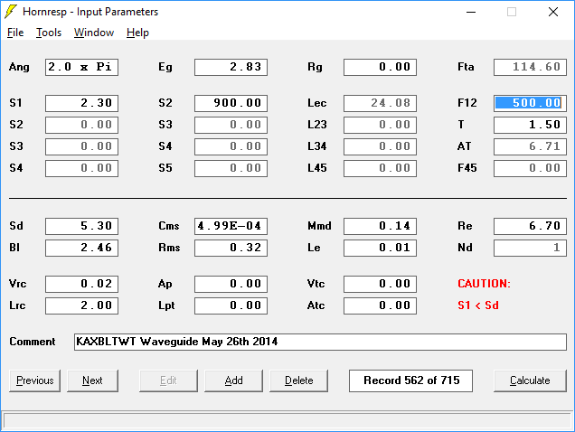

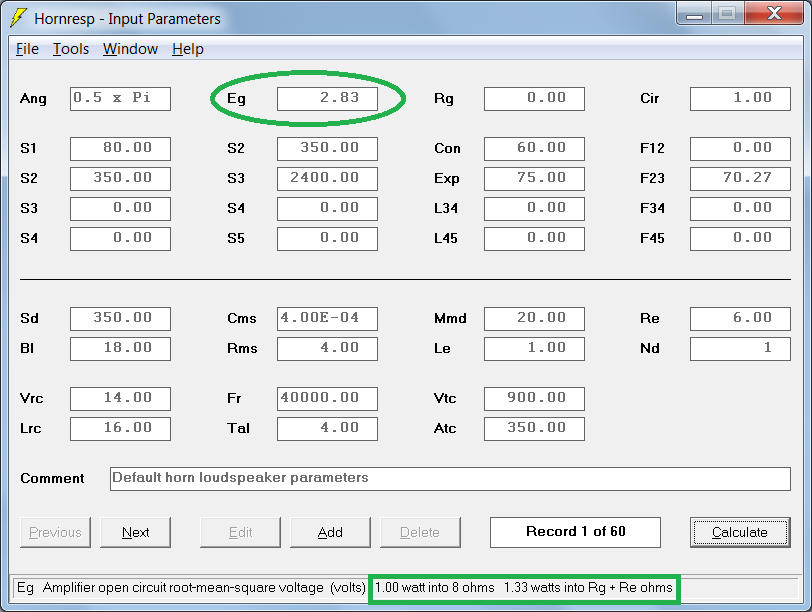

Moving the mouse pointer over the Eg label or text box now shows the power delivered to a nominal 8 ohm load, and also to Rg + Re. The power values are displayed in the status bar panel at the bottom of the Input Parameters window. Attachment 3 refers.

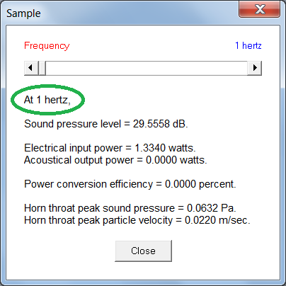

I like that. I like that a lot. It's only a couple extra clicks to get to the driver power window (which also shows more info) but this is really helpful for a quick look at watts.

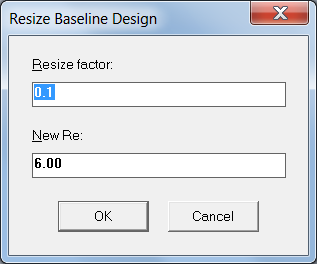

Or to use the new Resize tool to scale the design down by a factor of 10, so that 10Hz will equal 1Hz in the original design.
Brilliant - thanks Bjørn!
Using this technique would then also allow the user to sample down to an effective frequency of 0.1Hz, if so desired. This should be low enough for anyone 🙂.
(To scale the design down by a factor of 10, use a 'Resize factor' of 0.1 as shown in the attachment).

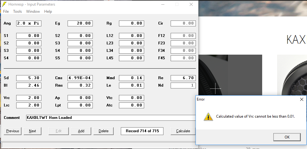

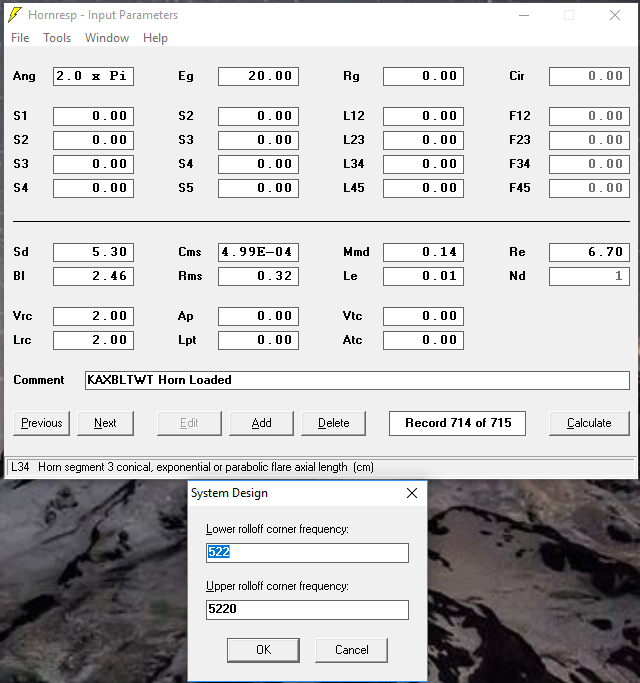

Maybe a bug?

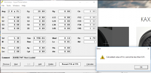

Hello David. I may have discovered a bug.
Just installed the latest version of the software and I had a small Vrc of 0.01cm^3. I changed it to 2000 cm^3.
Then I setup to use the design with driver for a horn I get this warning:
I saved the file and restarted Hornresp. The Vrc was then changed to 100cm^3 To big for a dome tweeter but still within the parameters in the prompt.
Hi Mark,
Strictly speaking it's not a bug, but rather a limitation on the input values acceptable to Hornresp. The actual calculated value for Vrc using the given input parameter values is 0.0029 litres. When formatted to two decimal places the value rounds to 0.00, which is why the error message is triggered. To get around the problem, in the next update if the calculated value of Vrc is less than 0.01 it will be automatically set to 0.01. The difference between the 0.01 value used and the actual smaller original calculated value will have a negligible effect on the overall results.

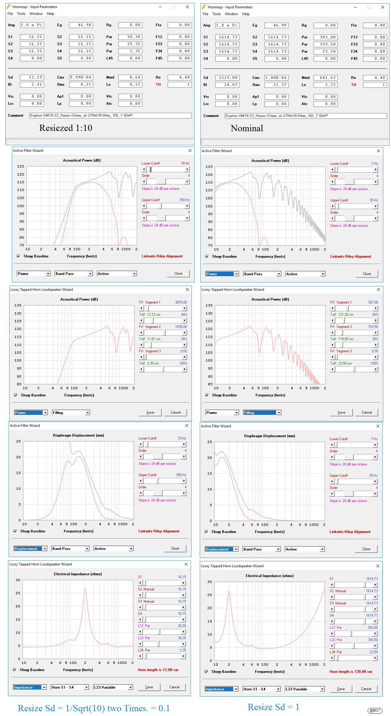

I can do it and have done it before.
It's very easy to use the resize wizard to scale everything so there's no low frequency limit in the sims. There are just a few things to look out for.
There can't be any parameter that can't be divided by the resize factor. So if you have L12=0.01 cm and you resize it to 0.1 (10x smaller) the sim cannot run. In the following sim you see I've had to change one parameter to 1 cm because the sim would not run when it was 0.01 cm.
This is a random resizing example. The original inputs and schematic are on top, the resized version below, sized to 10x "smaller".
I've been saying smaller but meaning 10x lower frequency response, this is much more correct.
A lot of relationships between the original and the resized version are readily evident. These relationships are all related to a specific scaling factor, in this example the scaling factor is 0.1x the original frequency response.
The resized enclosure is 1000x smaller by volume.
All enclosure and driver dimensions are scaled such that the shapes are exactly the same.
All segment areas (S1 etc) are 100x smaller in the resized version.
All length measurements (L12 etc) are 10x smaller in the resized version.
Sd is 100x less in the resized version.
Cms is one order of magnitude smaller in the resized version.
Mms is 1000x smaller in the resized version.
Bl is 10x less in the resized version and ...
Rms is 100x less in the resized version.
Driver xmax is equal in both versions.
So we know exactly how everything is being scaled and knowing that we could do it manually if desired.
Congrats to Bjorn for knowing these relationships and scaling formulas, this is a useful little tool.
There's a few other very important things to note too.
As the next image shows the frequency response and excursion are exactly the same but shifted down by 10x.
Velocity is 10x higher in the resized version.
Group delay is 10x less in the resized version.
Diaphragm pressure is 10x higher in the resized version.
And that's all the comparisons I've thought to make at this time.
So all you have to do to simulate frequencies below 10 hz, and assuming 1 hz is a reasonable low limit, is start with a design (use the t/s of the driver you actually want to use) and resize your design to 0.1 in the resize wizard. Now 10 hz on the graph = 1 hz, 100 hz =1 khz, etc.
Open your design in the Loudspeaker Wizard and now you can play with it below 10 hz, in this example I've taken the original design and resized it and tuned it down to 6 hz.
Just remember when looking through the graphs you need to know the sizing formula relationships and make sure you realize that stuff like velocity, group delay and other things are off by a factor of the scaling factor.
When you are done (or anytime really) you can resize it back up to it's original size. There's no need to do this as long as you understand the resizing formula relationships but it's there if you need it.
