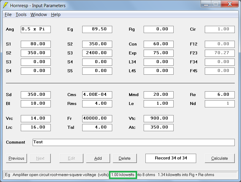

Hi Everyone,
MINOR BUG FIX
One thousand watts delivered by voltage Eg was being shown as 1.00 kilowatts (plural) rather than 1.00 kilowatt (singular). This has now been fixed.

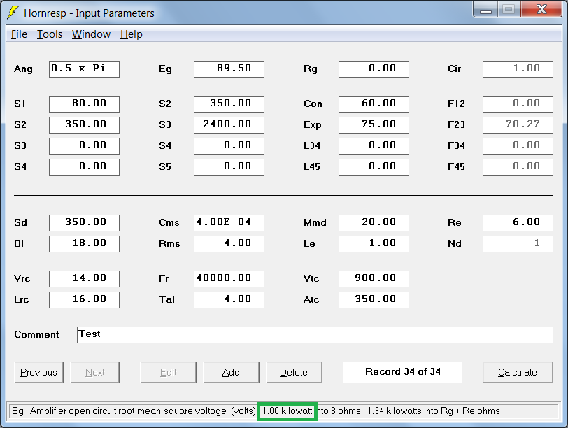

Hi Everyone,
MINOR BUG FIX

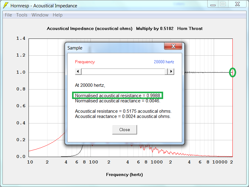

Please put legends for the various lines on the graph. Eg. in the impedance window, there is a black line and a red line. What do these stand for?
The black trace is the normalised acoustical resistance and the red trace is the normalised acoustical reactance at the horn throat. If you are not sure which is which, then use the Sample tool to identify the levels as shown in Attachment 1.

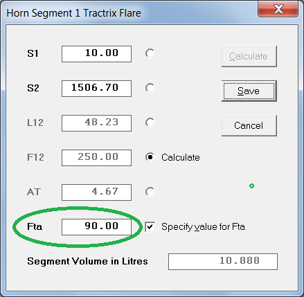

How can I specify the angle at the mouth of a horn/ horn segment?
Use the Horn Segment Wizard tool - see the tractrix horn example in Attachment 2.
Note that for exponential and hyperbolic-exponential horns the mouth circumference in cutoff wavelengths is given, rather than the mouth flare tangent angle.
Sorry for unloading all this on you.
You will finds things start to become clearer the more that you play with Hornresp, and the more you study the Help file.
